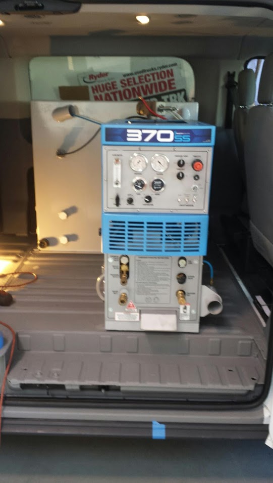

#20... SS370 build

What's next to the solution reels a spare tire? Looks like plenty of head room! I'm driving a 05' and 06' 250 and 350, so I'm not picking on it by any means.. lol

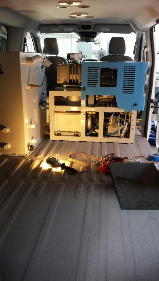

You will love it. This video was from July. @ 220 the exhaust diverter opens. You can hear it and know when it is time to get some water moving. It stays at 220 even with the diverter open if you are not moving water.
It doesn't dump any water into the recovery tank.
If you run it on medium heat it stays around 195. If you're really hammering it it could drop to 170 but it is still HOT and it builds heat fast. That is 6 flow Prochem Quad. My SS jets are ready to be replaced 1 year old. No glide cleans good.
Prochem stair tool stays around 220 same with SS upholstery pro. HF wide open stays around 190-195 after it is all warmed up and doing it's thing. Mine is running @ 2960 RPM. If you are doing big jobs get the APO. That is what I did.

If you have a good APO, you do not need much of a waste tank, so that in itself saves a ton of space and all-day weight.
A small waste tank also increases vacuum rise time when cleaning.
I spent years tending to emptying a waste tank during cleaning all day. I no longer have to stop on any cleaning job to dump a tank so I can continue cleaning.
What a relief!

Glad you're nixing the submount tank, the design is stupid IMO, you loose more usable floor space with them.
What they NEED to do, is put the 370 on the Pro1200 Waste tank, THAT would free up a ton of room.
I asked them about that and they shot me down, that was a while ago though.

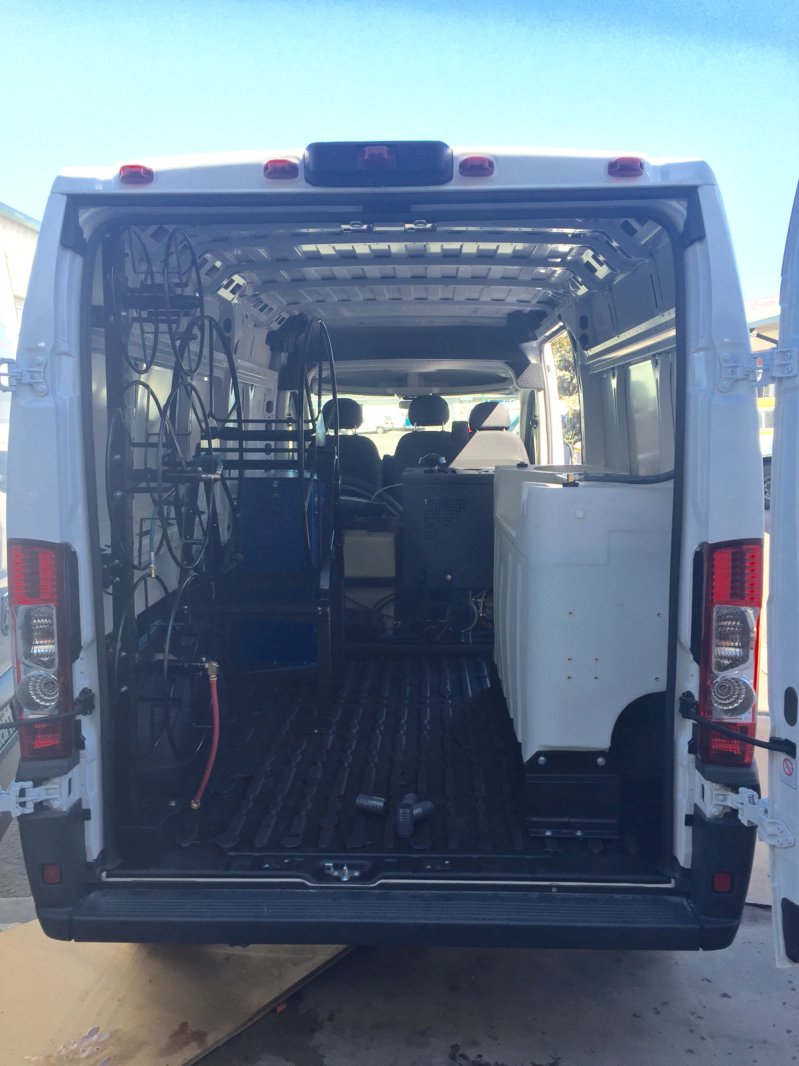

I bet John's custom machine would make an L shaped plastic
water tank that would be roughly 90 gallon for a small machine to sit on.
One just like the pro1200 waste tank

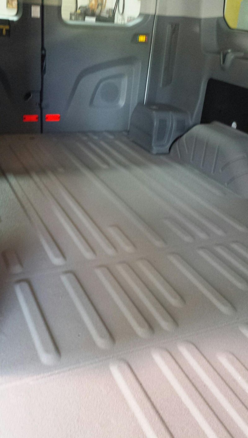

Looks good. What did that cost if you don't mind me asking.
Did they remove the heater and get under?
That was a hookup price for sure. You better give ray a kiss.
How thick did they lay it on?

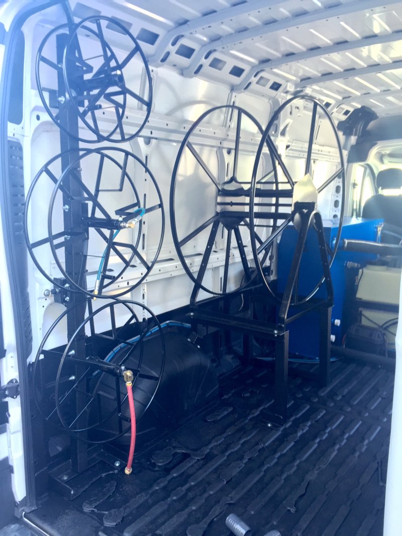

There is lots of room to run the hoses out the back if you know what your doing. :) As far as hose reels a Rokan Reel will out live the truckmount as long as you don't put a Stack Bracket on it. The stands you see pictured are $175 the cost difference for the van versus the trailer is 15 bucks or so in material so we just kept the price the same. They are lined by Utah Custom Lining :) P.S. The vacuum stand is considerably more as they are always custom build to the vacuum reel and the vehicle. The Water tank brackets are $149

Not sure if they explained the price difference in color but it isn't the color that cost more its the loss that your paying for. You lose 2-3 gallons of product switching between colors. Price wise it was extremely fair I am sure Ray saved you a couple bucks normally it would have been $100-$200 more so be sure and send him to a really nice restaurant.
