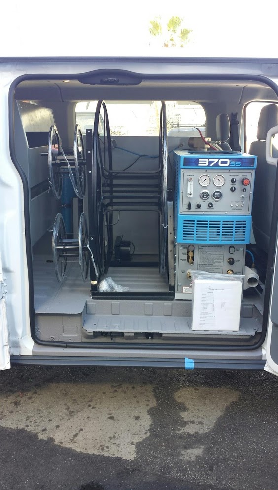

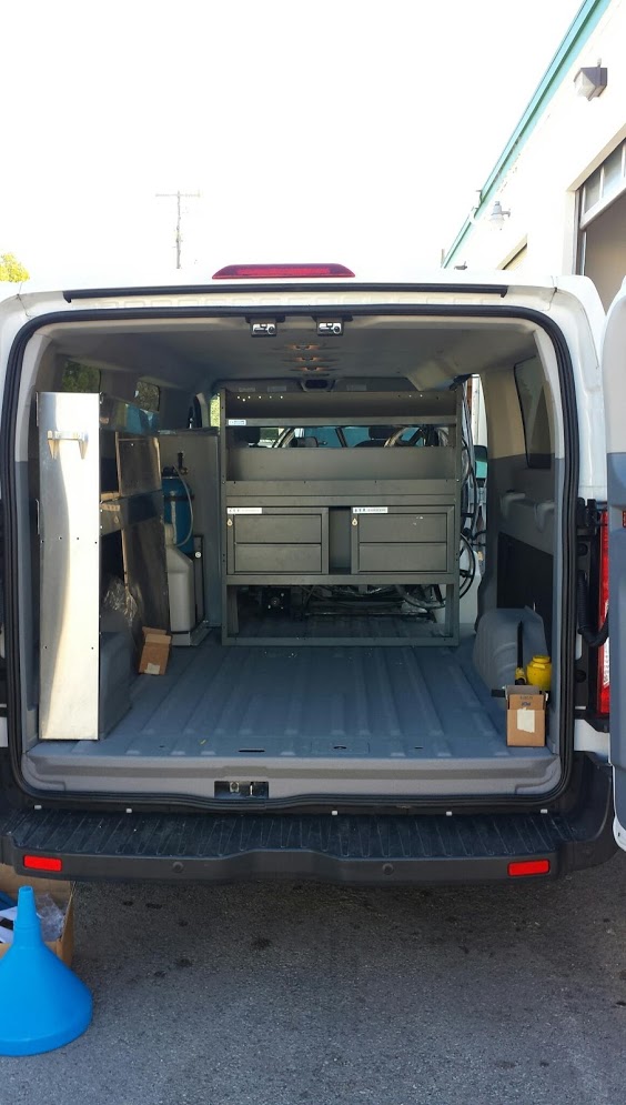

And before anyone else asks the blobs you see on the floor are glue. The Dodge had a composite floor glued to it with gaps that would have let water down under and get trapped. When we pulled it those globs where everywhere and an extreme pain in the ass to remove. Being that poly sticks to poly the customer said just spray over it. My spray shop manager hated these pictures and didn't really want to show them but the racks are bad ass :)

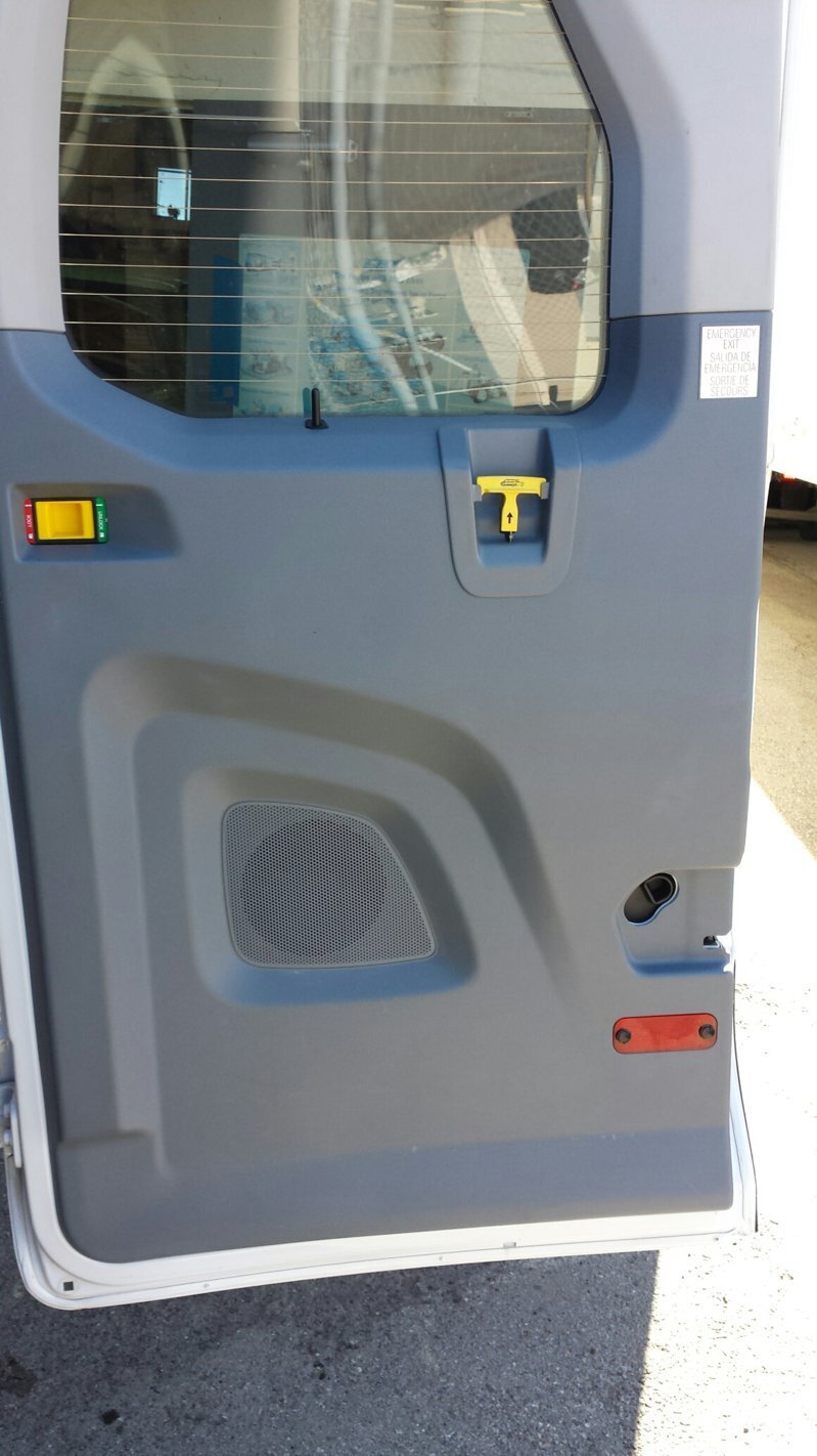

Mike sea if you can bolt plywood to rear door for live waterhose reel.
I love mine with custom 100ft hose on $25 harbour freight reel.

the shelf straight back looks awesome.
who, where, how to get one, how much?

Which fancy door should we put the reel on?

How is that hose reel going to make your oil changes? I almost wish I would have nixed the submountt on mine and put my hose reel there. But I like the reel out the back too.
