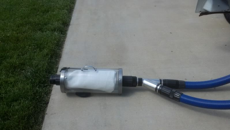

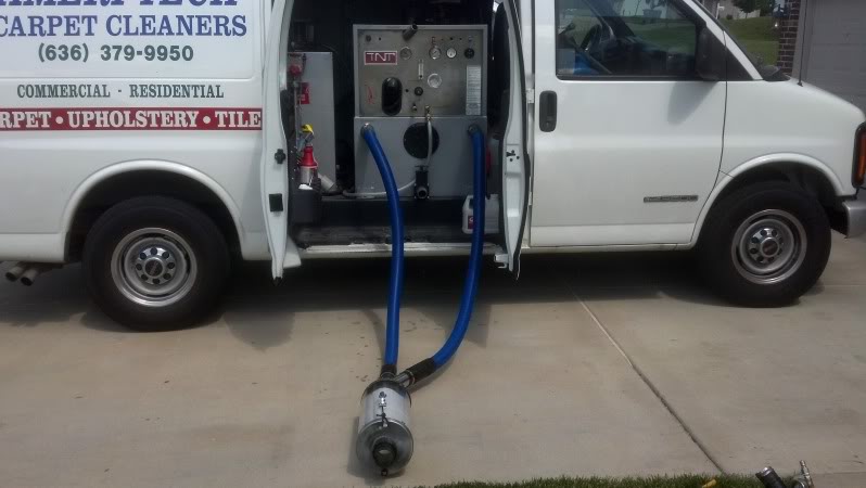

May 10, 2012 #1 V vincent Member Joined Oct 6, 2006 Messages 1,899 Location O'Fallon, MO Name Vincent Sapp Hoses to the tank are 2 inches coupled to the "Y" then 2.5 into the filter. 2.5 going to the house with 2 inch inside home.
May 10, 2012 #2 Chris A Member Joined Sep 25, 2007 Messages 5,475 Location OH Name Chris Who made the filter?
May 10, 2012 #3 RGH269 Member Joined Mar 1, 2010 Messages 226 Location North Carolina Name Bobby Hales That's Bristor's new filter
May 10, 2012 #4 V vincent Member Joined Oct 6, 2006 Messages 1,899 Location O'Fallon, MO Name Vincent Sapp Chris Adkins said: Who made the filter? Click to expand... Joe Bristor

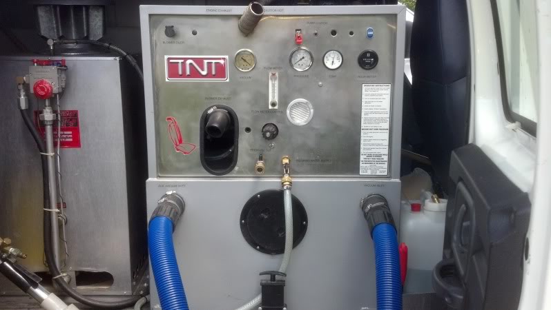

May 13, 2012 #7 Lee Stockwell FOJL Joined Oct 7, 2006 Messages 18,838 Location Benton KY USA Name Lee Stockwell What's the angled pipe top center?
May 13, 2012 #8 C clean one Member Joined Mar 7, 2007 Messages 233 Why not use 2 of those filters? I run 2 - 2" hoses out to two filters to a Y to my main hose
May 13, 2012 #9 V vincent Member Joined Oct 6, 2006 Messages 1,899 Location O'Fallon, MO Name Vincent Sapp Lee Stockwell said: What's the angled pipe top center? Click to expand... engine exhaust.
