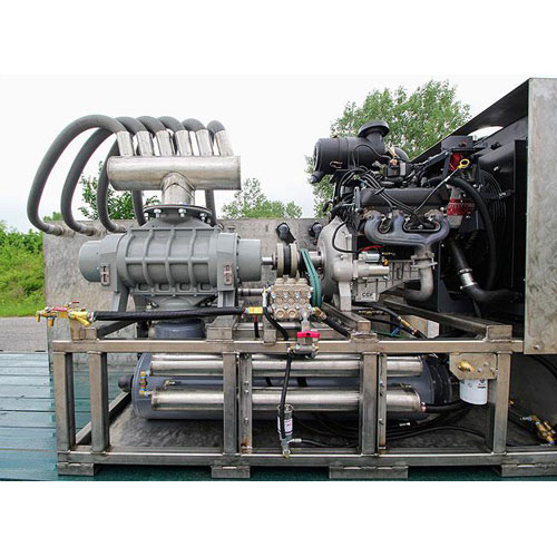

4 Plus Wand Unit
• 120 HP GM water cooled engine, 2-year warranty*
• 5518 water cooled Tuthill blower, 18-20″ max HG, 1950 max CFM, 2-year warranty*
• 10.8 GPM, 2000 PSI GP Emperor series, 5-year warranty*
• 3 heavy duty exhaust heat exchangers, 10-year warranty**
• One heavy duty coolant heat exchanger, 10-year warranty**
• Final stage chemical injector
Comes Standard with 200-gal. Recovery Tank
Comes Standard with 200-gal. Fresh Water Tank
