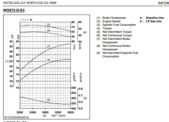

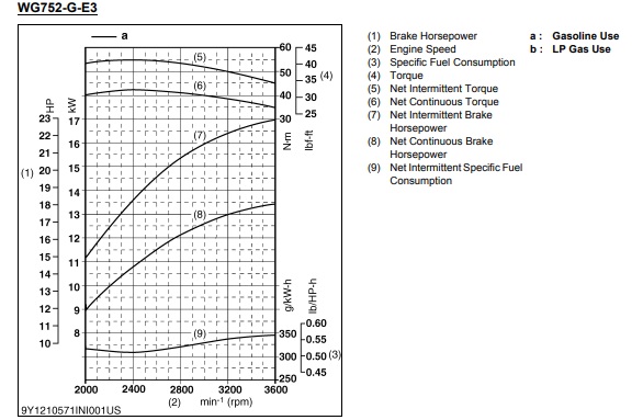

Just looking it up. The 570 uses the wg972. Almost 1 liter. So that is the issue. Not enough power for the 47 blower. Too bad, it would be a great competitor for all the other ones. Doesn't seem like much of a difference but I guess it is.Not sure. I guess I am assuming it would be that same engine as the SS 570 or similar.
