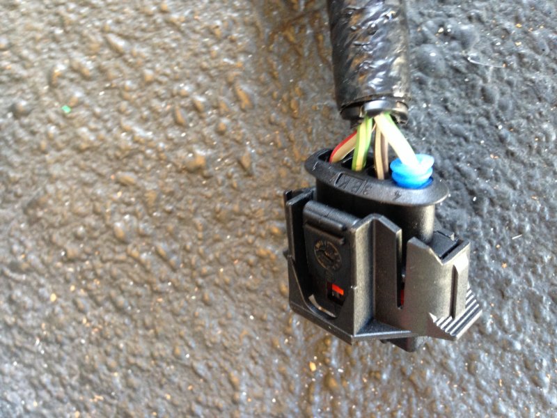

All done for tonight. Unfortunately I'm still at square one but I have a lot of valuable knowledge. Tomorrows a new day. I cleared the codes and will check them tomorrow.

Halwin switch is bad. I cant see any other problem. You cant just unplug it. The machine won't turn over. It connects a circuit. I installed a good one. I did unstick the little reed but it didn't last.
Gene
you installed a " good one "....was it a new one....
explane the " little Reed " thing to me....
and what do you mean it did not last...is the float switch still broke....?

Fixed. Yep all fixed. For those that don't know or care I am a follower of Jesus Christ. We always pray before going to bed. Last night I included that he please show me the problem. When I woke up I knew exactly where to look. I opened the fuel box and immediately saw the blue connector. It wasn't pushed in correctly. I know some reading will think I probably pulled on it but it's fed through a 2" PVC conduit and it's about 5' longer than necessary. I am ridiculously meticulous and careful. The tape is wrapped two close to the plug and pulls on the wires. The opposite side is also trying to come out.
I really want to thank sapphire for taking the time to care. If nothing else I know how to completely diagnose this machine. Also code 17 which isn't in the book is a wire not connected.

Jim I tapped on the body and then the micro switch started working. You could hear the click which is what gave it away initial. I did confirm with a meter. It didn't last but two throws and then it stopped again. It wouldn't matter anyway because it was stuck closed. Wouldn't mater until the tank filled anyways. Pretty sure the harmonics of this machine cause a problem for these switches and harwil made some changes. Anyway yes I put in a new one because it was just faster.

Stupid Harwil switch works intermitantly. You can lightly tap it and it stops or starts agin. I had one like this before that would suddenly fail. Easier to just replace it. I'm not even going to bother to take it apart.
I ran it on high heat, medium speed, with one zipper attached and maintained 195. My thermal wave held 220. I attached two zippers and it held at 170, my thermal wave, barely 140. I was expecting much better heat. Nothing is bypassing. All the fittings that go to the tank are cool. They show a video using two spinners with much higher pressure holding better heat. The recovery is almost instant, but so is the temperature drop. Something is off there.
The check engine light came on after 30 minutes, running it at high heat and high temp, with two zippers attached. Water started pouring out the radiator fitting for the thermal well and ran for about 5 minutes until I pulled and reconnected the garden hose. That was the second or third time that it did that. Luckily I drilled a hole and ran it underneath. Something's going on. The light went off after I slowed the speed to medium. It idled rough after that, and I thought it was going to die. It never did. I don't know if it stored a code. It's to slow to check, and it's blazing outside!!! I'll add a permanent switch so I can check codes easily.
For those that keep saying where's your supplier he was always there. He even offered to meet today Sunday at 2. However, nobody except someone like Jim Martin could do a better job than I would. I'm very meticulous. I cleaned out under the machine spotless. Then I cleaned the walls. Every thing got measured, placed, and every bolt got polyurethaned. I'm far to finicky to let someone else do it. I know the distrubitors don't like to hear it but I probably have more knowledge than most that are installing their machines. I used to build custom furniture and that definitely caries over.
I don't blame anybody about the plug. There is no pressure on it, at all, but when you put the fuel box together you have to bend the wire over. There's no choice. I have a big loop inside, before the wire feeds out. I made it so it pulls the least possible. The shield and tape are to close to the plug, and that causes extra pressure on the wire. When they ran it at Sapphire, the guy might have pulled on the wire, instead of the plug, to disconnect it. And, that was all it took. It shouldn't come out that easy.
