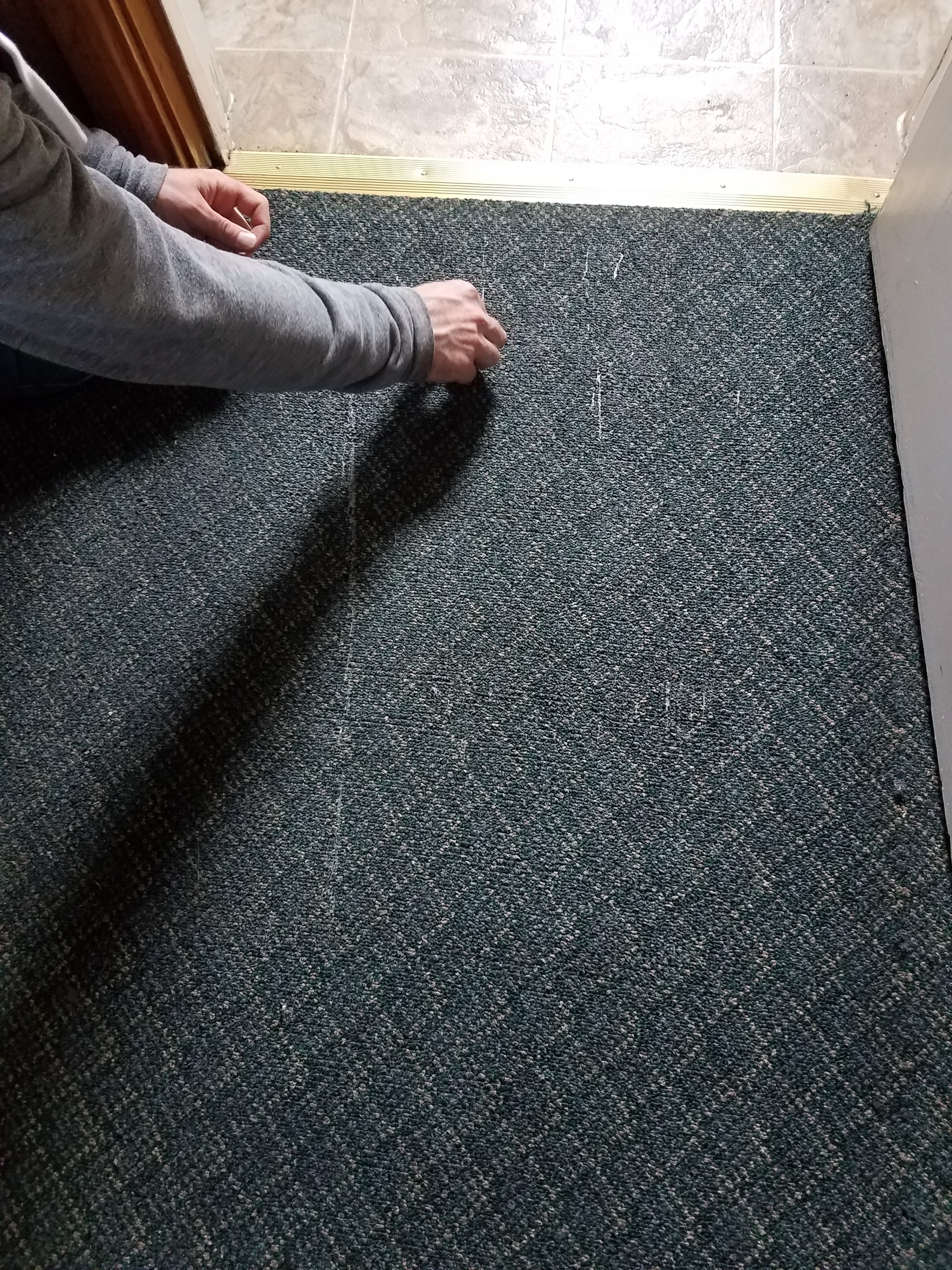

Sorry man! 3x3 areas in front of bathroom, by the door entrance, and by a desk. Low pile carpet. The carpet was fairly new. This picture does not do this problem justice it's so much worse. Those white streaks are glue.

Goomer said it best in the least amount of words
light application of solvents, scrub, rinse, repeat, repeat, repeat
Take if off in "layers" with citrus terpenes is safest
and I'd still pre-qualify them to the difficulty of 100% removal (without delamination or fiber distortion damage to carpet) and possibility of rapid resoil is real
