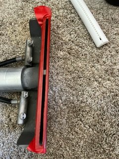

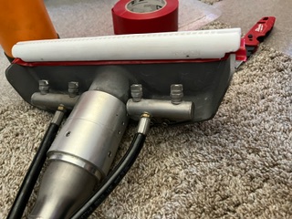

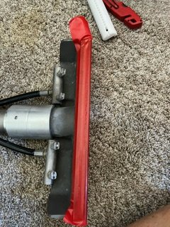

I started over and plugged the vacuum off at the tank and set the relief just above 15". I added teflon tape to the hose threads and the flash cuffs are able to hit above 14" with about 90' of hose in the sizes I stated earlier that I run. I hooked the wand up on the carpet and was only getting 12" and did not have good suction on the carpet. I made a gasket with plastic waterproof tape and am now well above 13" with great suction (carpet pulls away from the pad when I lift on the wand)
I am going to set the relief valve to open at or a hair shy of 15" and should be good to go. The gasket also stops the glide slide and if it does not hold up I will have to be a goober
