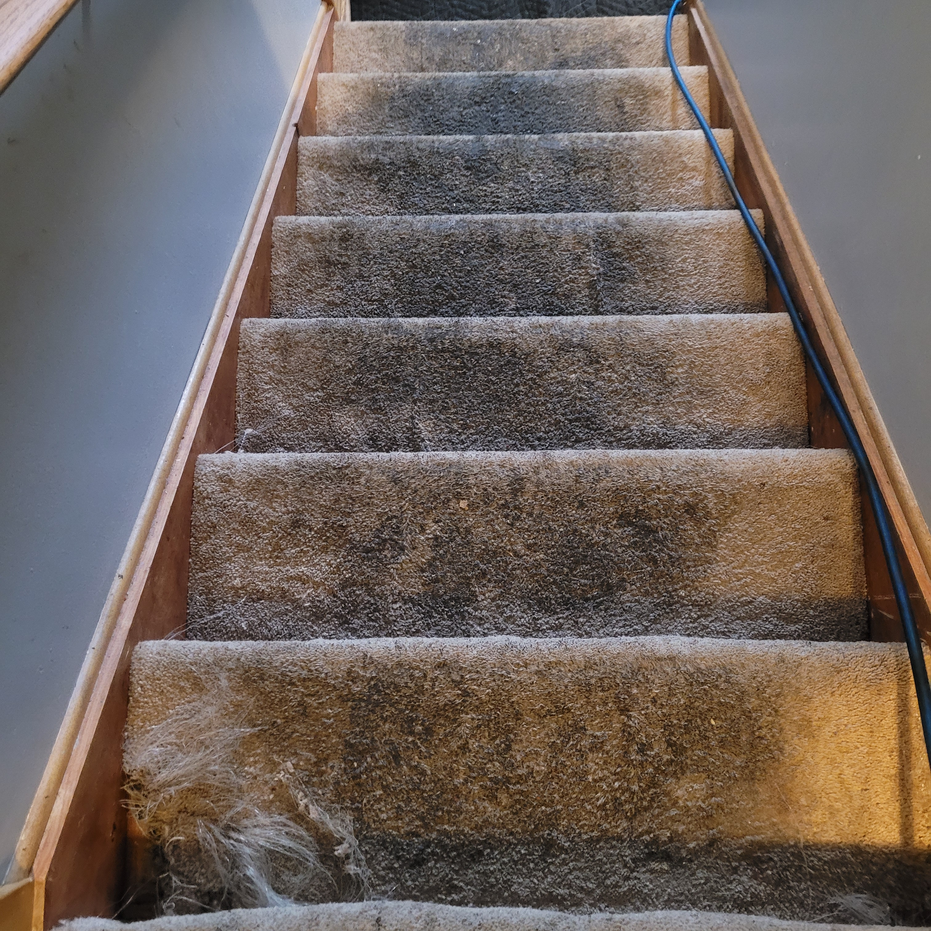

We're not proud of jobs like this, but #10 flow made it happen faster with less effort. I want to encourage you to stay away from jobs like this. If you're going to experiment, get yourself a 25-foot section of 3/8" pressure line and witness the power of rinse with less Psi.

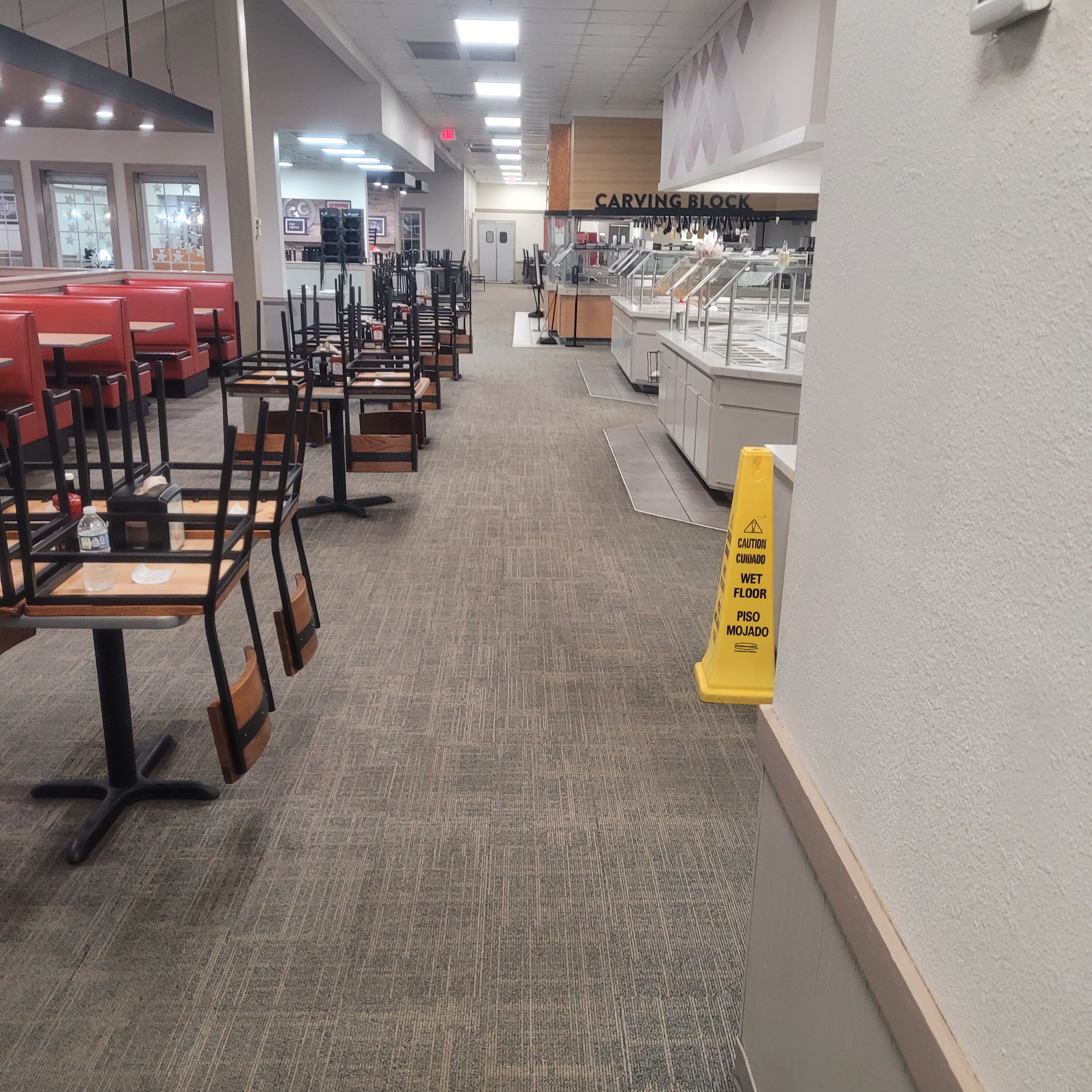

You've been here once or twice, spoken like a true American. I use 2-4 jet wands. I have a Prochem quad with 01 jets that I use in the shop for certain rugs. Never clogs because I have a filter before the trigger valve. I have several 4 jet wands where I use .15 jets for a 6 flow. You can use whatever you want but it's pretty obvious to most people that the more water you use, the longer things will take to dry.
I really meant once or twice. I visited friends from Europe in Hamilton.
I thought we weren't discussing clogging problems from the flow direction ( lint and such). We all learned early on to have sets of filters
( at QD and the jets) . I'm more concerned about clogging the jets because of the debris flying from the carpet. That's when jets with 01 openings are vulnerable. Even though I have three wands on any job, I'm not playing mechanic while hitting 10 K sqft.
When you have trouble to see from one end of the restaurant to the other , than you realize that two jet wand or #6 flow isn't sufficient.

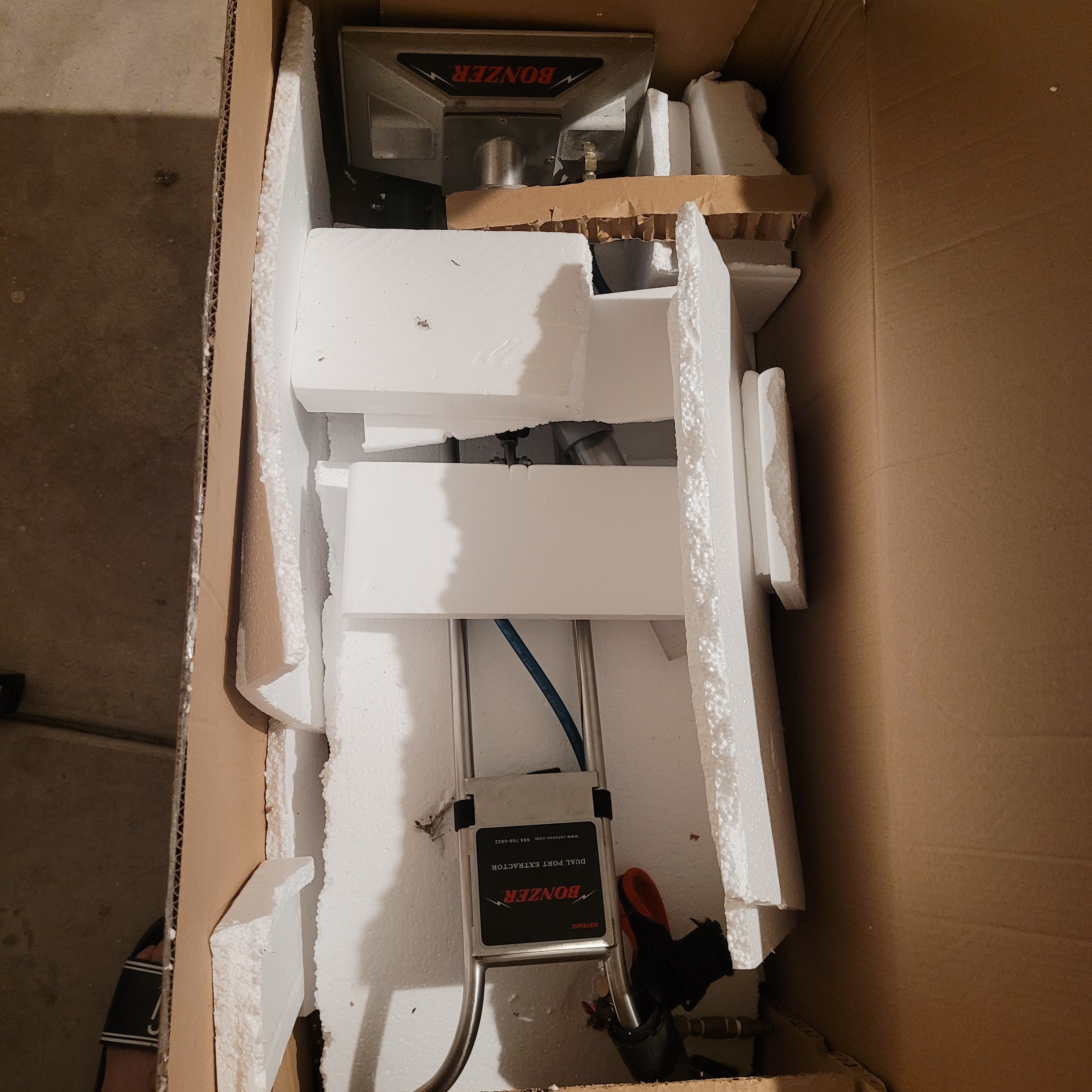

It would be pointless to continue this debate since I have 20 commercial accounts, and you don't ( I assume that based on your eloquently framed response)
I can use the Zipper or something similar in the open, but I must dance around tables and booths. With Zipper, it's not possible.
Here's a packed up Bonzer ready to ship to Canada or worldwide .

Is this available?

Thanks for response. Is this swivel, or not?
Cheers
No, it's not swivel. It's the one with seven jets( you can close two opposing jets)everything else is similar; 2" tube, front and rear glide. I just want to point out that specs state 17 lbs., my wand weighs 27 lb.
I assume ( by greeting)that you're located in Australia. I shipped to Australia; it's doable, but not as simple.
