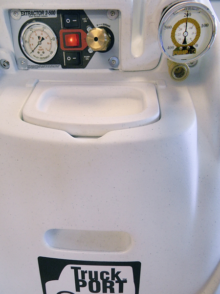

500 psi adjustable, heat,
and 200 inches of waterlift...
Bang for the buck!

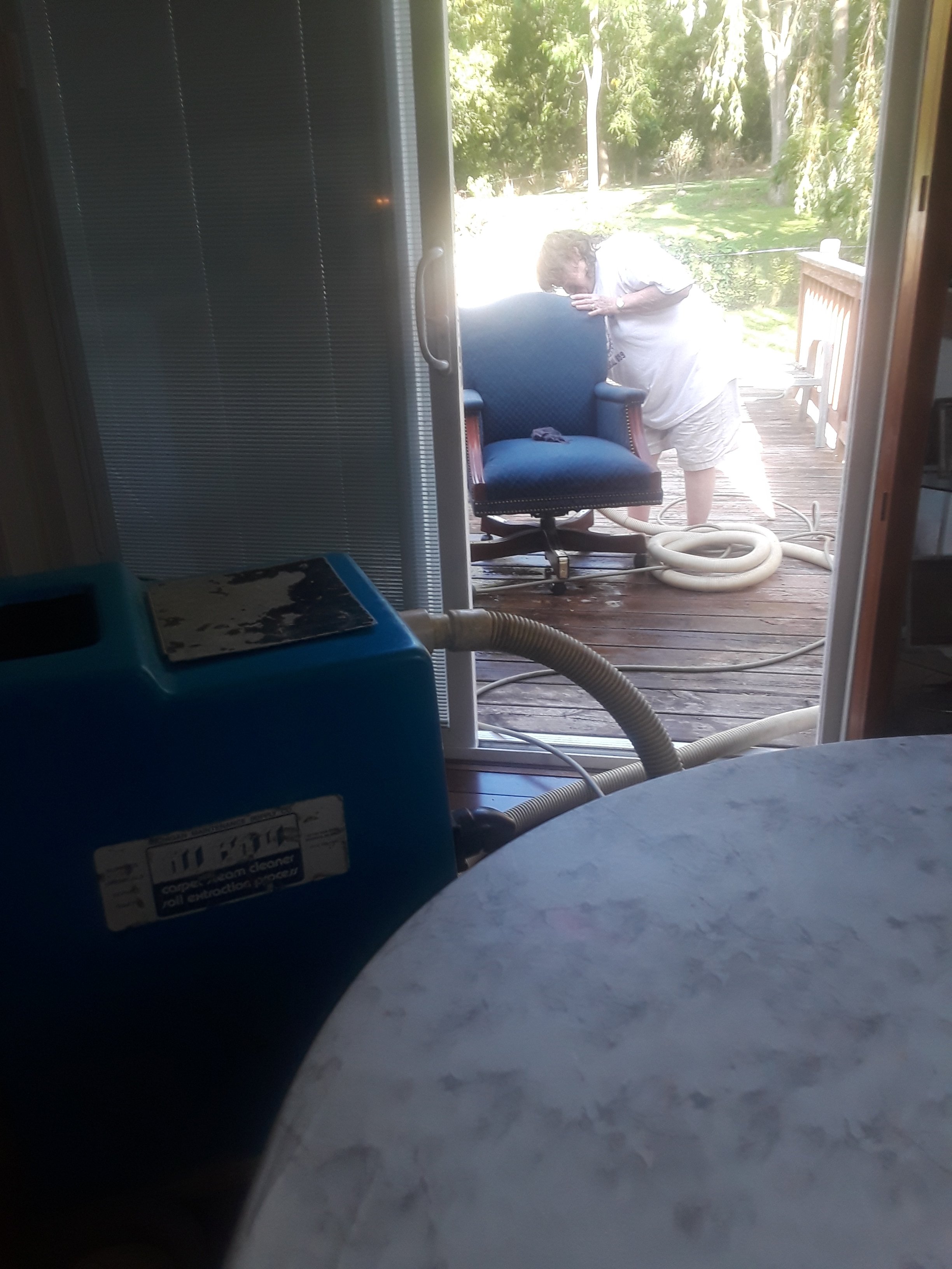

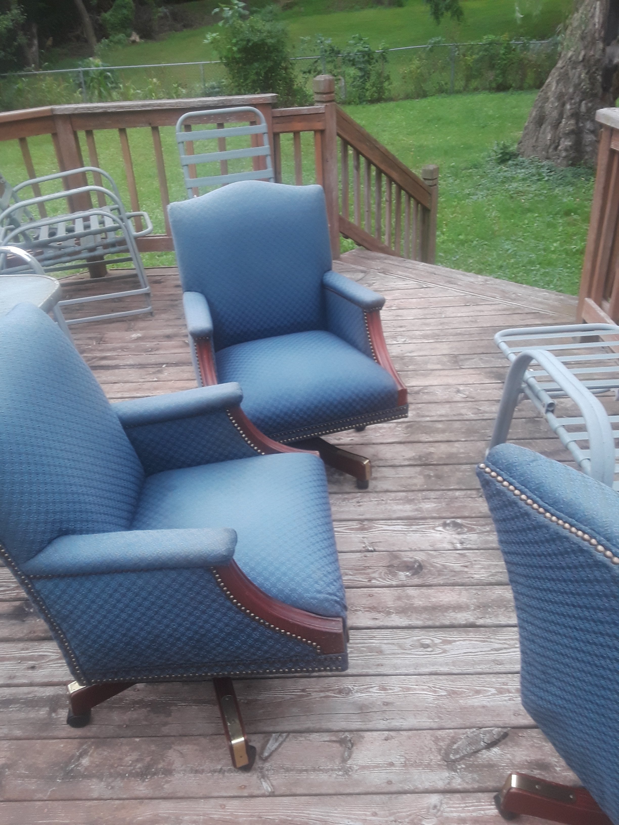

Art Kelly gave me this: I have no idea
What it is but it does a great job on the hen chairs...
