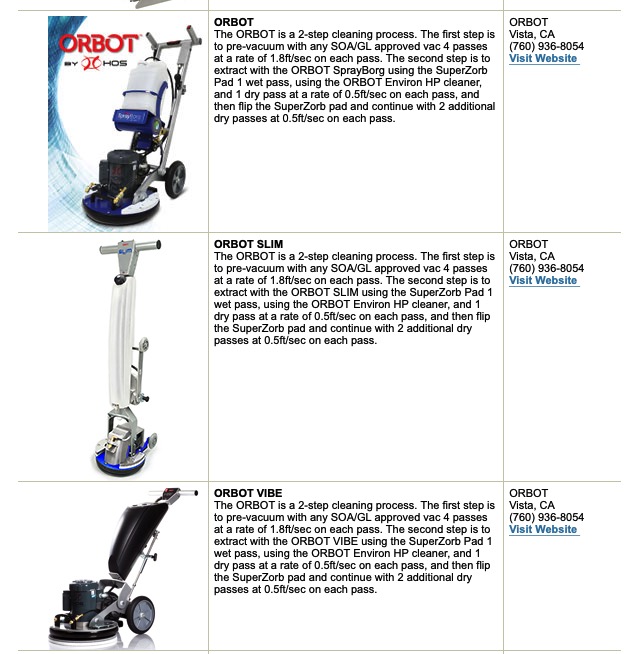

Tell management to look at ORBOT. They have CRI approval. The Carpet & Rug Institute has the Vibe, SprayBorg, and Slim models listed on their "deep cleaning systems" page... https://carpet-rug.org/testing/seal-of-approval-program/certified-deep-cleaning-systems/
Thanks! I'll look into these and see if it will work for what we need and then present it to management. I have been looking into encapsulation, but again they dont seem to keen on it. They want us to make it look nice and shiny, but dont want to give us the equipment and chemicals we need -____-
