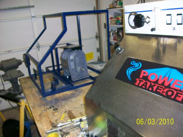

Genie # 2...begins!

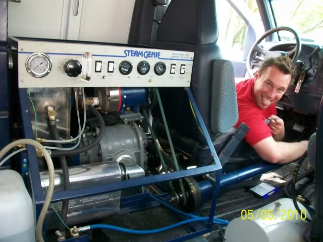

i'm taking pictures of the blower rebuild as well as a driveshaft rebuild too!
this one will be an econOgenie as there ARE used parts gonna be used!

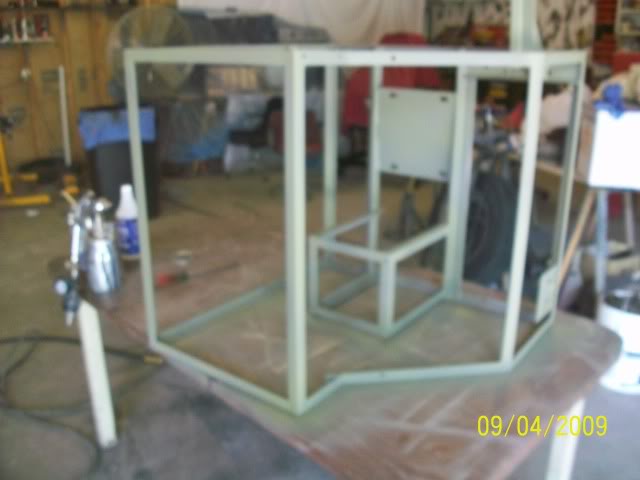

Chris Adkins said:
so are you building the frames now or are they still able to be found used?
ya..i've had to build two or three frames so far........
these FOUR machines will be my LAST ONES i make......
me an' momma's gonna go an' has some fun...
before wez croak.............!
i THINK i made THIS frame...

Check out the big smile on this guy...

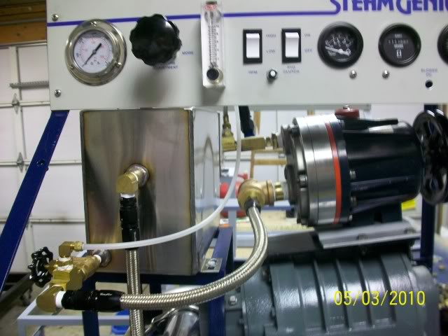

Jim Nelson said:
If your going to rebuild it why not put some though in to it and improve the design ?
although in my opinion the DESIGN can NOT be improved on...

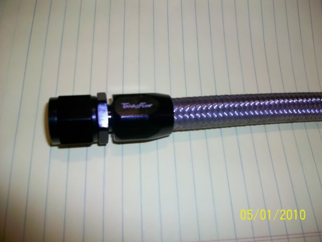

the components CAN...which is why i went wit the AN stainless aircraft quality hoses and fitting...non better than Trick Flow fittings...
and braided Stainless hoses..
show me ANOTHER machine that is aircraft quality????

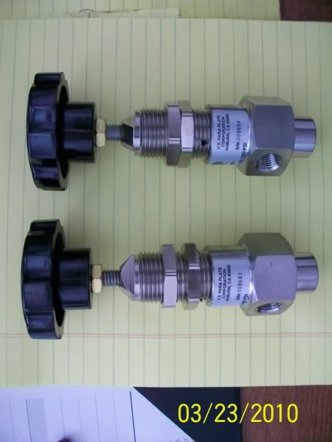

The Genie uses Paraplate Pressure regulators
Paraplate is a major vender for NASA...and have many components in the space shuttle

AshleyMckendree said:
Do you have those "Air Craft" hoses made for you, or do they come in a kit?
No...i make 'em mysef....it requires a chop saw..so's you don "frey" the ends...
perhaps i should show everbody how to put AN line together.......
much neater than a heater hose wit a clamp!

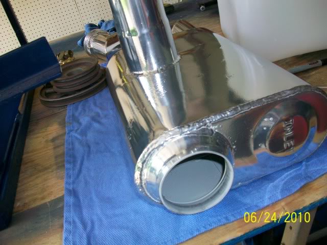

i got my ceramic parts back today....notice how the silencer is coated outside....
AND inside.....
