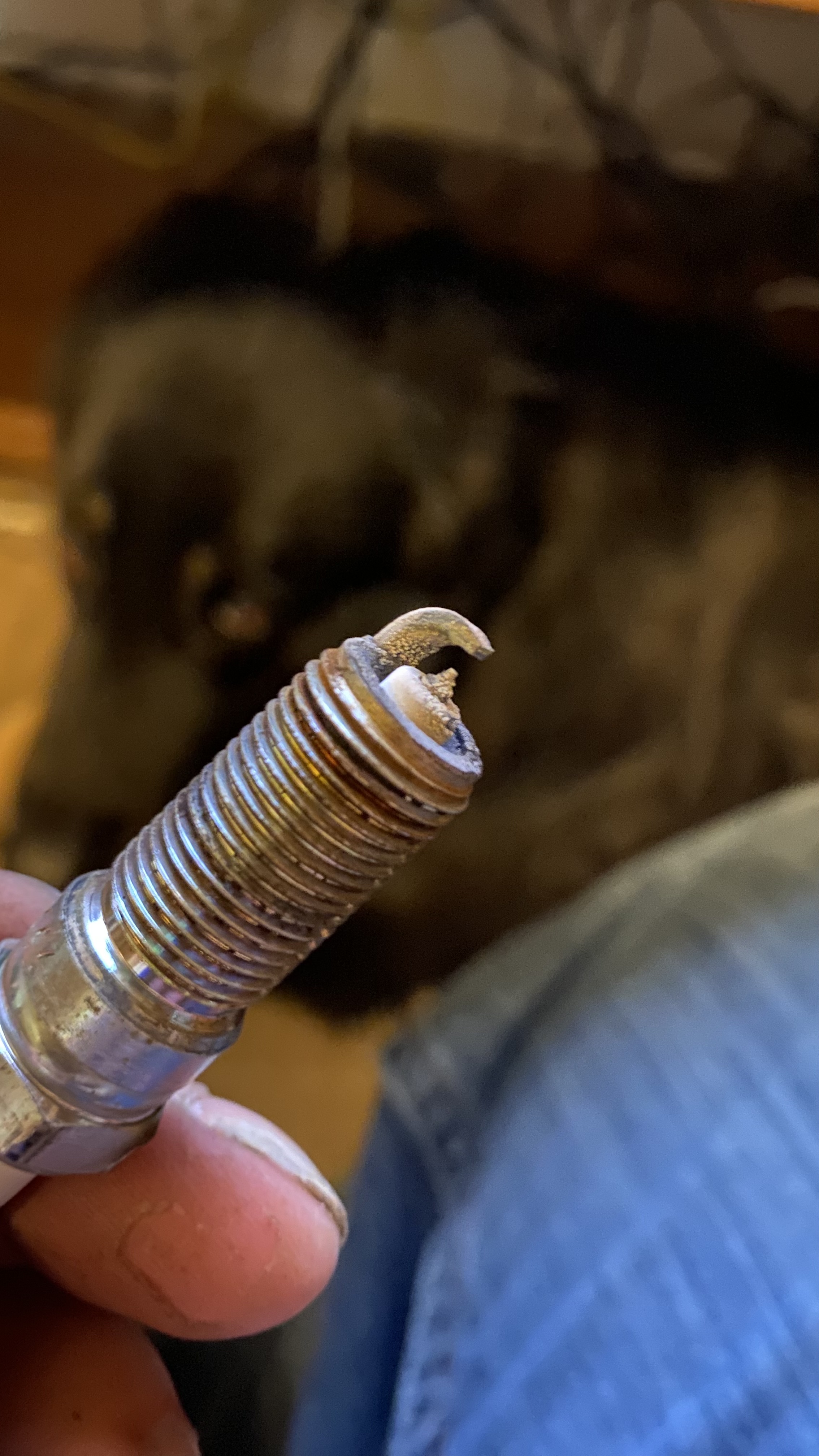

Ok Matt, I don't wether to kick you in the balls or hug you. Anyway. I Pulled the plug and codes from my 870. The codes it gave me were 113, 2229, and 1156. Now the 870 manual has no listing for the codes 2229 and 1156. My guess is that the 113 code is causing the other two mystery codes to appear also. I was told by Scott Harlib that those are just ghost codes it throws out sometimes. But after researching a bit 1156 and 2229 are all relater to biometric sensors on other cars. My 113 code is for the Mass Air Flow sensor, so maybe I'll order a replacement.
As far as my plugs go, they look good, just old. I noticed that some of the porcelain is wearing off, so I'll replace them today with new ones.

I was correct, that plug shows very lean/hot burning. Can you find a manual for your engine, not your 870? THere's no such thing as ghost codes.

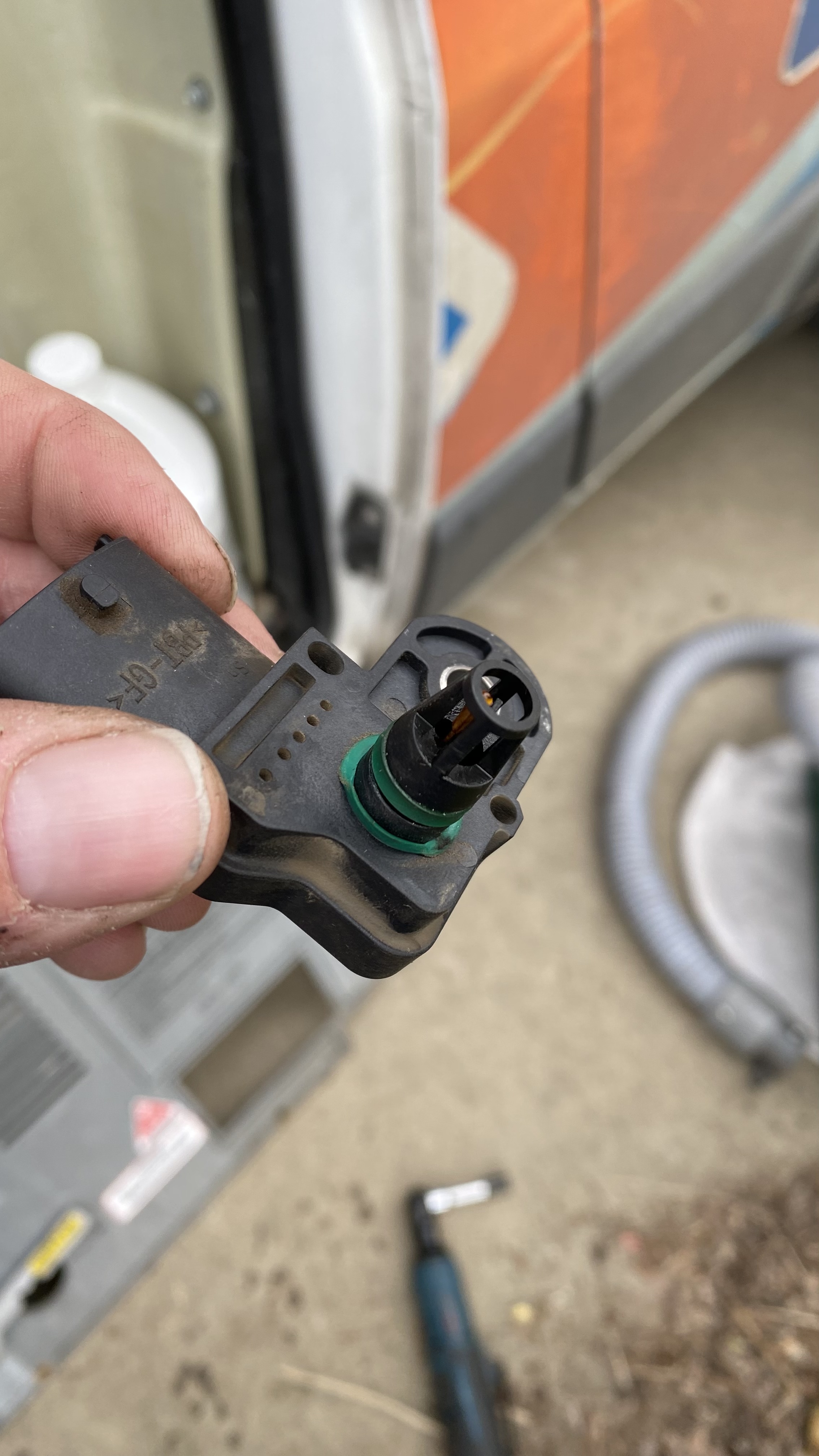

Yes. I just pulled the MAP sensor. Looks like the O-ring was crushed when they installed it. Look how it's smashed. That would certainly cause an air leak. I ordered a new sensor on Amazon for $17.

but that is the tmap from the intake manifold right?

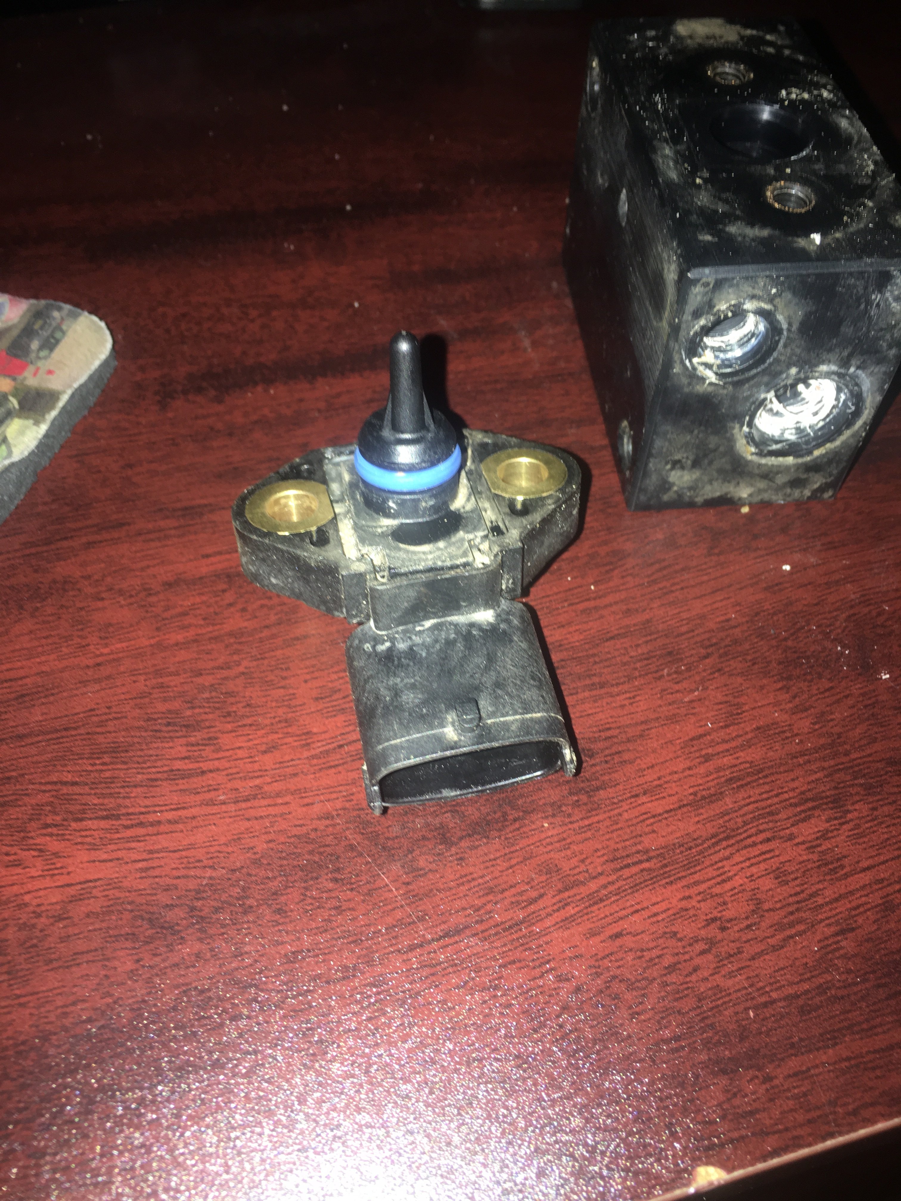

@BIG WOOD what is the part number you used for the one on the fuel manifold?
You are correct, that is the part on the intake manifold, not the fuel manifold. It's a different map sensor. What damon is showing is a TMAP sensor

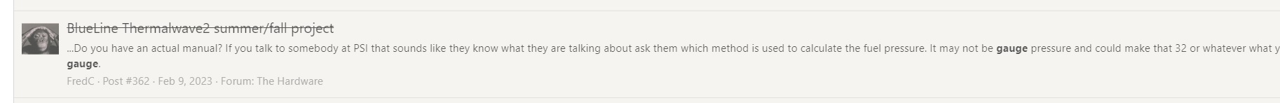

Why would sapphire/PSI/whoeverthefuckelse! tell us the pressure needs to be 50psi, and not tell us it has to be measured at Altitude 50 (A) instead of the Gauge 35(G)
Even Jondon didn't know the difference in the two types. Hell, they called me telling me they were confused because the computer read 50psi and the gauge read 35psi. I found that out through Scott Lombardi that there is a different measurement. Hell, I was very lucky to get in touch with him or they'd still be fking looking for an answer!!!!!
