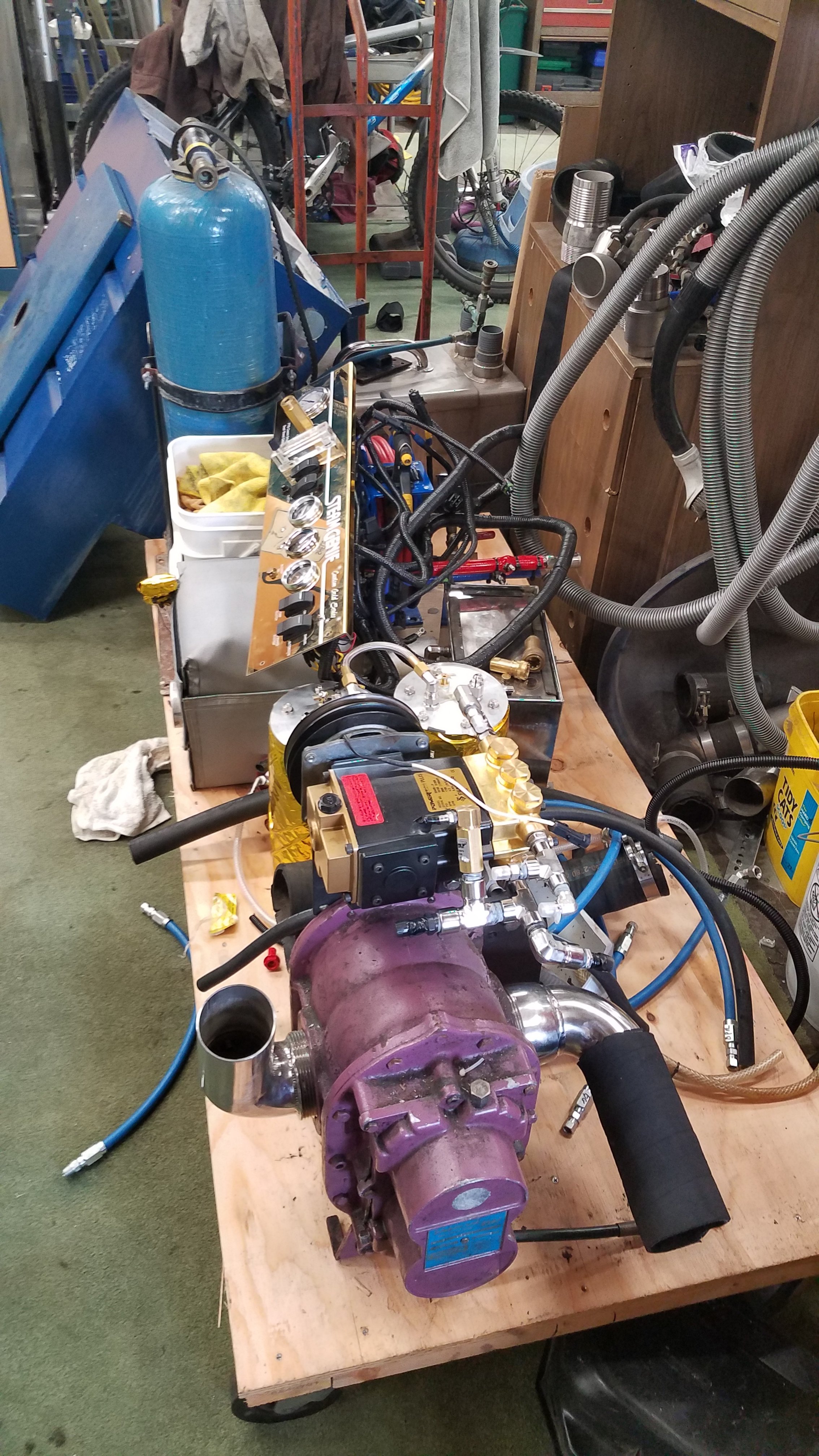

I’m taking it to the forklift later this week to move it. Rubber mats underneath are getting pulled up.
The waste tank was behind it but I think I’m gonna move it to the left side of the machine for better mounting space and ease of access to the rear and right side of the machine.
The van needs a power steering fluid reservoir, a tuneup, and a new rear door
As for the tm, the water pump needs tlc, and the 185f thermal relief valve needs replaced. 🤞. Once I get it completed, we’ll see what other issues it might have

When i built frankinstien, i completely mocked it up wired it and fit everything then disassembled it and sent the frame out for powdercoat, this picture is the entire machine less the driveshaft in a pile. There's not much their even less that'll break or need serviced

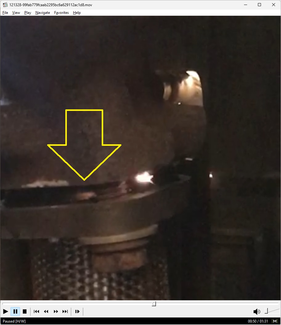

I cleaned out the CAT and it’s completely open. The headers don’t glow anymore but I’m noticing this on the video at the 49sec mark
Is that normal?
*update: I noticed those bolts were a bit loose since that's the new donut gasket I installed there. I tightened them down and I'll put another test on it tomorrow
14,497
grab it see if it shocks you....
Looks like a spark arc
No clue if static could cause it
I was wondering that. I noticed it sparked in another spot also close to the o2sensor.
I'll touch it on the next cold start and see if it pops me
Reactions: Donwand
looks like you may have an exhaust leak at the flange and the gasses ignited

Woody, I was joking .
That thing will be hot enough to leave skin sizzling after 30 seconds...
Nah, if there's a current on the block, it'll pop me in the first 10seconds of it running before it gets hot
