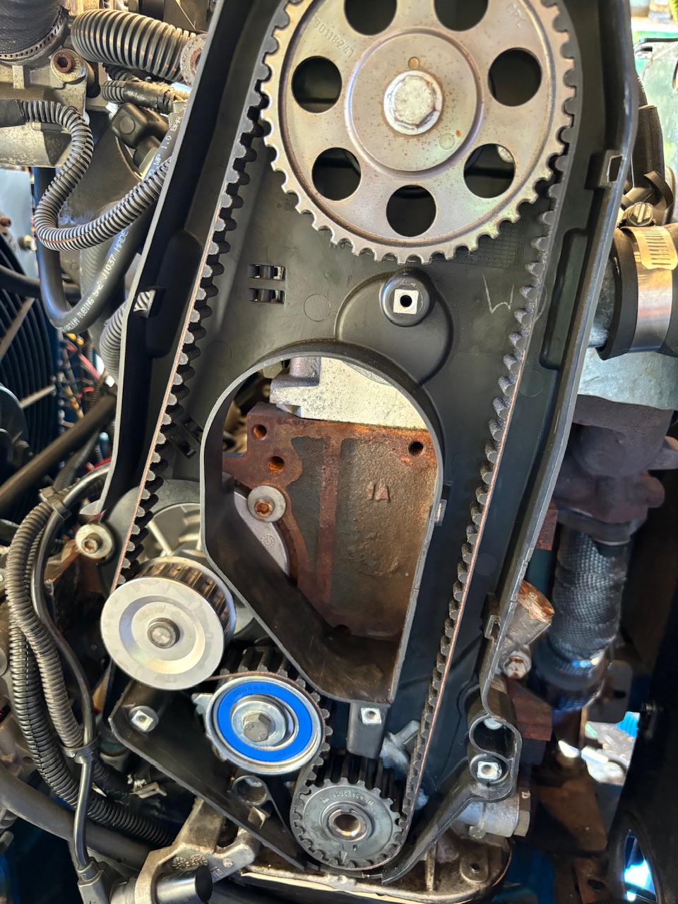

on the left side of the tensioner there is a "tab" with a hole in it. Push "up" on the tensioner to line this hole with the one behind the tab. Insert punch through lined up holes to hold it in place. Remove belt. Unbolt.
Thank you.

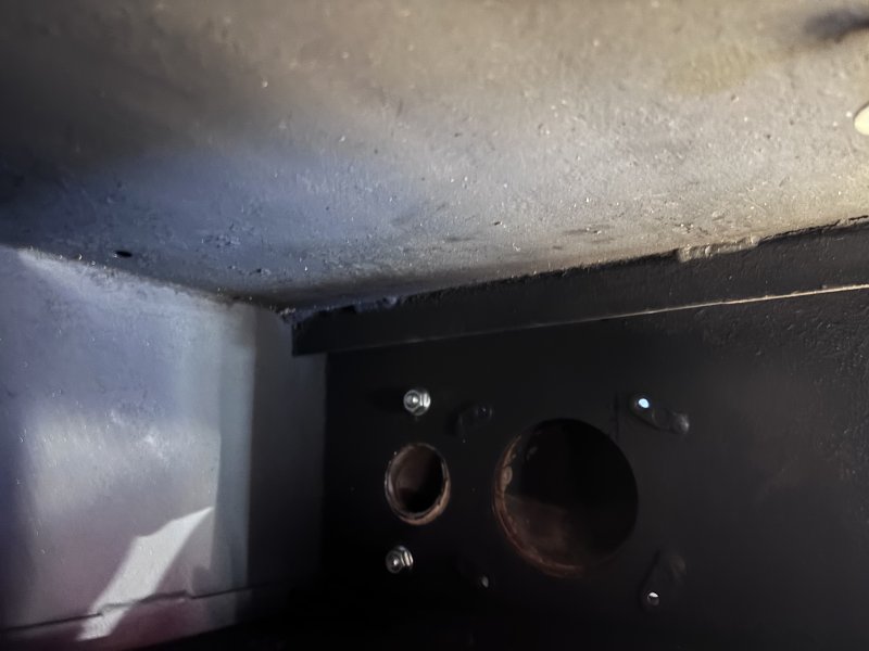

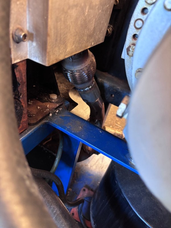

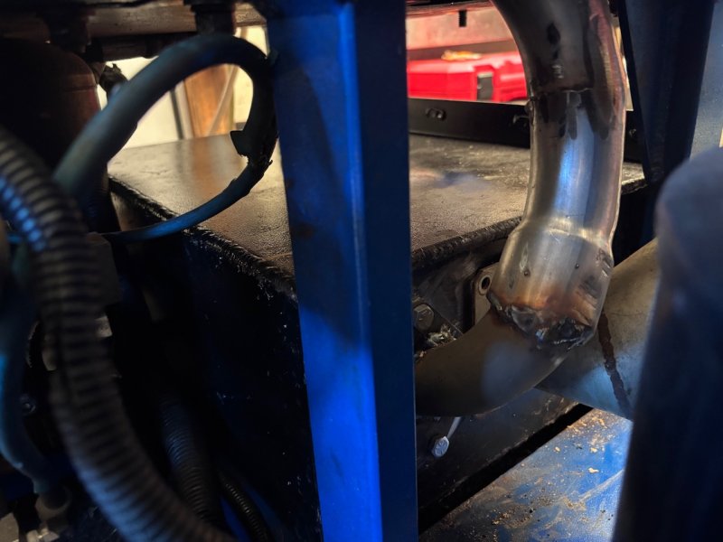

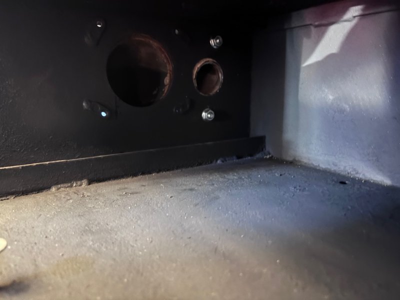

I finally removed the exhaust pipe/muffler that sat on top of the heat exchanger and routed the exhaust in the back of the heat exchanger box just like my Everest. So no more 700f muffler sitting inside my machine. It is now 250f external heat and using that to heat the water better

Yes, it has been cleaning allot of carpet with no problems. It's a very reliable setup and has been a great backup. It just never gave me the hot water that a machine this size should give. So I just kept wondering and asking others who have a really good understanding of this model how I could make it do that, and as I kept comparing the heat exchange system on all the other truckmounts this size (Everest 650, Hydramaster titan 875, etc) I got in touch with my shop guy and came to the conclusion that this is the best way to get that reliable heat without putting back pressure on the engine's exhaust.

Parts for the gm motor are still accessible. I ordered the ECU, timing belt and water pump directly from psi and the ignition coil is easy to get at auto parts. Any other parts are rarely ordered.
