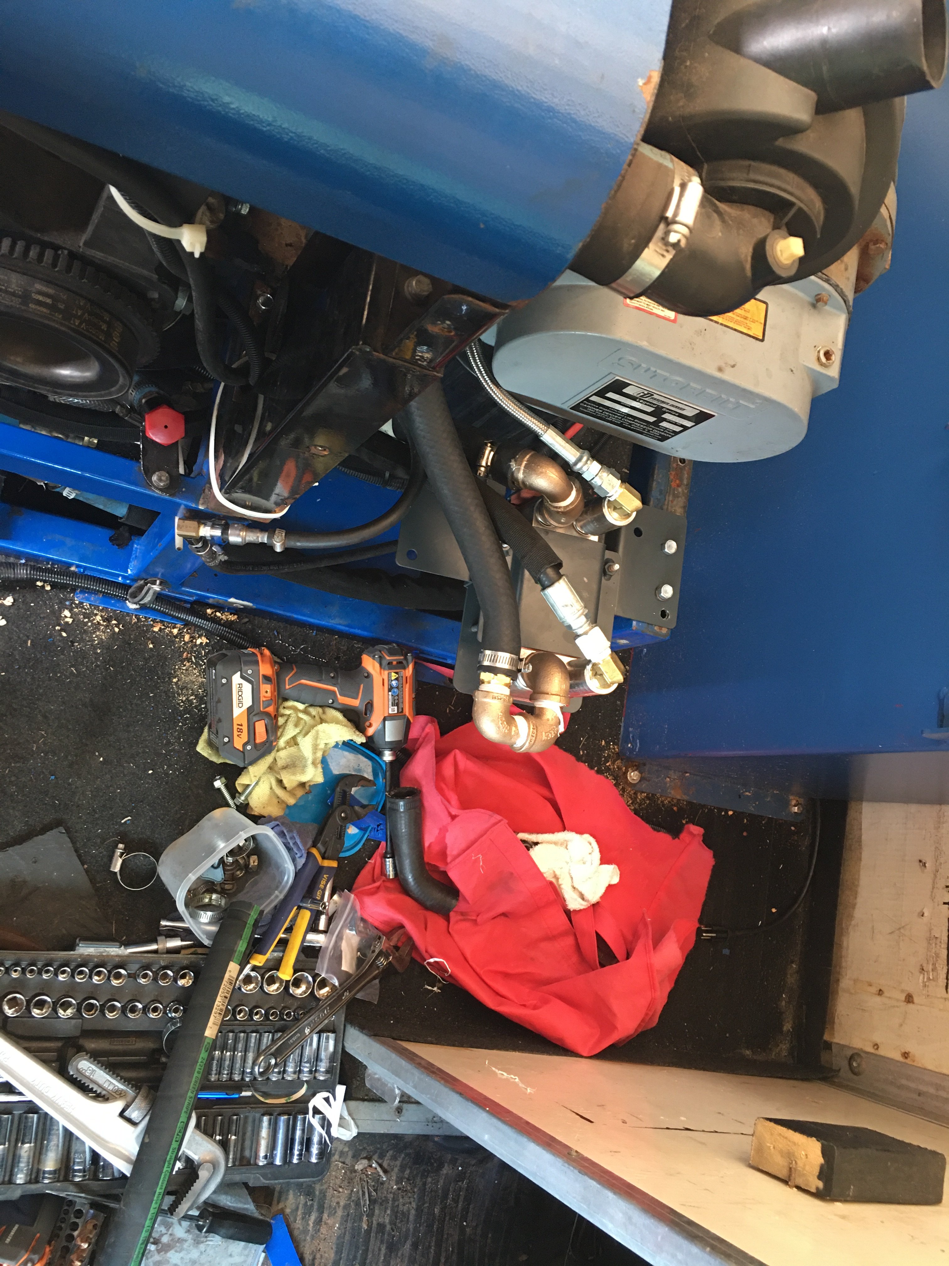

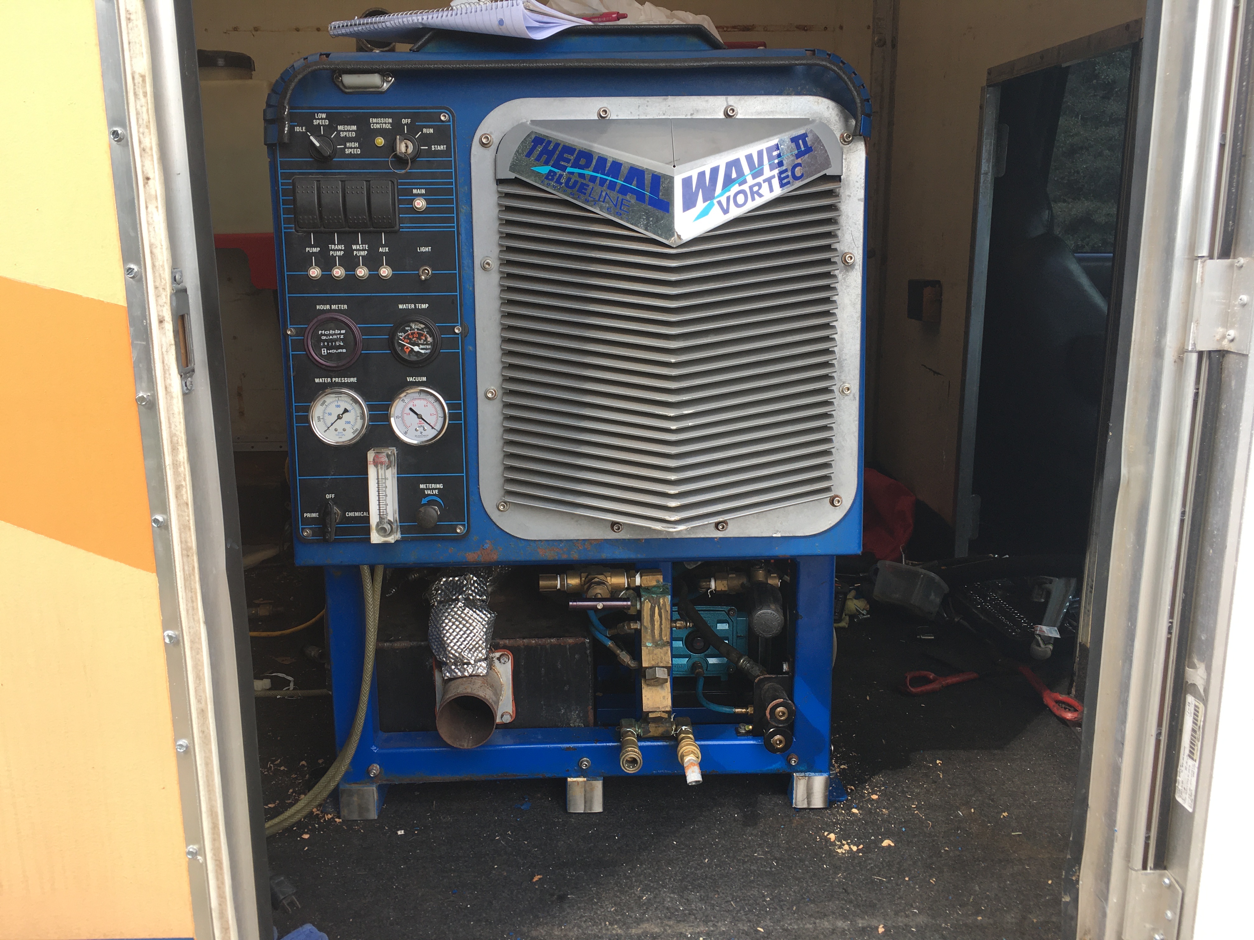

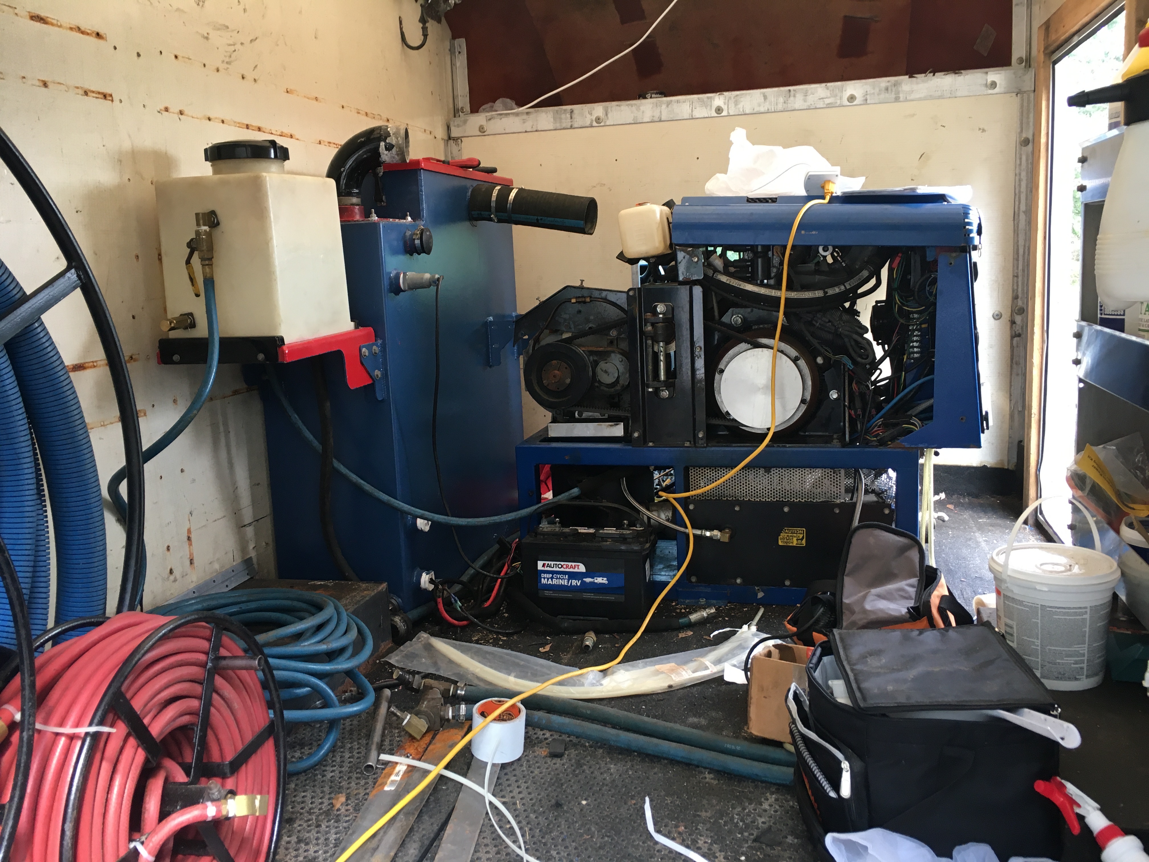

I’m taking it to the forklift later this week to move it. Rubber mats underneath are getting pulled up.
The waste tank was behind it but I think I’m gonna move it to the left side of the machine for better mounting space and ease of access to the rear and right side of the machine.
The van needs a power steering fluid reservoir, a tuneup, and a new rear door
As for the tm, the water pump needs tlc, and the 185f thermal relief valve needs replaced. 🤞. Once I get it completed, we’ll see what other issues it might have

I’m waiting on an aluminum pipe to be made to hook the blower up to the waste tank

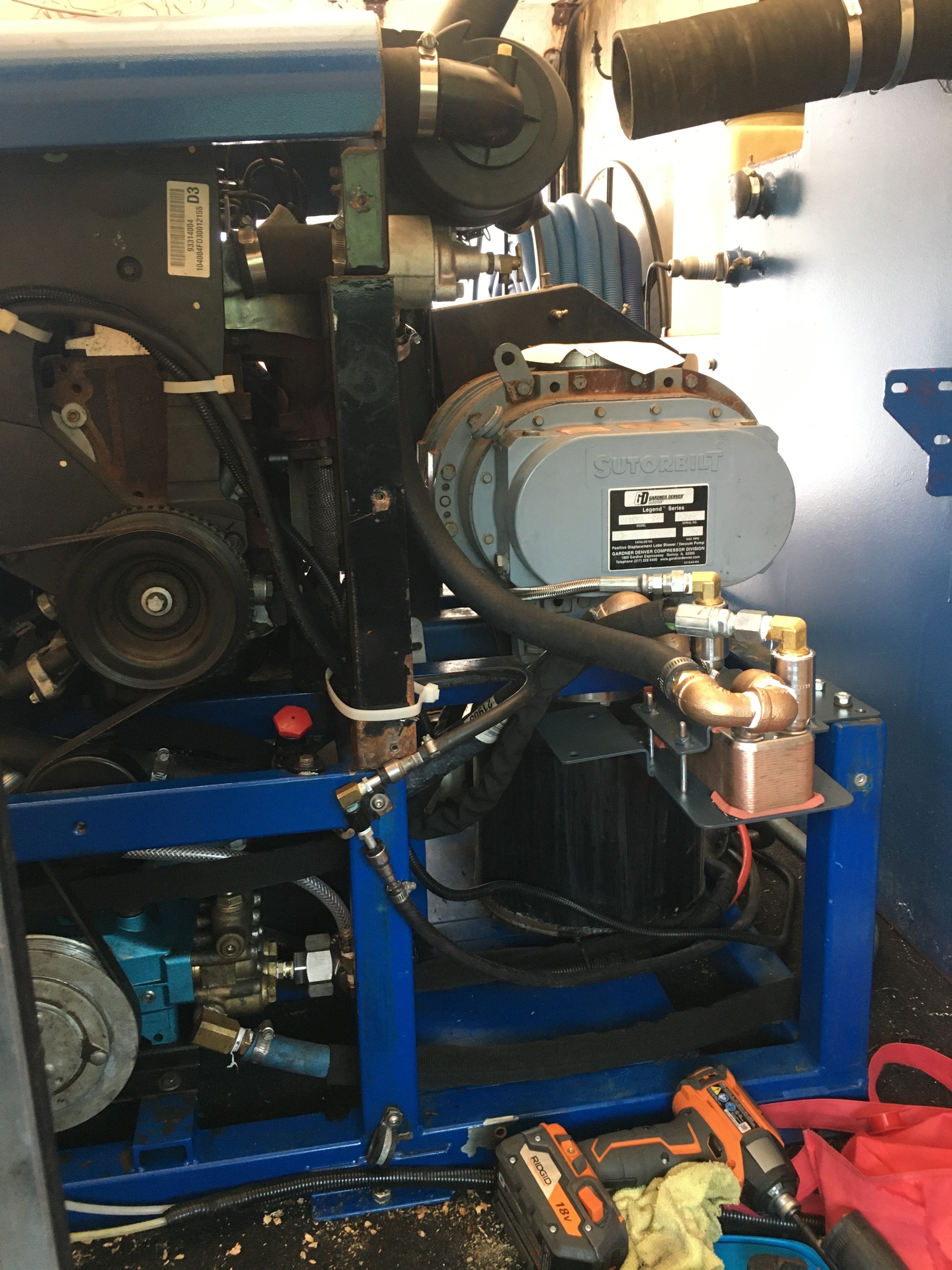

After lubing the pressure regulator and fixing several water and antifreeze leaks after first test

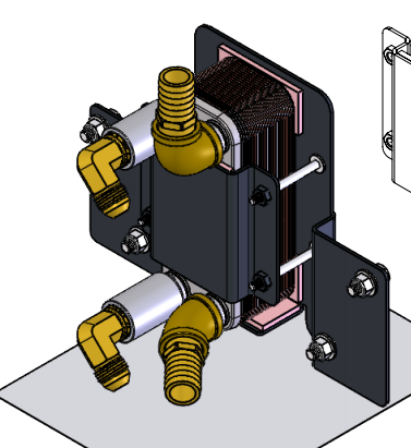

I got the heat around 185-200. The thing that puzzles me is when I pull the trigger, it holds heat pretty good. When I let off trigger, the heat drops fast. Any ideas on why it’s doing that?
And I think it needs a new thermostat because the anitifreeze is only about 135f at the coolant heat exchanger. Isn’t it supposed to be around 160-175?

Is it bypassing water when not triggered?
