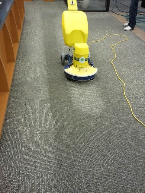

We just landed a contract to clean 500,000+ sq/ft (a year) of carpet in a school system. Contract is for the next 5 years and yes it was a fair price.
What I would like to know what brush or system you use to scrub in the pre-spray before hot water extraction. All of this carpet is old worn out glue down. I just need something to break-up the crud before we extract.
Yes, I know I have doing this for 18 years and yes I know I should know how by now. Most of the time I walk away from this type of job or over price it (this time I got the price we needed). I just like doing the easy stuff like drying the Grand Ole Opry but it is 500,000 sq/ft. of carpet cleaning. With three Vortex's I will muscle thru it.

A simple floor machine would do fine, get some pads(or brushes) and you are good to go.

Al, a shampoo brush under a rotary or a pile lifter with the vac motor unplugged will do great things... A CRB like a whitaker may also be worth a look as well... Mainly because it has an onboard tank and can do a decent job cleaning on its own with a good shampoo, and the collection binwill catch all teh crud the brushes dig up...

Al you probably already have a couple of 175 machines. Use pad driver and beige pads. Quick and easy.

no CRB will come close to a cimex for pre-scrubbing. Slop & gobble and a wand alone wont clean dirt as well as a S&g, cimex then wand.

A few cimexes or the big daddy Carpet Max which will do 8-12k sqft/per hour.
n]http://www.youtube.com/watch?v=wibJ65oOS1Qn]
I agree with Mike Draper I'd use the hydroforce and use the Cimex and just shower feed precondition as needed. (don't want to go through prespray too fast)
If you have an Orbot you could use the Sprayborg to apply and a Fiber Plus pad to break it up. It would do a nice job too.

If Al has a Cimex available, I would recommend using that.
Prespray with hydroforce and also put prespray into the mex tank and pull the trigger on really bad areas as you go.

I would go with a Brush Pro CRB machine. IT can provide the agitation and act like a pile lifter in the same pass when you use the renovator collector bins. Since the more is 50% stronger than similar machines, it won't bog down in nasty carpet.

Al ... I clean a LOT of schools every year. I have never had to brush in my prespray ... EVER! I wouldn't suggest you make this harder than it has to be.
