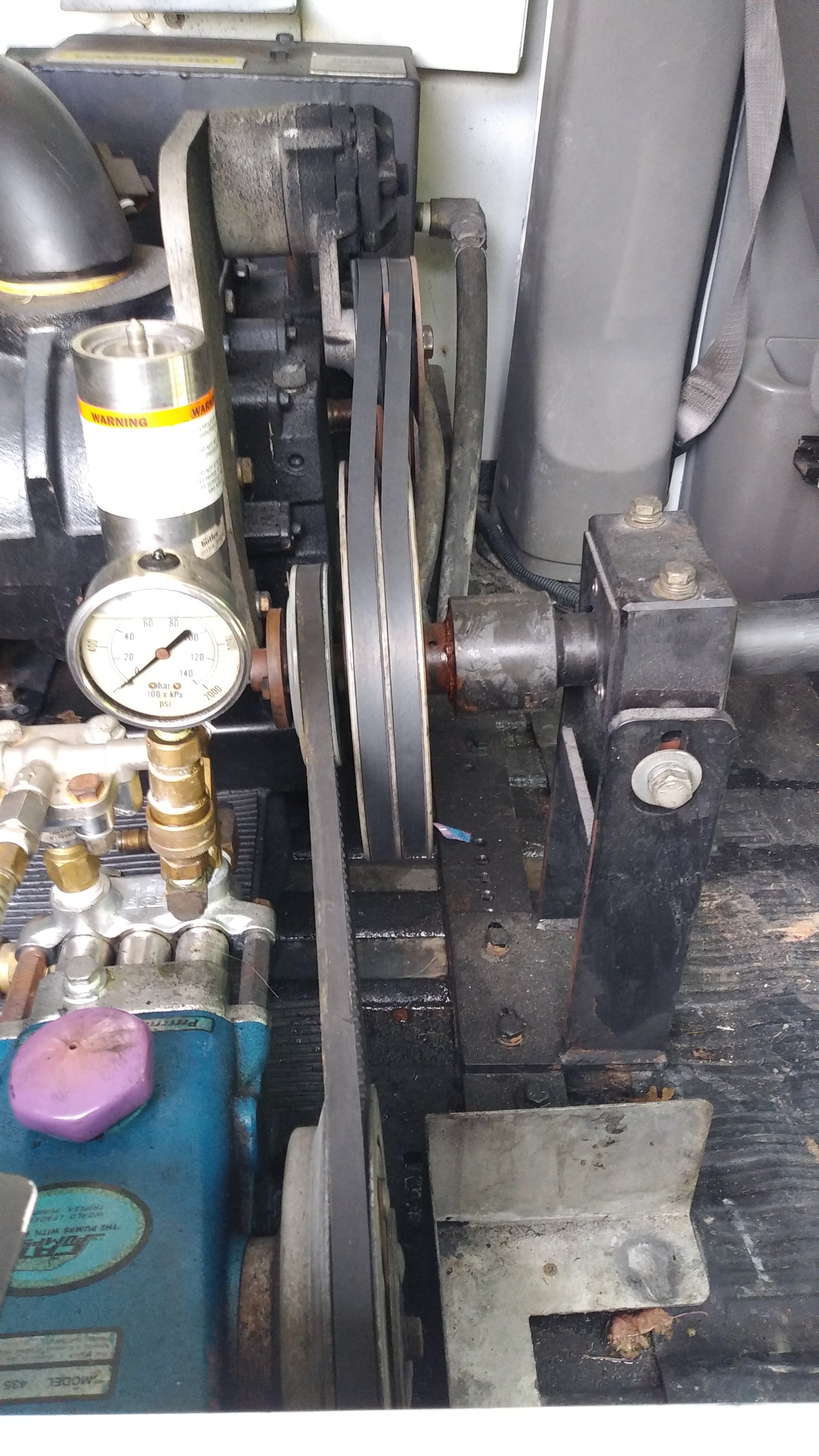

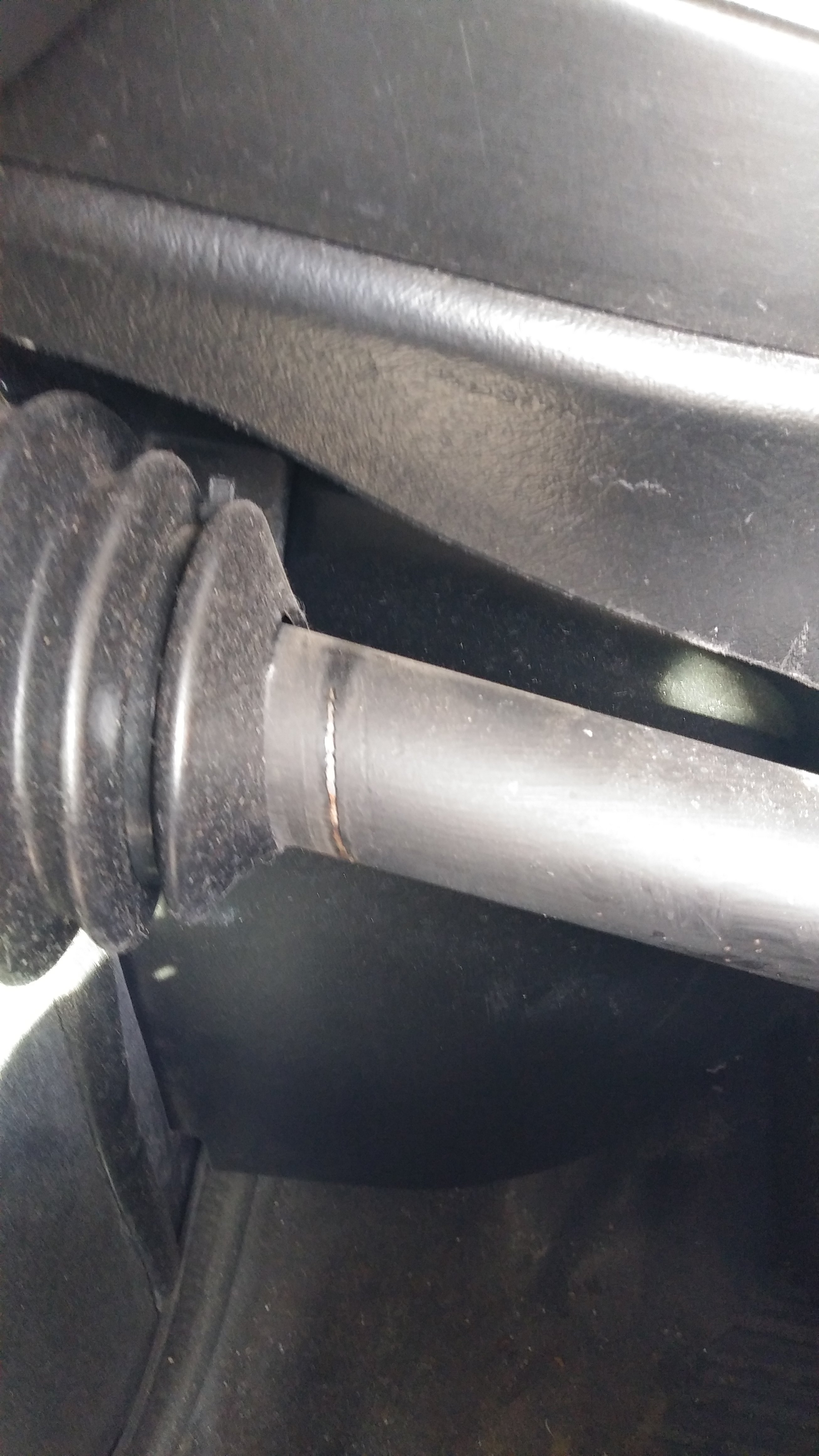

So do I need to loosen the bolts under the hood to readjust this driveshaft? Not sure how long it's been this way but I don't remember it being that way when I got it. 20200603_180310.jpg20200603_175918.jpg20200603_175857.jpg

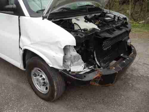

We're you by chance sitting in the front seat when that dude punched your face in 1.5 inches?
Haha maybe when I slammed on my brakes though.
I got it. I just wasn't sure those bolts under the hood would move the pulley alignment too.
Still have a little vibration I can't quite eliminate.
13,372
The whole driveshaft looks to have moved back half an inch or so?
What's the alignment of the front, clutch, pulley?
Thanks Lee I got that part. Is there a sequence for aligning it to the pump and blower? Got a little vibration yet.

To start, the pulleys at the back are at the right spot on the drive shaft. Use that as an index. I'd loosen the middle and front shaft supports and push the shaft forward. I'd need to see a picture of the front to go further.
I'm surprised all your belts didn't come off. You had to HEAR something very wrong.

If vibration, also check the fan clutch. Grab it and shake up and down. If a bunch of play it needs replacing.
Butler uses a non thermal aftermarket clutch with a slight bit of machining. You would need to order from them thay fan clutch
I was surprised it was only wearing the belts. There is black rubber spray on the tensioner. I wonder if some of the rubber I had been smelling was coming from that. After the front belts broke I assumed that's what it was. The belts were put on end of last year. No noise. It hasn't been run a lot.
Chip thinks I need a new driveshaft.

I will check that out today thanks Mark.

if your driveshaft is going I would think you would hear it rumbling and maybe even feel it. Like a wheel bearing in your car. At least on my old one that was the case. I still have a spare shaft sitting waiting. BUT the truck is long gone!!! LOL. I used to like being prepared. :biggrin: Got a clutch as well. !
You must have kicked in the afterburners when stepping on the gas to have shifted it to the rear like that. !!!!:biggrin:

Just got back from picking up dinner and still had the cover off. It was making quite a bit of noise. I was just going to post about it.

tough luck so was just looking for confirmation. he may not realize there was a bracket holding the front end right next to the clutch somehow
I said the front was fine. I know the bracket holds it in place but wasn't sure if breaking those bolts loose would move anything. I didn't think so but have had a run of bad luck so just wanted to make sure. It was easy enough to to get it back into position.
Man that shaft moves a lot going down the road. Might take a look at the engine mounts one of these days.
