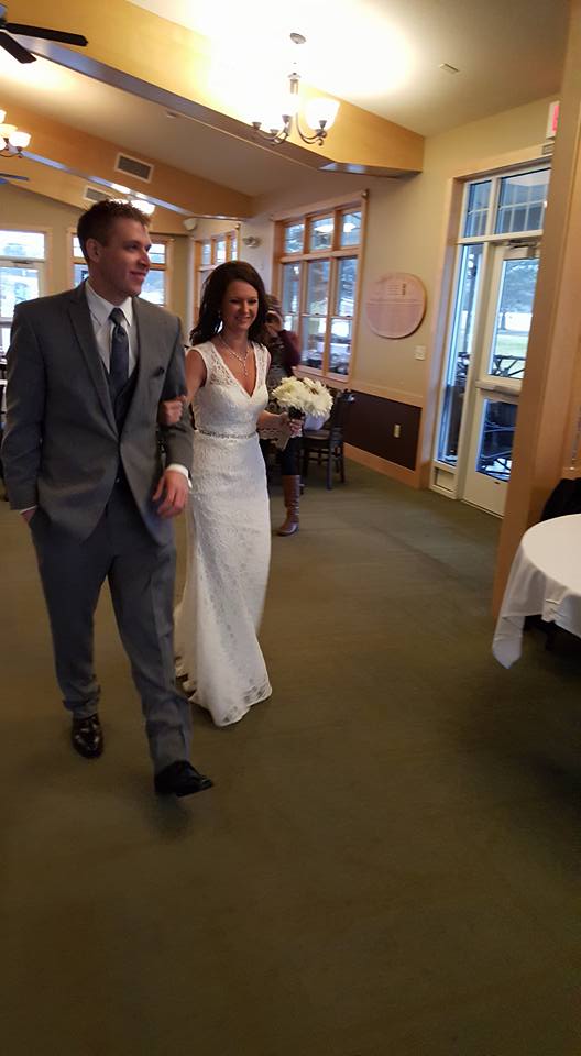

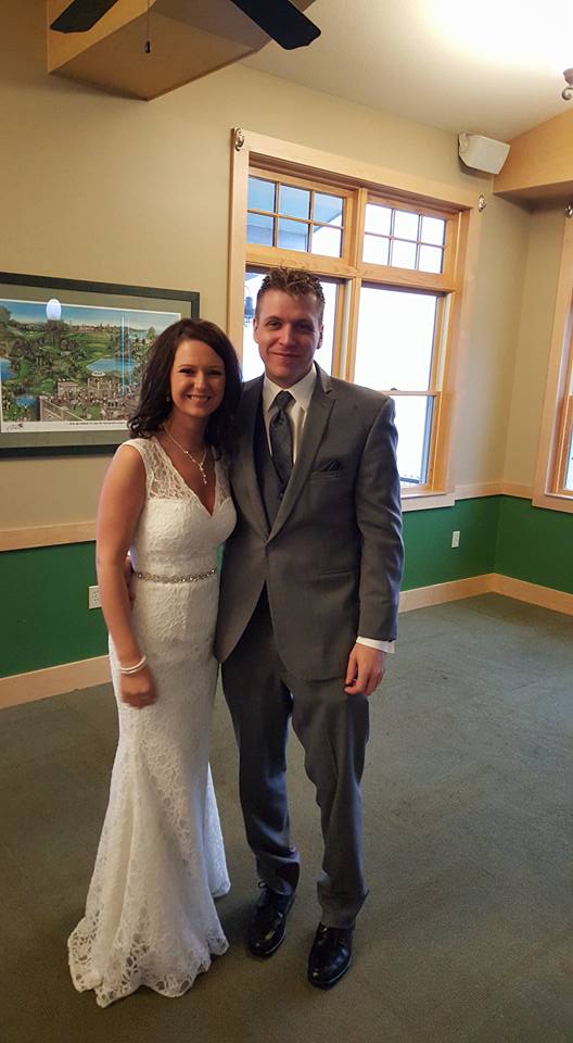

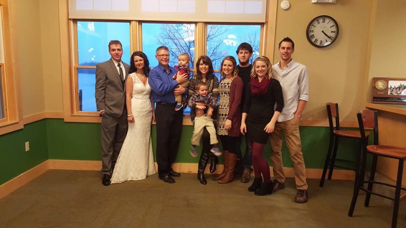

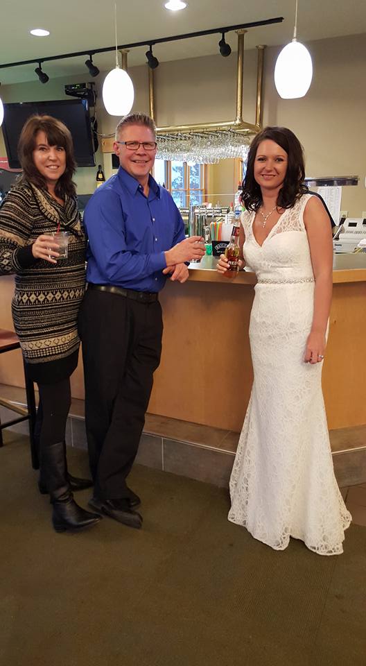

And we held one of our Daughters weddings there a year ago...and the carpets did not look like that until this past time he did them...
Told them...I can clean it...but not going to spend a bunch of days trying to clip off the problem fraying spots...
We are going to get a chance at this place because the Golf Pro of the clubhouse...we just cleaned his carpets again at home...and the guys did such a great job....he called and scheduled to do the rest of his home this week....
We will see from there...but the pics here might give an idea to the condition of the carpets before the last cleaning....and the wrinkles in the carpet were not present until the cleaning....
