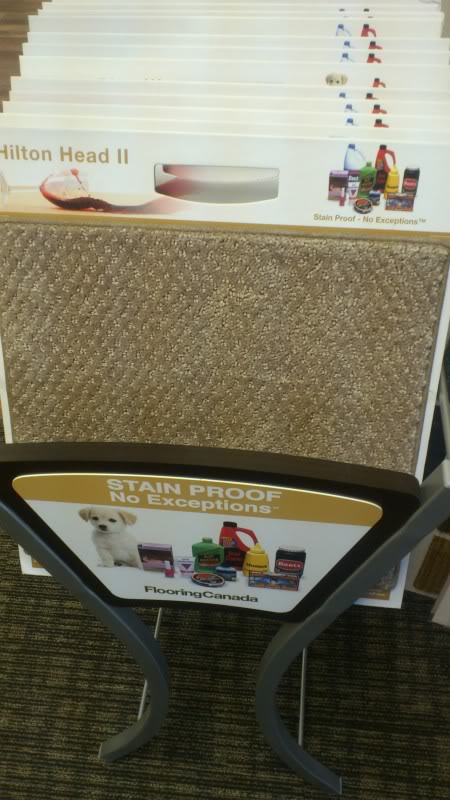

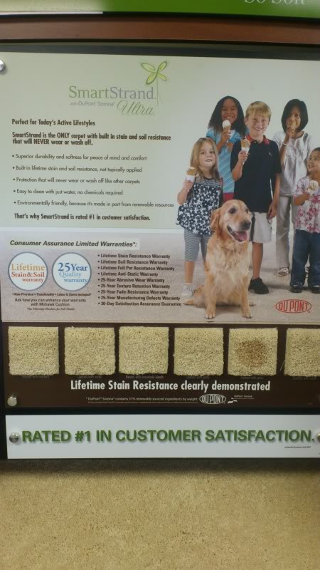

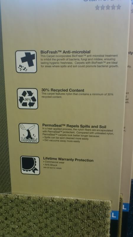

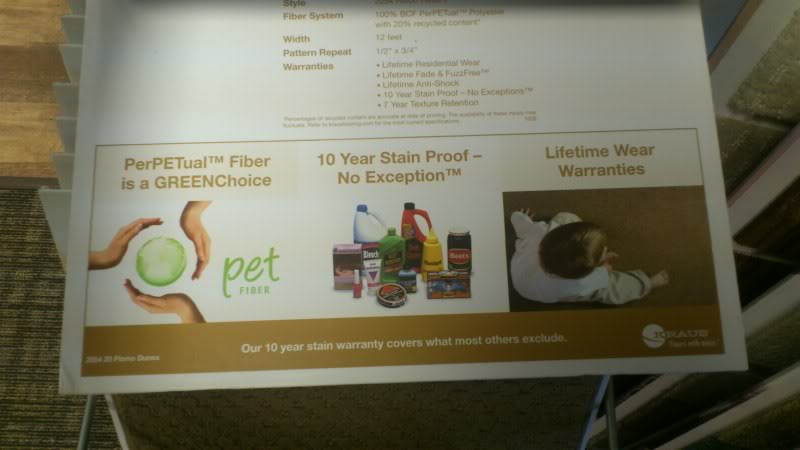

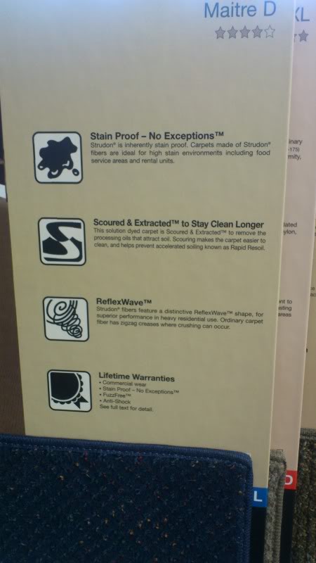

I was in a carpet store today and saw the claims made about the new Smart Strand carpet.
If I were to go by their warrantee claims I should never have to apply protectant to this carpet...ever. The salesman did say they recommend the application after 5 yrs.
Opinions?

When anyone makes a claim for the lack of need of a Protectant on any carpet, there are certain assumptions implied.
Polyester (PET), PTT Polyester (Smartstrand), and Olefin marketing often purports rightly that they are largely immune form certain staining issues that would ordinarily be solved by the addition of a protectant on other fiber types. However, they ignore that soiling and staining of carpet is not all the same.
Polys and Olefin without a protectant are all subject to dry soiling, and oil based staining, as much, if not more than other fiber types. Polys and Olefin are particularly adept at absorbing non-polar oils and greases, for which a protectant could afford protection.
When these products are marketed as "indestructible", the conditions presented are usually well controlled and devoid of soiling circumstances for which unprotected Poly and Olefin are vulnerable.
The manufacturers lone argument is not to classify oil spots and dry soiling issues as a "stain", per se. So in this perspective, the product indeed "does not need a protectant". However, we know the devil is in the details. A protectant indeed can have a demonstrable value on these carpets.

I understand the antimicrobial properties that were being marketed as "odor eaters" by a certain mill earned a complaint to the CRI from Shaw and hint of lawsuit. Shaw tests found no benefit. At least the marketing shown here doesn't make that big of a claim.
By the way, lifetime isn't your lifetime. The mill decides the terms of the life of the carpet. They are also well aware that they can promise just about any long-term claim up front and not have to back it up. Most claims are in the first few months, after that people forget about the warranty. A good retailer will downplay mill claims anyway since they know the complaint will come to them first.
