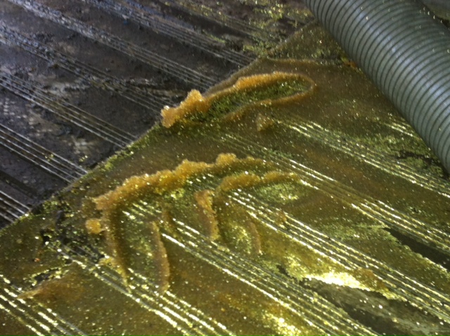

This was the resin that I got from cleaning out the filter on one clean-out. This was shot up close it is about 6x6 inches actual size

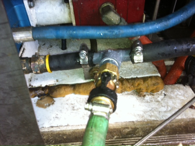

put it in line......before cat pump.....take off cap...hook up garden hose...turn on...instant prime....take off hose and put cap back on.....your set......

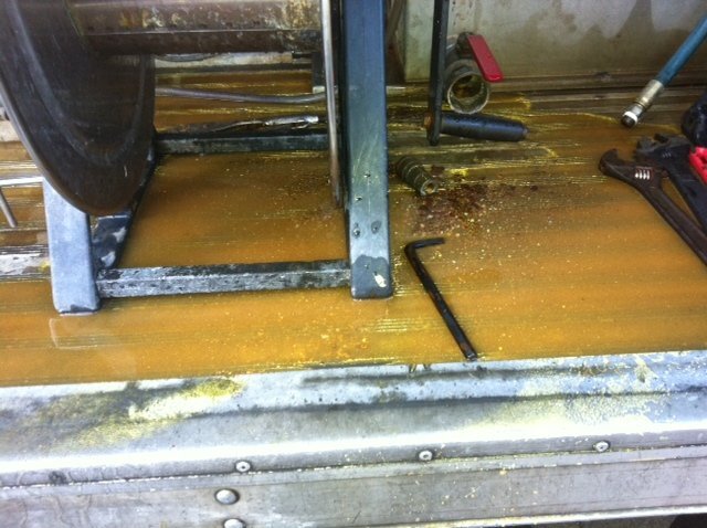

Ok here goes, Jim followed your advise and instructions. Worked from 11am til 7 pm on removing the gold dust resin. I'll post some pics so everyone can see how bad this crap was. Keep in mind that I filled and emptied fresh tank 2 times before taking the lid off. Jim had to homemake my t but was able to get it installed, after removing all qc from all hoses and all fittings I did have running water out all tree lines when hooked up to garden hose. However no luck with any water pressure from the pump with and without the water hose attached, so I must at this point say the pump is trash. Documented all pictures as I went along for later use
if needed.
Here goes
Jim had to make your T from parts
http://i840.photobucket.com/albums/zz326/wizardcarpet/photo-16.jpg[/IMG
[IMG]http://i840.photobucket.com/albums/zz326/wizardcarpet/photo-19.jpg[/IMG
Followed your suggestion on elevated bank, my front yard, I think the neighbors think I had lost it!

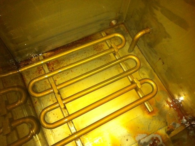

[ATTACH=full]54845[/ATTACH]
Tank after flushing on bank
[ATTACH=full]54846[/ATTACH]
Crap everywhere
More to follow

MOre pictures of the gold dust
http://i840.photobucket.com/albums/zz326/wizardcarpet/photo-20.jpg[/IMG

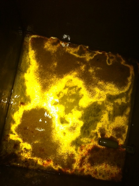

The reason I nick named it gold dust, it's about 1/4 in deep on the entire tank with about 12 inches of water in tank
[ATTACH=full]54847[/ATTACH]

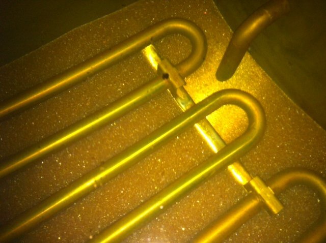

This may be a repeat, resin under heater tubes
[ATTACH=full]54848[/ATTACH]

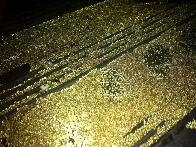

This is what I woke up to this morning, from where I filled and drained tank 2 times. I actually couldn't see this when it was draining.
[ATTACH=full]54849[/ATTACH]

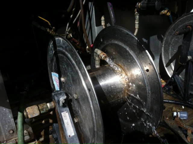

A shot of running water with pressure from the hose only. All three lines are cleared
[ATTACH=full]54850[/ATTACH]
This is why I nick named it Gold Dust
Enough, I think I'm going to go puke
