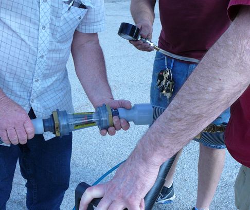

Capt.;
There are several different flowmeters that actually read CFM.
We have one instrumentation type with sapphire bearings, but it is too complex for everyday readings.
This is the flowmeter & digital vac gauge we used when we tested the Bentley against the 1st DevPro 14" non-swivel.
On that test @ 100ft. we recorded 260 CFM for the Bentley and 230 CFM for the DevPro.
A year earlier, we recorded ~200 CFM for a 14" x 2" CMP low-profile wand on similar carpet.
So that was 15% more CFM for the DevPro and 30% more CFM for the Bentley (with the same 16" of lift at the TM w/#47 blower)
http://www.cobbcarpet.com//zen/index.php?main_page=document_general_info&cPath=63&
28,214

View attachment 14242 Capt.;
So what is the CFm without the wand...just hooked up to the 2" hose
