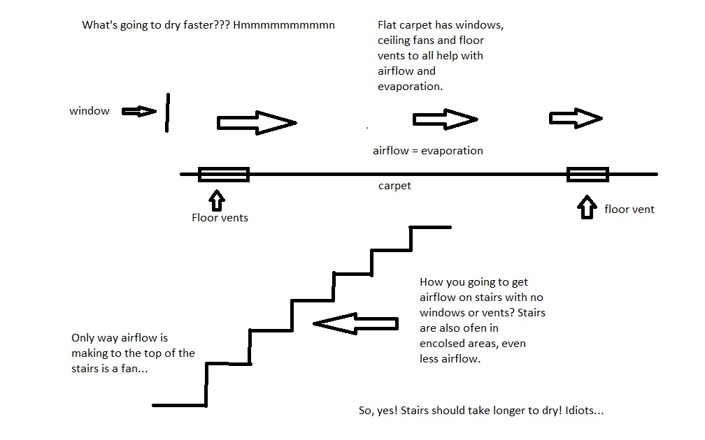

Stairs are generally the last thing we/I do in the home as I work my way out... Because of this, they will always be the last to dry... Stairs are also the most dangerous for clients - I want them to put a fan on them.
That being said, I do believe that stairs will take longer to dry than a flat surface.
How many stair wells have ceiling fans or windows? If they(stairs) did have a window - as soon as the air hits the riser it will slow down dramatically.
Again, this is my opinion - simply seems logical to me.
