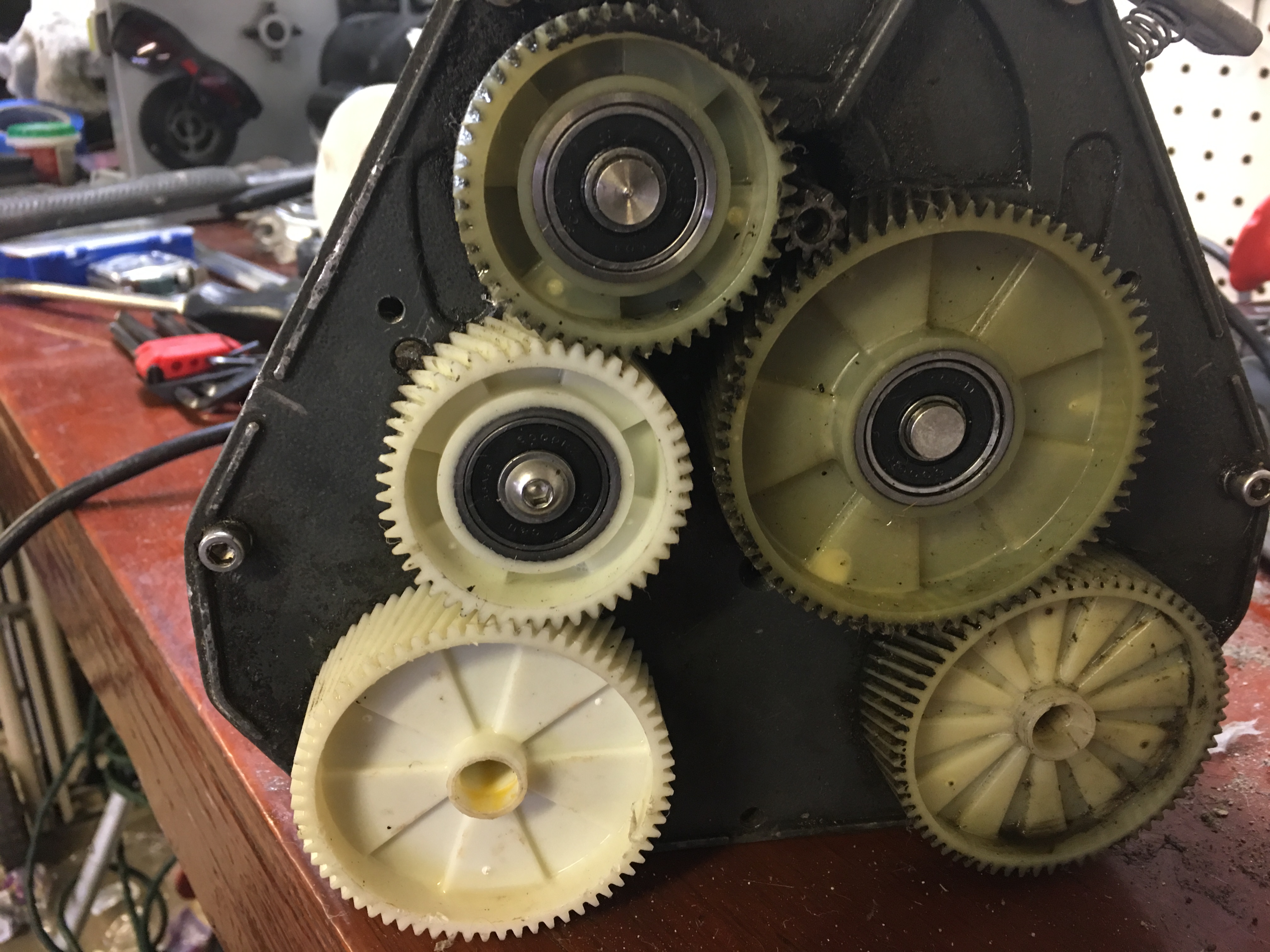

I don't know how to get this thing apart. What a horrible design. I'm off to Harbor Freight to get a small gear puller. I tried heat, that didn't work.

Well this helped. What a stupid design by Strong Dry. Seriously. How am I going to get to these allen head bolts! Ugh. Never again!

Damon, use thin wooden wedges. Oppose them and gently tap until the shaft releases them.
Door shims will work, 99 cents a packet at Lowes.
Looks like they need to disconnect from the back. The video says they will not come off from the front. Whats the point of the snap rings then? Seriously a retarded design.

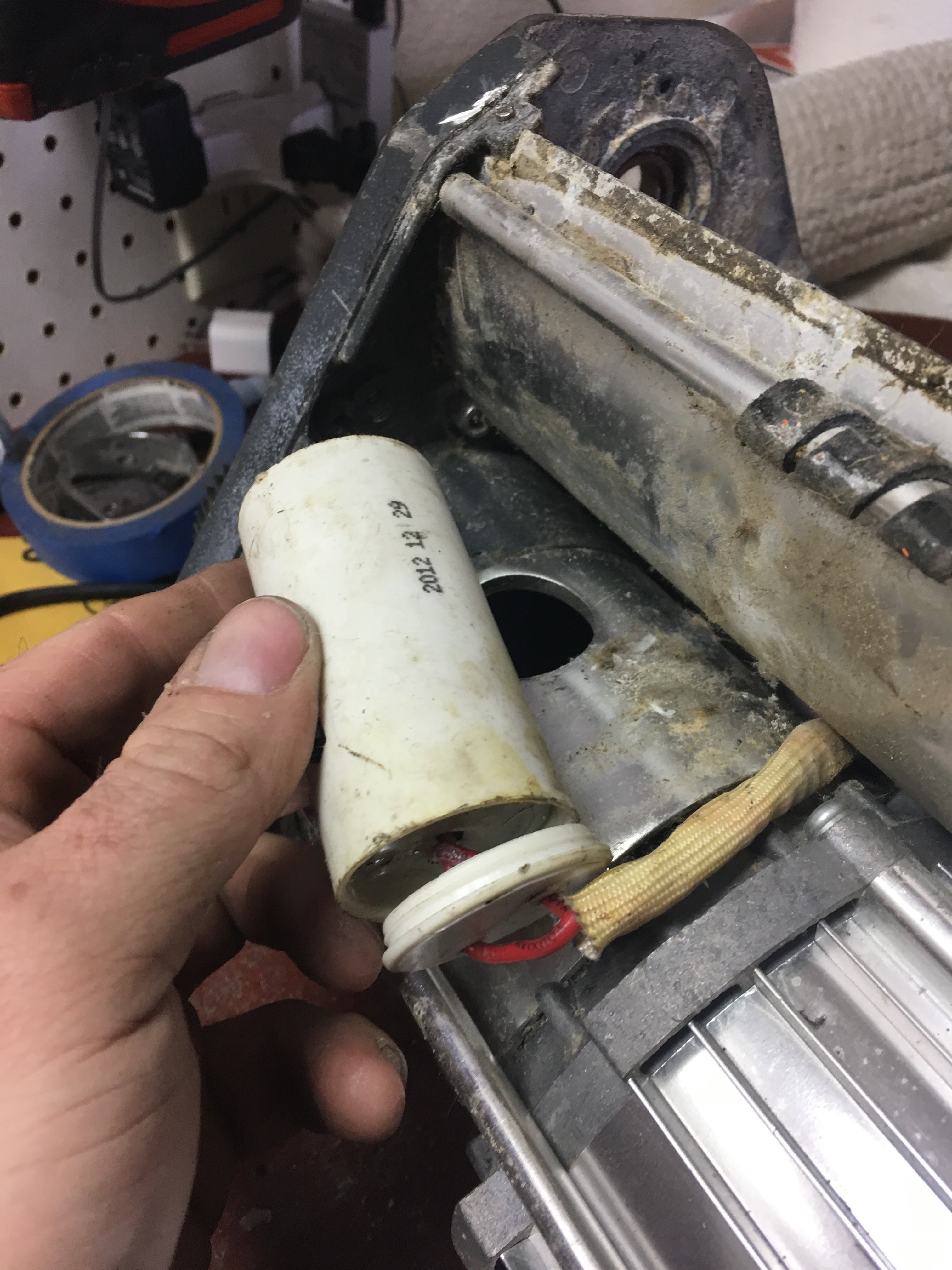

I had to remove the capacitor to get to the allen head bolt. I’m making progress.

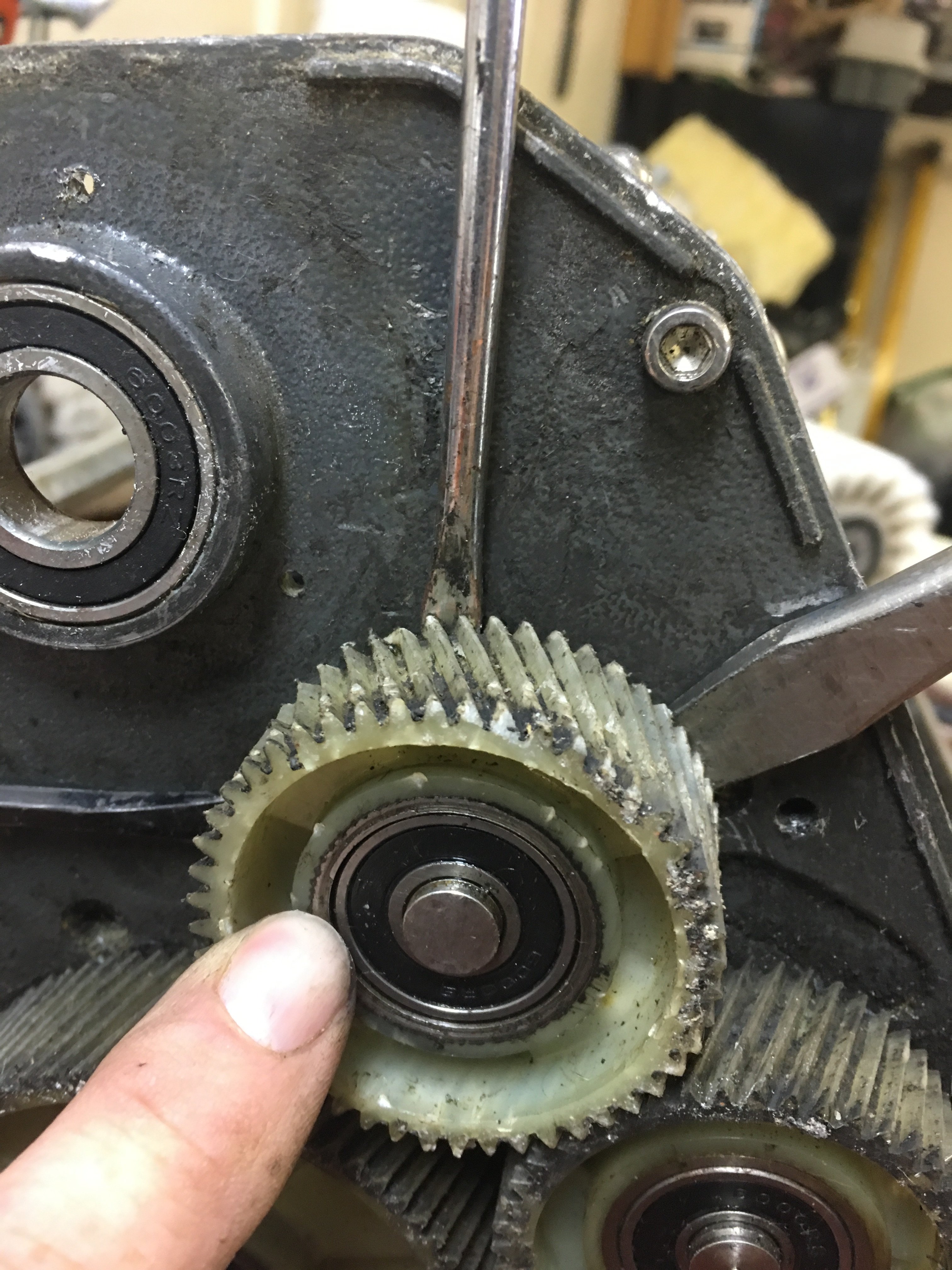

Looks like i got it. The gears fit perfect. Im only replacing the broken gears. I’ll keep the others for future repairs. Holy crap was this a pain. Time to put it together and see if she works. Got my white grease.

This is how to get to the asshole allen head bolt

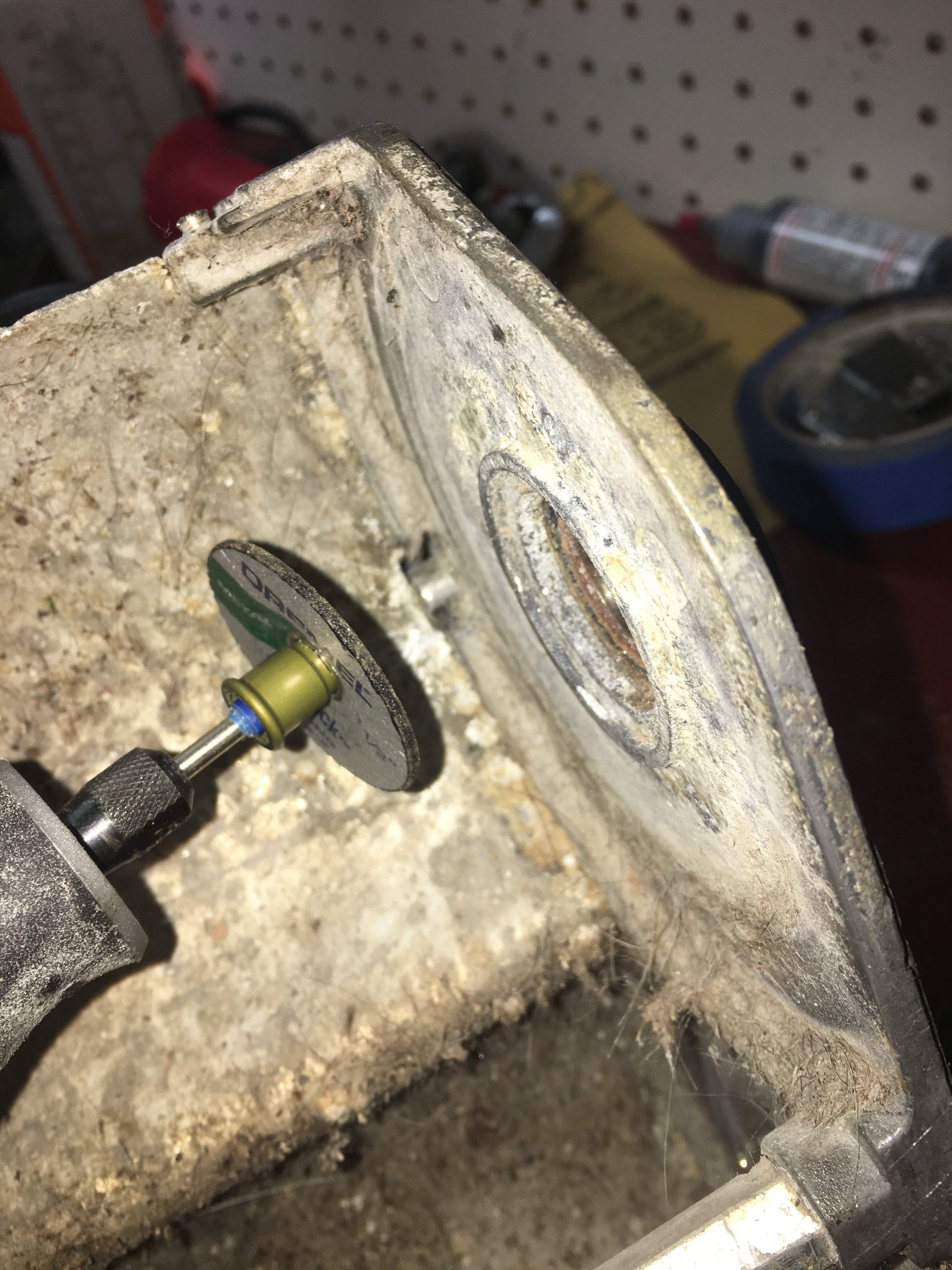

How do I remove this gear? I removed the snap rings, turned it, put force on it with flathead screwdrivers, nothing is working. Am I going to need to dremel all the damn gears off?
Send it to Bill Poole. Carpet Cleaner USA. He can fix it for a price. Plus he'll likely find stuff wrong with your CRB that you did not suspect.
