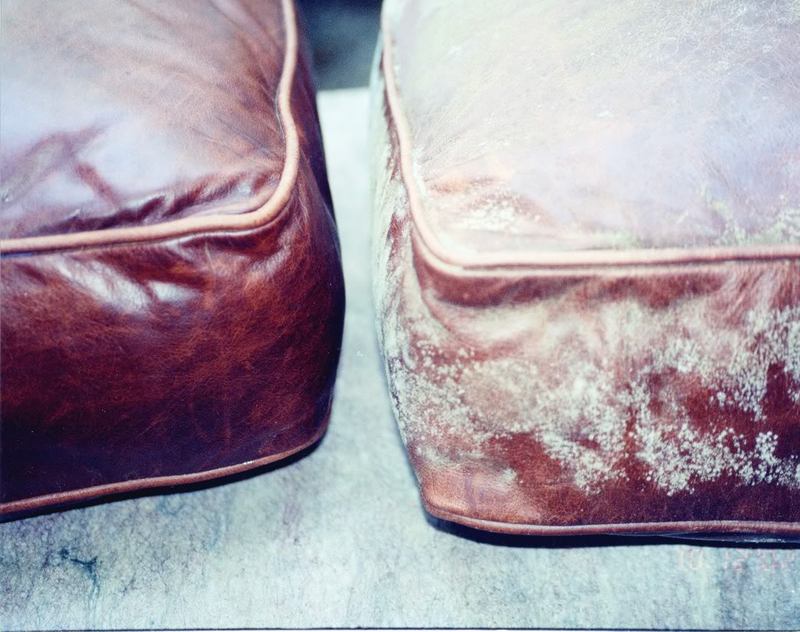

As for its use, I can use it with anything that can take some water. I also use it to clean 'Dry Clean Only' materials such as drapes and I also use it on leather and many other types of items.
Here is an example of cleaning some rough aniline leather with the vapor steamer; one on right is before the left is after cleaning
The material and fiber will determine if I use a towel, a screen or a brush which I will use if someone has left lines from their uph tool or if someone has not properly brushed out a natural velvet. This will allow me to realign the lay of the nap.
As with everything, try to test in an area out of the way to see if there will be a problem. I have had a lot of success with it for many years, great tool to have when needed.
