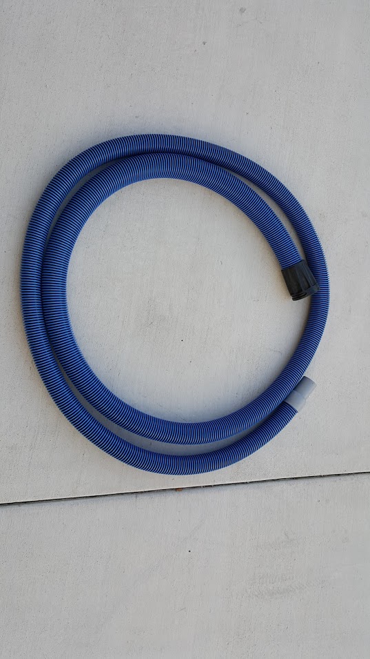

Do you use a whip hose with your wand?
117,349
If so, give your PMF dealer a call.
15 feet, tapered..

Do you think the taper noticibly improves vac performance over straight 1.5"?

I've been using tapered whip hose for years. It's like using an acid rinse. I can't prove it helps, but I ride on the side of caution.
15 feet, tapered..
The 15' tapered hoses give you quite a bit of airflow improvement over the 2 inch reduced to a 1.5 inch whip but all the ones I have seen or used are a single ply hose that just will not hold up to the everyday vacuum and heat of a truckmount.
These hoses are typically used on car wash vacuums.
Let me know if this one is a 2 ply hose but I doubt it.
15,253
You can buy that hose at dultmeiers online.

A cheap tapered whip would progressively change diameters if it had to be trimmed.
50,041
I've been trimming the one I have now for years. I keep wondering how long before the cuff won't fit.
