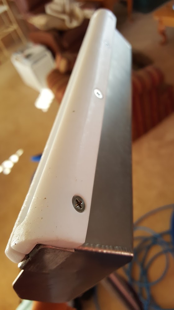

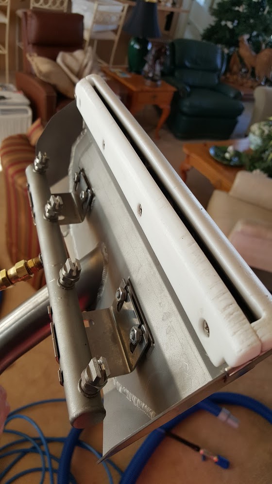

Looks to have good bite but do you have ability to flow and flush.
I knew it,
Thanks for coming clean nod doing the right thing.
What is your flow on that toy?

I use my steam way wand a lot on heavy soil, Love the flushing with K3 flood jet and the 1.5 pipe works fine. Pretty easy to sling around
As mentioned the number on the flood jets needs to be doubled to be equivalent to a normal wand jet for flow rate.
3 = 6, 1.5 = 3, etc.
I don't use the Steam Way wand now that I rotary jet extract, but otherwise it would be used most of the time to compensate. 6 flow at 2 inches from the surface makes for high impact clean & flush and at higher temperatures, especially with the protection shield. The smooth design shape of the vacuum allows for good cfm through a 1.5 inch wand.
Using that Steam Way wand with a kerosene burner is what made me slow to adopt rotary jet extraction. Even then I got tired of sometimes needing to chop stroke. Eventually took the easier route.
