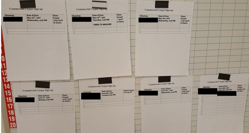

We have a couple of busy weeks of commercial work coming up. All of it encap but don't tell Jimmy! :winky:
