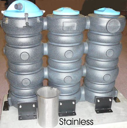

Just received this new 80 Gallon rotomolded recovery tank :
Nice thick cross-linked poly tank w/2" intake. I have no doubts it will withstand 20" hg.
The large SS filter basket was well designed and the floor brackets were very sturdy.
The price is less than an aluminum tank.
The age of poly tanks may be near.

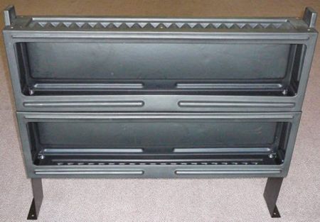

I also received this rotomolded shelf:
You can add more shelves for a taller space.

I have decided to go with that for any TM I ever buy from here on out... Are they going to make them with 2.5 hose inlets by request? Could you link two of them together if you have a box truck?
When buying a new TM, would using this tank instead of there's void my warranty?
That tank is sweet!!!! With the cost of metal as high as it is, the design and materials used are perfect!!

I'm gonna go with Yes to all of your questions at this point, if for nothing else, a 2.5" hole saw is only $15....all things are possible.

That's one butt ass ugly looking tank. But I guess if the price were right it could grow on me.
How do they compare in price to say a plastic tank made by John's Custom Machine which are pretty pricey.

Alrighty Brad Pitt, lets have a look see of your waste tank?
I think it looks fine, and would look even better in ALL black.

There will be optional left and right reliefs for wheel wells. Also, 2 1/2" inlets. We are also going to make the vac tanks all black. Like Larry said the tank is very strong. one Dist. tested it with the relief valve off and ran it for 20 minutes at 26 hg. Finally he had to shut it down not to damage his blower. The tank was fine. As they say, beauty is only skin deep.

That is very ugly and cool in a Lost in Space kinda way. I had a plastic tank for my TM temporararily. I had to put braces inside of it to keep it from collapsing, which it eventually did anyways, but it did work quite well for a while. It wasn't built nearly as well as this one looks.
I used to get shocked pretty good with static electricity though.

whats the footprint of the tank?
If memory serves it's about 18" x 54", I just estimated it took up the same area as a 100gal square tank. Maybe Larry will hit us with a few measurements.
As for maximum holding capacity, I'm gonan take an educated guess with the baffeling, that it will peak at 72 gal, but that really is dependent on the cfm you are putting through it.
As for float switches etc... See those "flats" on the sides, any one of those is where you will mount bulkhead fittings for floats, bypass, sensors etc...
Fresh tank? that's easy, John wouldn't even have to cut out the other two lids for a fresh...heck he should have released fresh water tanks first...lol
Keep in mind, it's still being developed, it's not "perfect" yet.

As some have seen the new website is up but needs some work. What Jeff said is correct. We are also making a riser for the rear cylinder of the vac tank that will not only add capacity it will allow for elevated atttachment of blower fittings. The tank will come with the riser now, so if anyone has the tank let us know and we'll send the riser, no charge. Check out the website and let me know what you think.

For this market, I don't think you need much more capacity, just a good redneck pump out....oh..and go to a full 2" drain.

I'd make a compatable deep shelf for the bottom row... Deep & tall enough to hold a 5 or 7 gallon tote/pail of juice. I'll take a free one for the idea. lol

I have some poly fresh tanks that are over 20 years old, and have been in 2 different vans. They never are a problem, and will probably last another 50 years.
They are lightweight, never rust, pit or corrode, nor do they need to be re-welded - ever.
I think you're on to something.

Have you tested in a working environment. AKA at 120 degrees ambiant temperature. That's got to make a difference in the flex of the plastic.
BTW - Very impressive. I wouldn't be surprised if the more innovative TM designers are using them in a couple of years.
