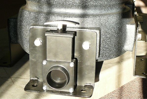

Scott;
The tank height is 48".
Here is our 2" dump valve w/alum. handle mounted below the tank bottom:
Larry
