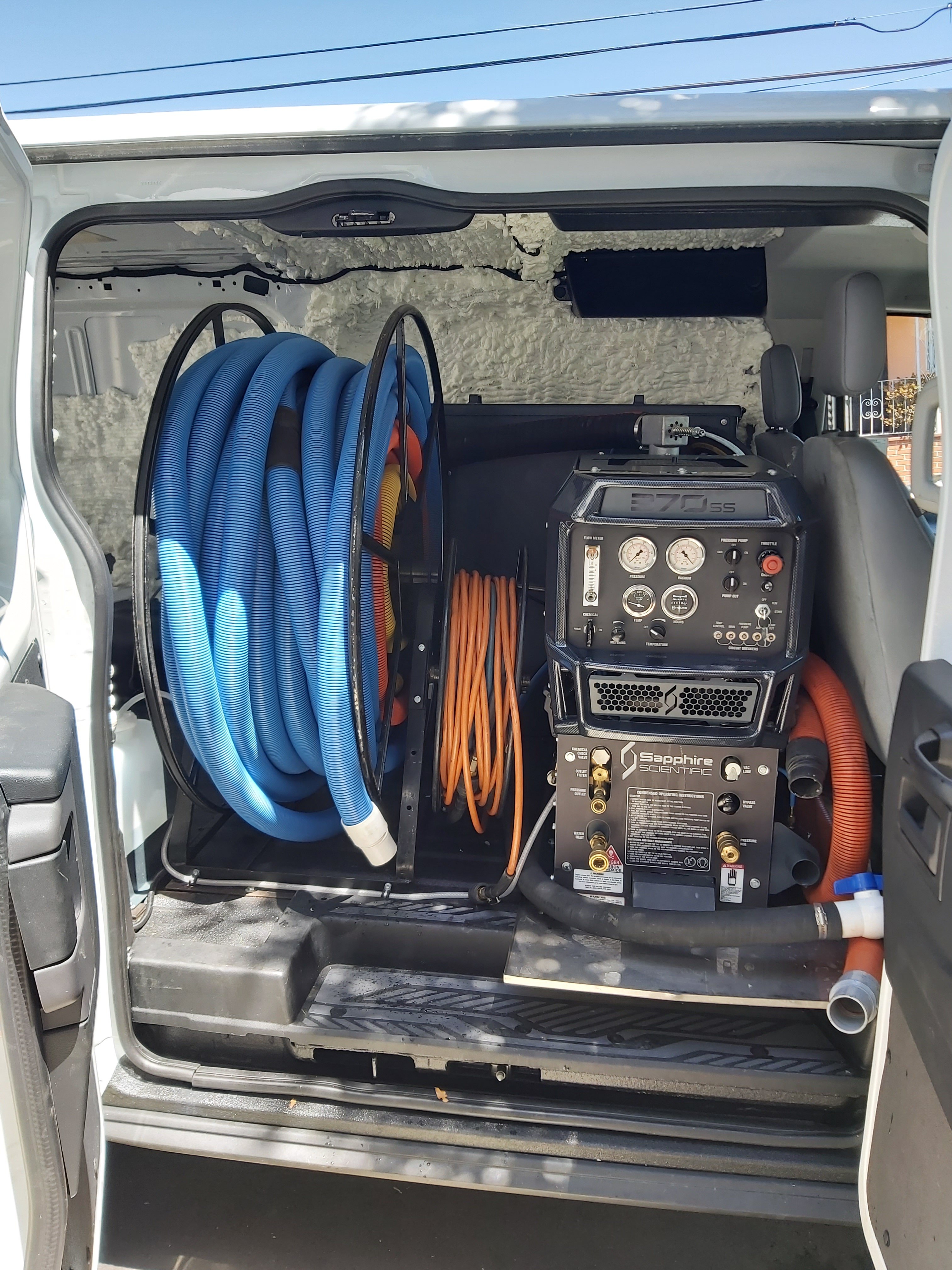

I went from a Vortex to a 650 a year ago and still miss the power and reliability of the Vortex. I hope you’ll continue to post your thoughts on the 370. I like the way you’ve set up the machine and reels all from the side door. Maintenance on the 370 looks challenging with the tight fit between the seat and hose reel.
Removing the solution reel is easy, vac reel doable. the seat moves out of the way. and I'm a small guy.
I'll be moving the oil drain hose to the front of the machine with a shut of valve.
The hot water dumping valves will be rerouted to the freshwater tank.
I still have another van/tm on standby as a back-up.

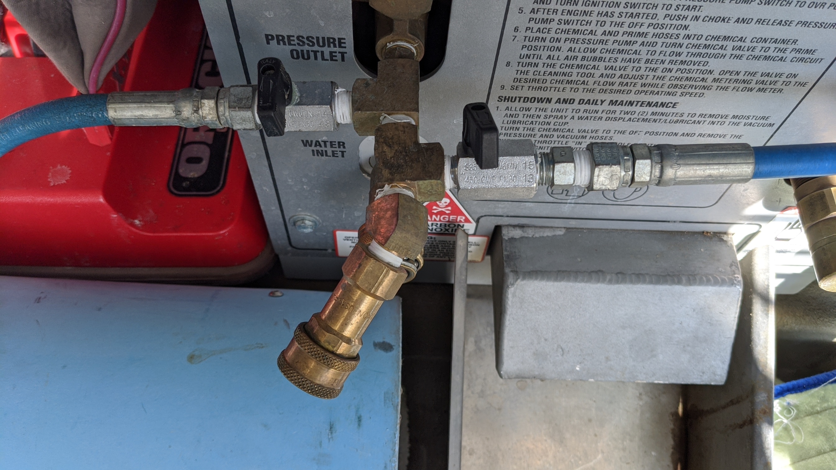

Put a two-way splitter off your pressure valve to the right it goes to fill the chemical mix bucket to the left as a convenient hose..IMG_20200808_081526.jpg

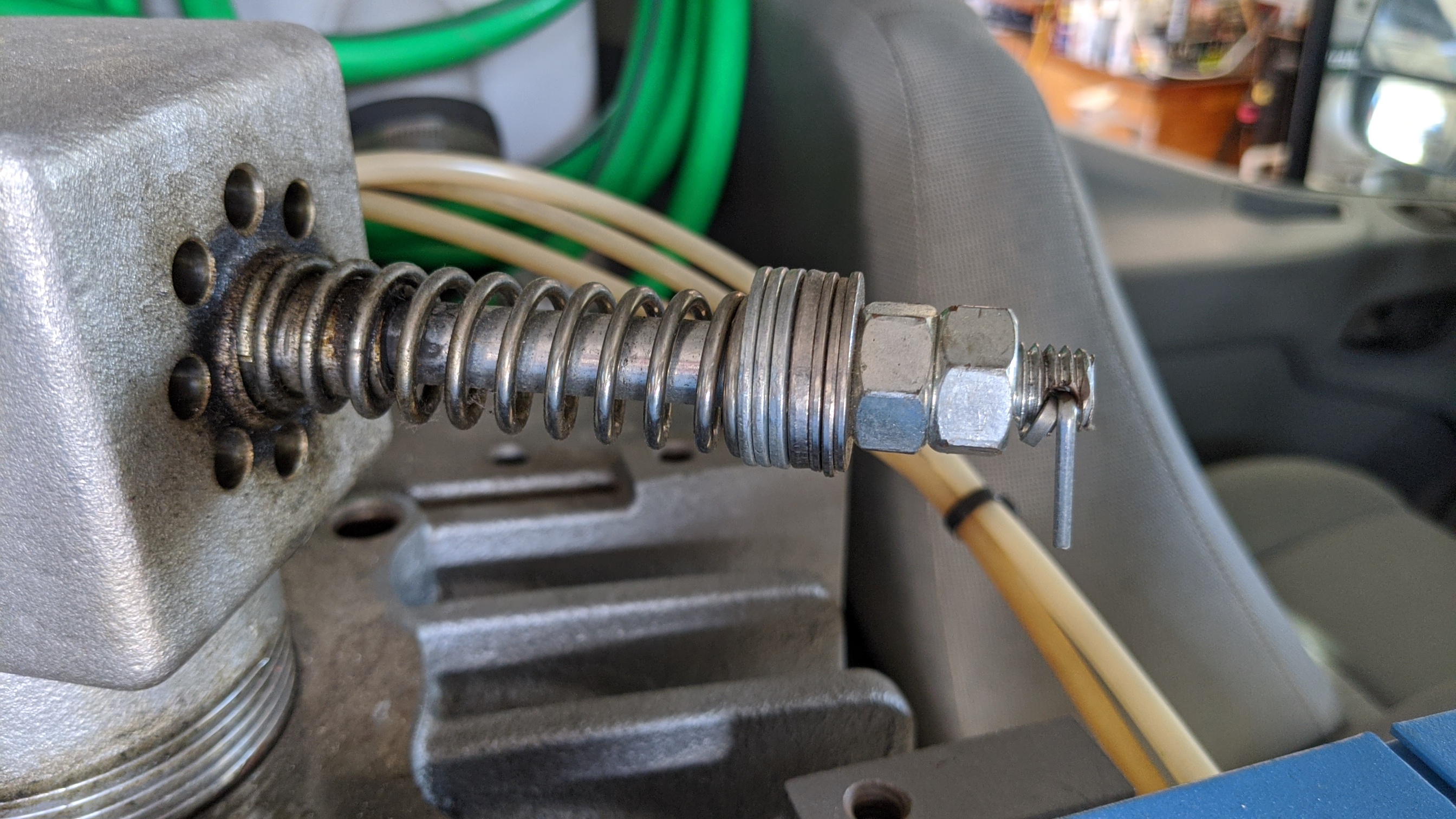

Adjust your vacuum relief with the need of the amount of washers You put 100 ft of hose on it with whatever leaky cuffs you're going to use put your wand on it put it on some normal carpet and adjust it to 14 in of lift at that point
