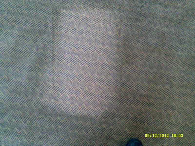

Just an emulsifier, no prespray did this. Double wet pass, double dry. For those NOT using an emulsifier in your rinse:
A) - What aren't you getting out?
OR
B) - Why are you working so hard?
Hold the canard about "residue", at an ounce or so per 5 gallons RTU, with an 80% or better recovery rate, that's a red herring.

You have to make 4 passes?
We typically prespray with injection sprayer and clear rinse ONE pass and DONE.
It's all in the technique.

I can do that with fiber rinse and a pass with the our TM. What type of emulsifier are you using/ suggesting anyway?

another porty guy saying the same thing..
are you BSin or do you pre spray with your wand and rinse agent/emulsifier?
I didn't say I don't use a good prespray too, although mostly on traffic lanes, but my point was a quality prespray in conjunction with a decent emulsifier, you will get the carpet cleaner.
