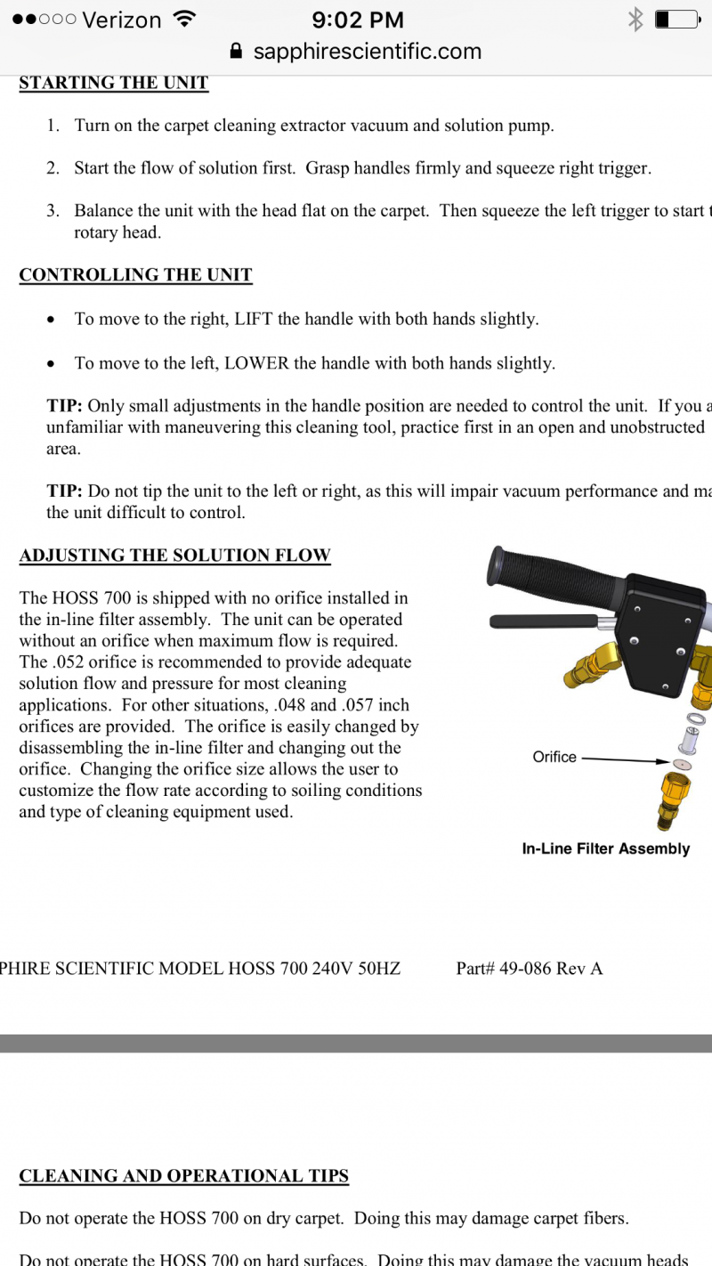

Put the disc back in and shorten your hose run to 25 feet. Flush going in hoss and wand back out on drypasses for best possible dry times.
I found the disks hanging in a baggie on the HOSS-- duh...haha
Ill be sure to install them if ever used with a porty again.
Reflecting back-- maybe the job would have been finished faster if done as you suggest..
I think this is first time using the HOSS with 2 vac porty so we learned something on this job.
