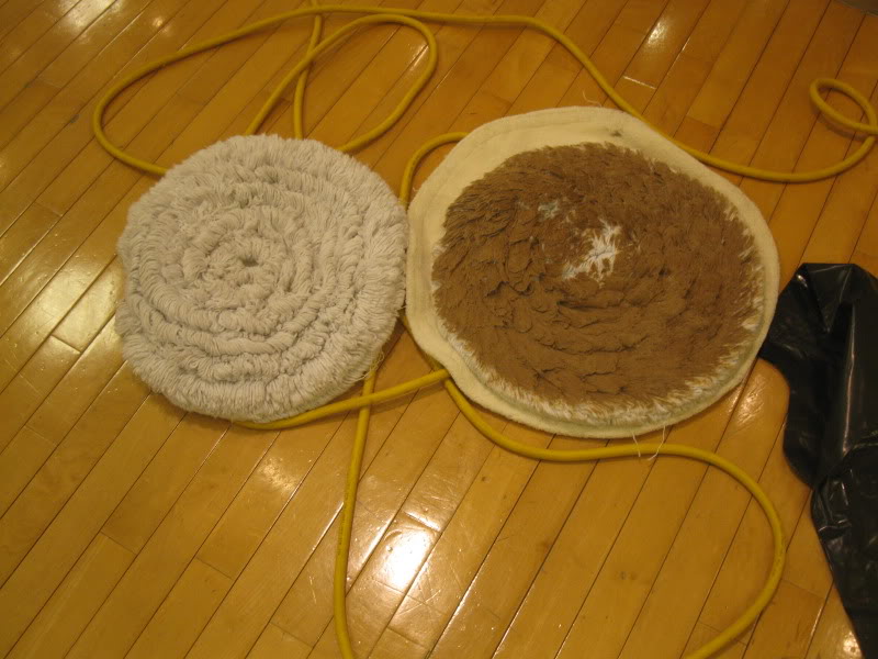

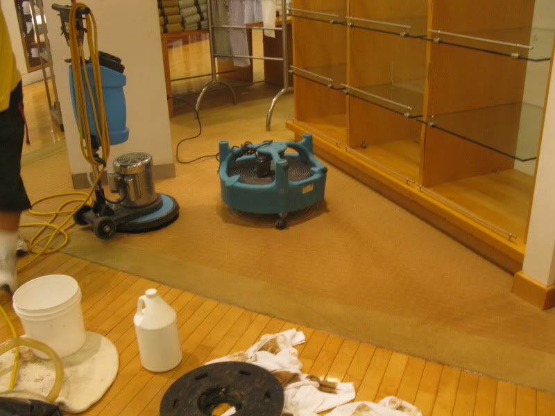

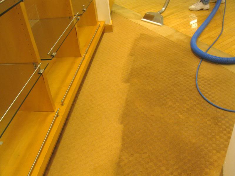

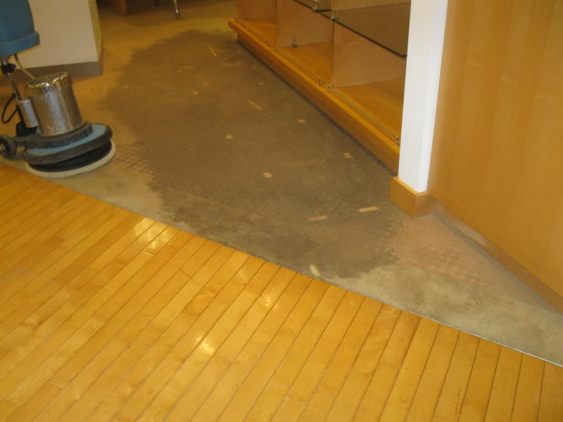

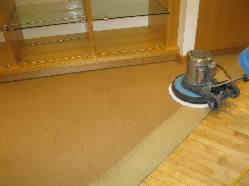

You can not get more grease than this... a commercial kitchen hood cleaning co. made a mistake
and all the crap when down the a/c ducts two floors down to a store's carpet.
First night encapped with VacAways Hot knife. It wicked back after drying.
Second night extract with hot water only and encapped again and dried.
It did not wicked back again.
Luis

No, the water guys where there before me. The carpet was bone dry, I used the 175 with Hot Knife
and a brush first, then used the bonnet since there was so much grease to post pad. The next night
I steam it first then encapped againg and post pad with the bonnets and dried. I had to use the brush
because the carpets is a cut and loop glued down and the pads (bonnets and fiberplus) would not
get down to the low areas.
Two floors below, the carpets was regular cut pile with pad and I used the water claw to clean the
pad and then encapped and force dry. the areas (about 12 sq ft) also did not wicked back.
