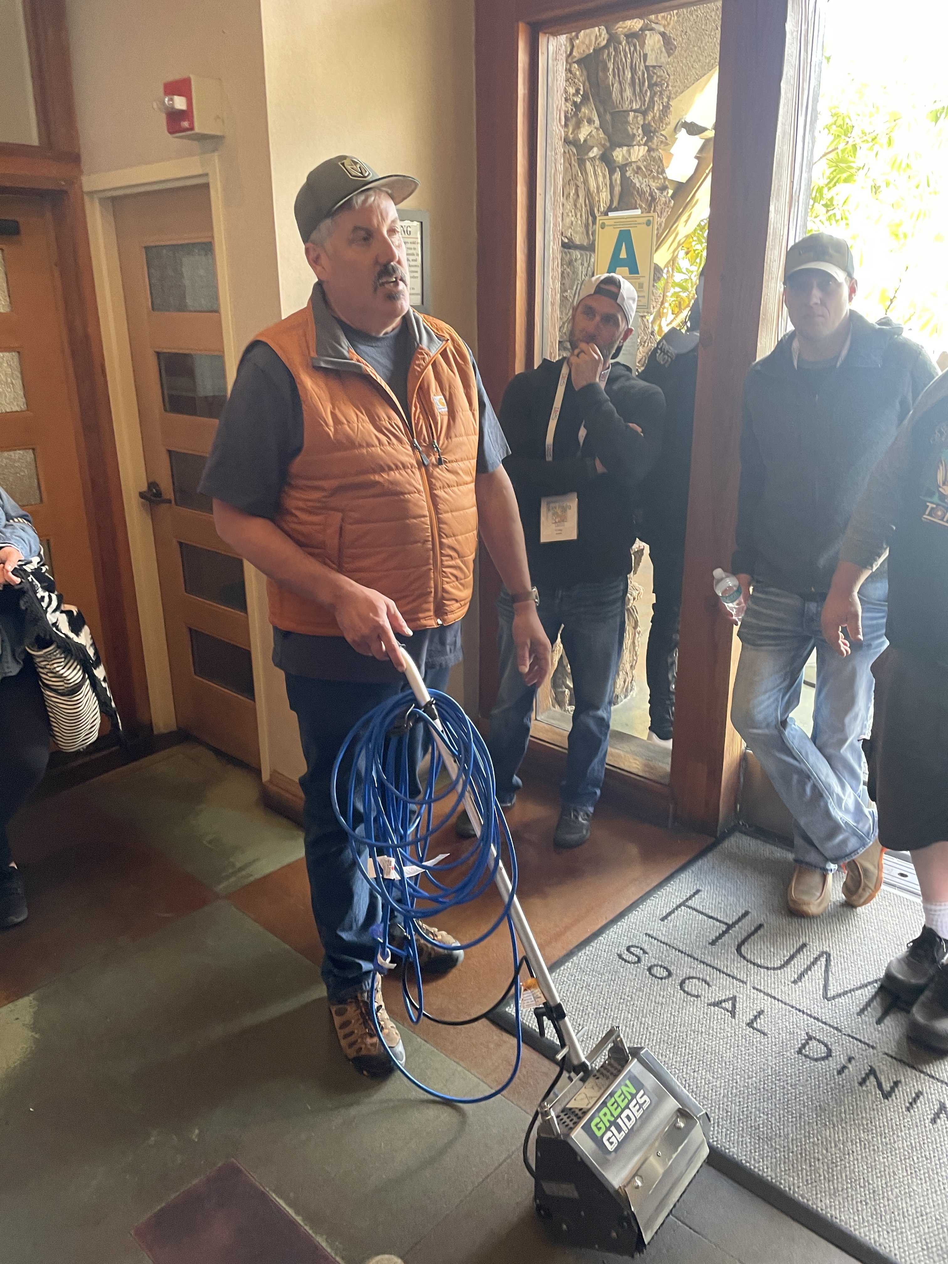

Is this a Zipper? I think MikeyP might still use em

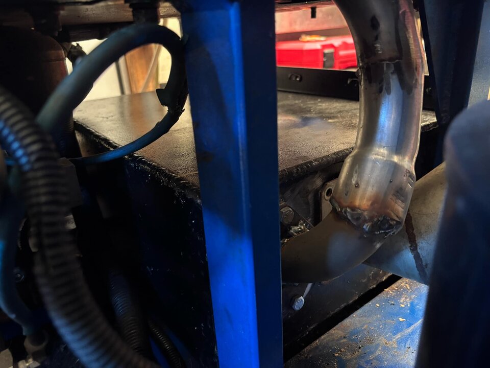

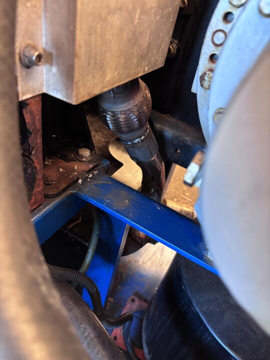

I can proudly say my ThermalWave II does hold that kind of performance after my redesign of the heat exchanger. I'm proud of that Blue beast after all the work I've put in it

How long did it take you to get it done and redesigned?

It took only about a week for me to prepare it and get my welder to redesign the exhaust heat exchanger, and put it all back together, since I've been working in between all of it
That smaller exhaust pipe that’s mounted and welded on the back of that box originally was routed on top of that box, which bypassed heating the water. (Wasted energy). Now that it’s mounted in the box it does 3 things: delivers constant reliable heat over 220, reduced the machine’s temp since it’s mixed in with the blowers exhaust (was 700F on top of the box, now it is 300-350f), and the finned coils act as a muffler which the machine is quieter and smoother sounding.
The welds are rough but the design is great
