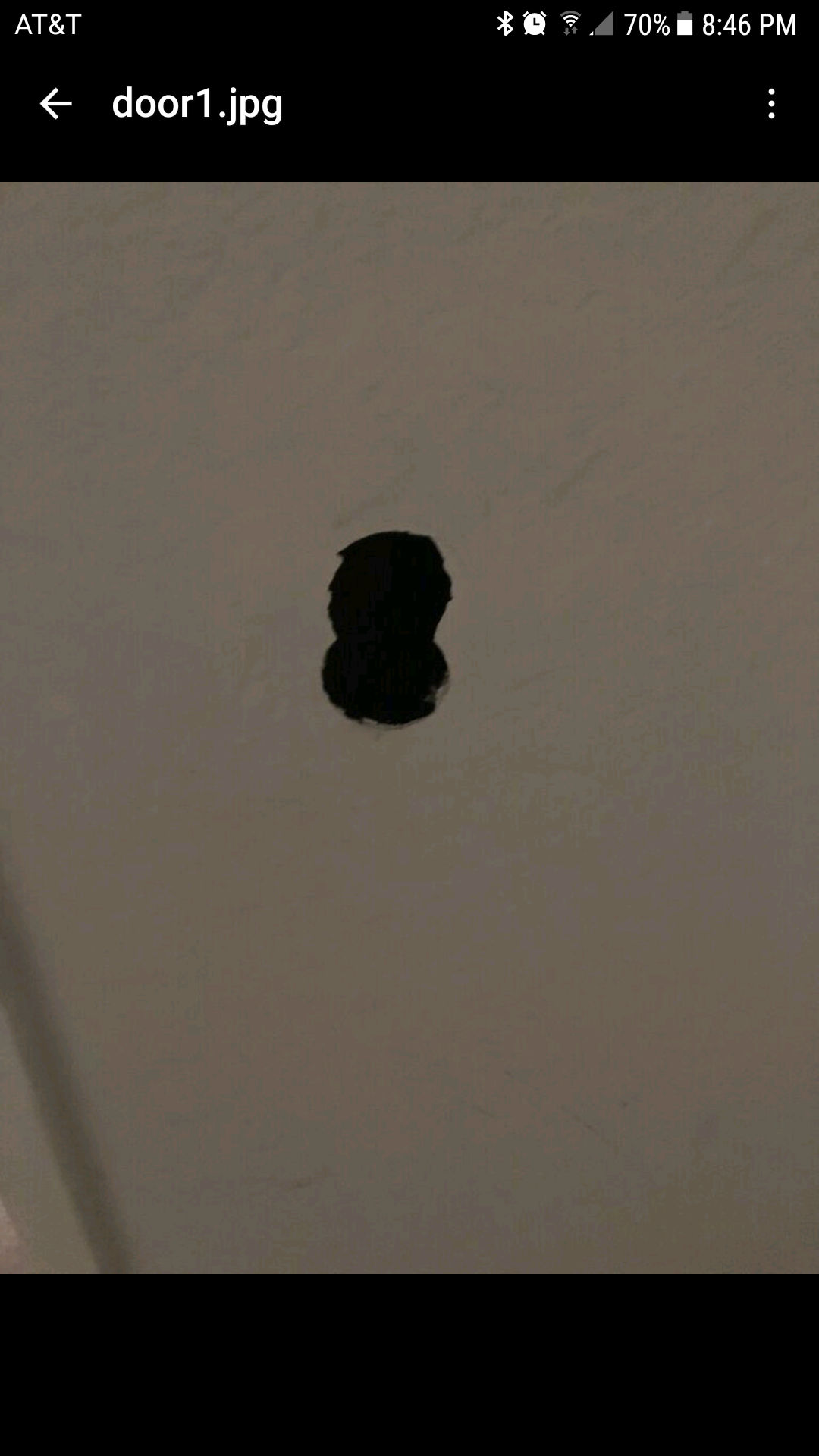

Here are some photos see sent me.

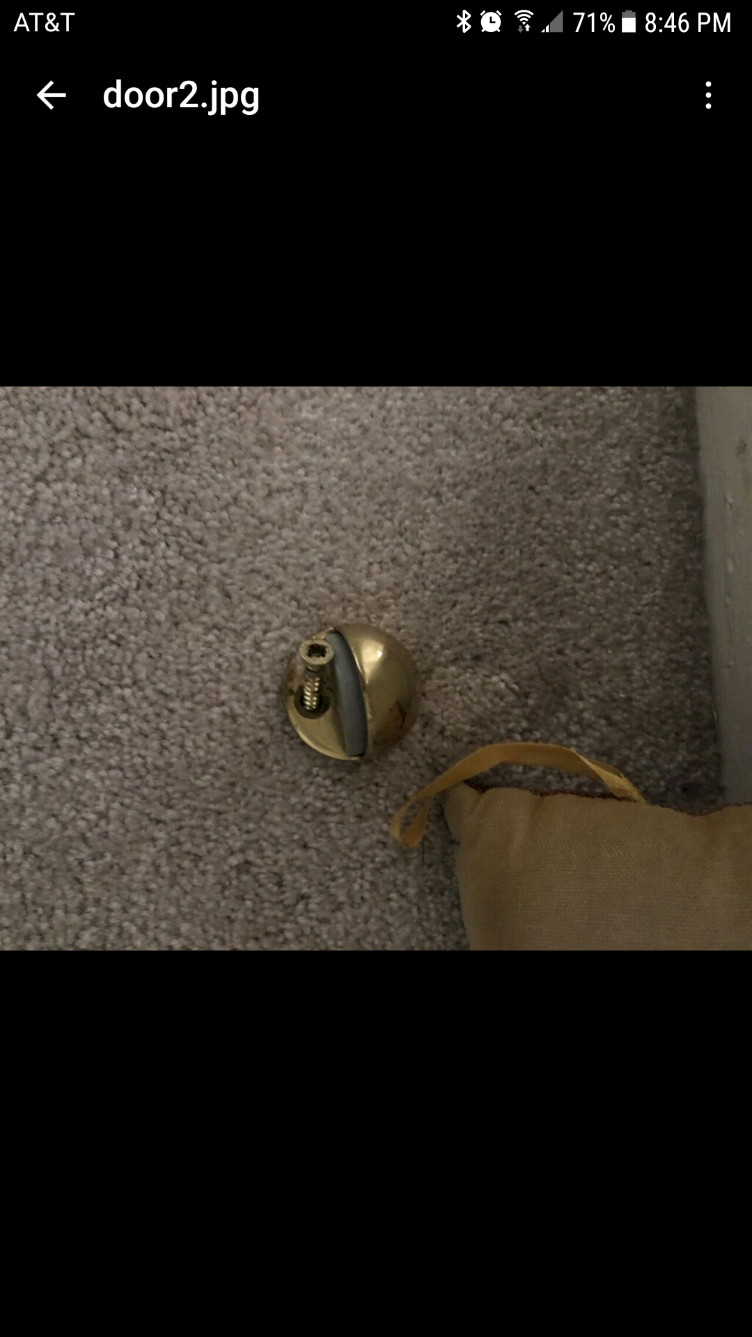

Looks like the door stop isnt secure.Screenshot_20180927-204623.pngScreenshot_20180927-204641.png

Wow, that is a big ass hole, but hard to tell since there is nothing in the pic for scale. How big is she claiming this hole is. That would be a hard one to miss.

Looks to me like 2 holes- or a "double tap" by knob at different levels, which seems wierd. The door stop definitely is not secures properly.

I agree. Looks like the door would need to come off the hinges to make the different level holes or the doorknob was very loose. I think she's full of it.

The force that it would take to knock the drywall completely out of the hole is way more than the hardest incidental hit you would ever make. Someone was really mad and flung that door open. For demonstration purposes take a hammer and punch a hole in drywall.

I would think the hole would still have some drywall dangling or attached if it was a fresh hole.:headscratch:.
The screw for the door stop looks stripped also, which leads me to think it wasnt attached correctly.

That particular hole looks to have been repaired before. The telling area as near the middle where it is narrow. It looks brittle, like the area had been repaired with joint compound.
Me, I would tell the customer that the only way the hole could have been made would have been if the door jumped over the door stop. Your technicians are also required to report all damage without penalty for the incident.
After saying that, I would repair the hole and put new screws in the door stop.

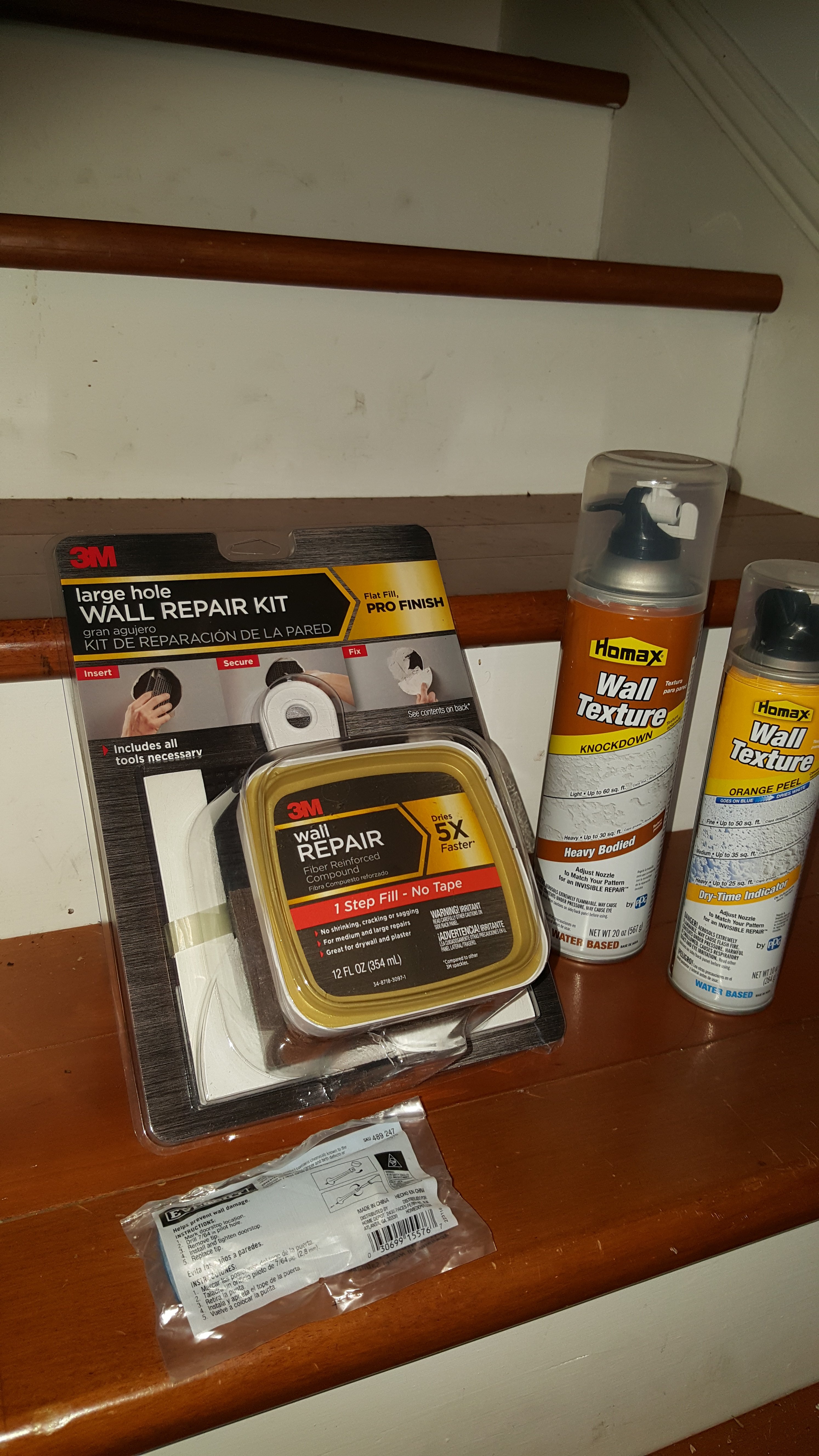

I just bought the supplies to fix it right-- $44. but that includes 2 different textures in spray cans, I'll return the unused one. I'll inform her that I do not believe we did it but I will fix it anyway.
She isn't worth keeping-- but as business owners we have to take the high road.

The patch kit has a foldable plastic screen that goes behind the drywall. Ill also cover the repair with the plastic circle wall protector. And ill install a better door stop.
