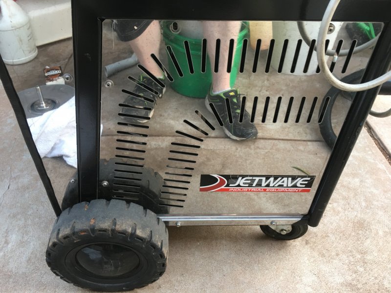

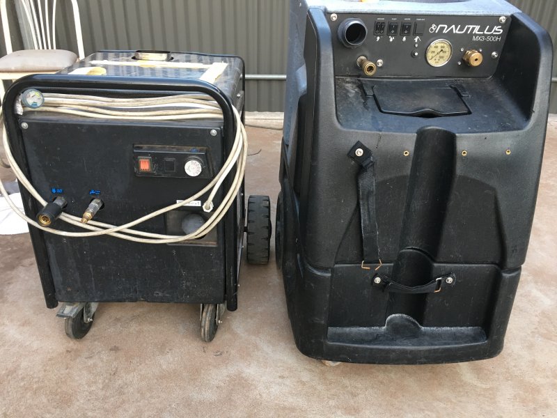

So I am a huge fan of heat. I try never to do jobs cold. Still some tell me that cold water works almost as well and there is precious little difference.
I run a heated portable extractor. A Nautilus MX3-500H and I have recently purchased this bad boy.
http://www.jetwave.com.au/file/Jetwave-Vulcan-Vertical-Hot-Box-Product-Sheet.pdf
So basically now I have access to both electric (which is very reasonable) and fuel fired heat sources. I find the electric heat good; very good - but - the diesel is in another league. It just eats soap and shit. The Hydroforce becomes a Laser Beam at 500PSI and 230F / 110C against spots like food, spew and dog shit. All manner of organics just blast into emulsion.
Rinsing is very effective with both of my carpet tools cutting through the soil load and drying is literally almost instant.
Lets talk heat. My setup is good for 302F / 150C but at that level I just get dry steam out the tool :rockon:.
Heater is good for 25L/m / 6.6Gal/m but will trigger at just 3L/m / .8Gal/m. Triggers by flow not pressure.

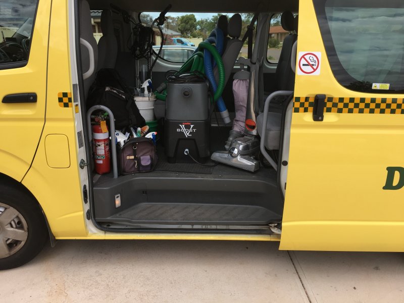

I know a porty.
But its worse.... I turn up at jobs in a taxi van.
It's a funny old world.

I wonder how long the pump will last with that heat some units aren't set up for high heat very nice to have the heat but only time will tell. My EDIC has a outside the unit heat and works okay as long as I change to smaller jets on the wand. jz.

You make a great point.
the pump is on the cold side it's a - push - system. A garden hose fills the 12 Gal tank on the extractor. A short hose connects the extractor's solution QD coupler to the burner - input. The a longer hose come from the burner's - output - to my tools. The burner lights instantly.
GeeeAus
Cleaning Professional
Sep 23, 2013
1,120
Grant Baverstock
That was one of my design goals. Must be a push system.

There's a team of 8 drivers. 4 day shift and 4 night. They just charge whatever the metre is. But the stop the metre for loading and unloading which is great that's a HUGE saving. Average cost is $9 each way, $18 round trip.
Average ticket total is $200. so just under 10%

If you could place the heated unit at the front outside connection and just have the heat only run from the outside hose to the wand your pump would last much longer as long as the heat is hot enough. jz.
Reactions: GeeeAus
GeeeAus
Sep 23, 2013
1,120
Grant Baverstock
You got it in 1. Thats exactly what I do.
