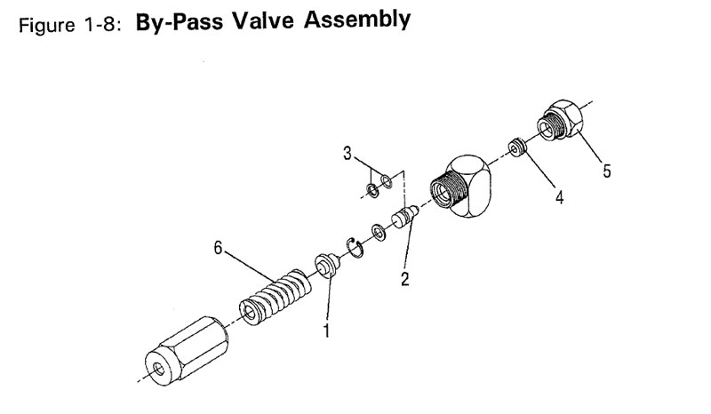

any numbers on it?
and I assume since you say no diagram you checked the suttner site?
http://www.suttner.com/schematics/index.htm
hey fred no specs on it i was trying to find it but nada then i determined to find a picture of it and i found 1 on interlink if i were to install it how i think it should be will it damage my pump?
My model or look alike is not even listed
27,076
check to see if part 3/4 (same as 7/8) remained in the assembly..its still plumbed inline right..you probably aren't actually missing them
edit: and you might want to print that schematic in case that link disappears too
edit 2: There is also the possibility that 7/8 isn't used in an updated version. I say that because the link on suttner that is broken is in a subdirectory "New_050609"...which I assume is a date.
The schematic I linked to is dated 05
my money is on 3/4 still being in the assembly though
Thanks again fred your a life saver!! there is already o-rings on the piston so i should be fine
