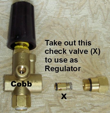

does it look like this one..........????

Looks the same but with a blue spring. Not real familiar with the internal workings. Is that the check valve that is disasembled there?

Nevermind, just noticed the text on the top of the pic. Should I remove that valve? Maybe I'll take the old one apart to see if its been removed from that one.
Feb 26, 2008
237
Thanks for posting the pic, Jim! Took my old one apart, no chk valve, so removed from new one and good to go!

Photo showing the correct terminology:
Unloader becomes a pressure regulator when check valve is removed.
Pressure is not locked in.
