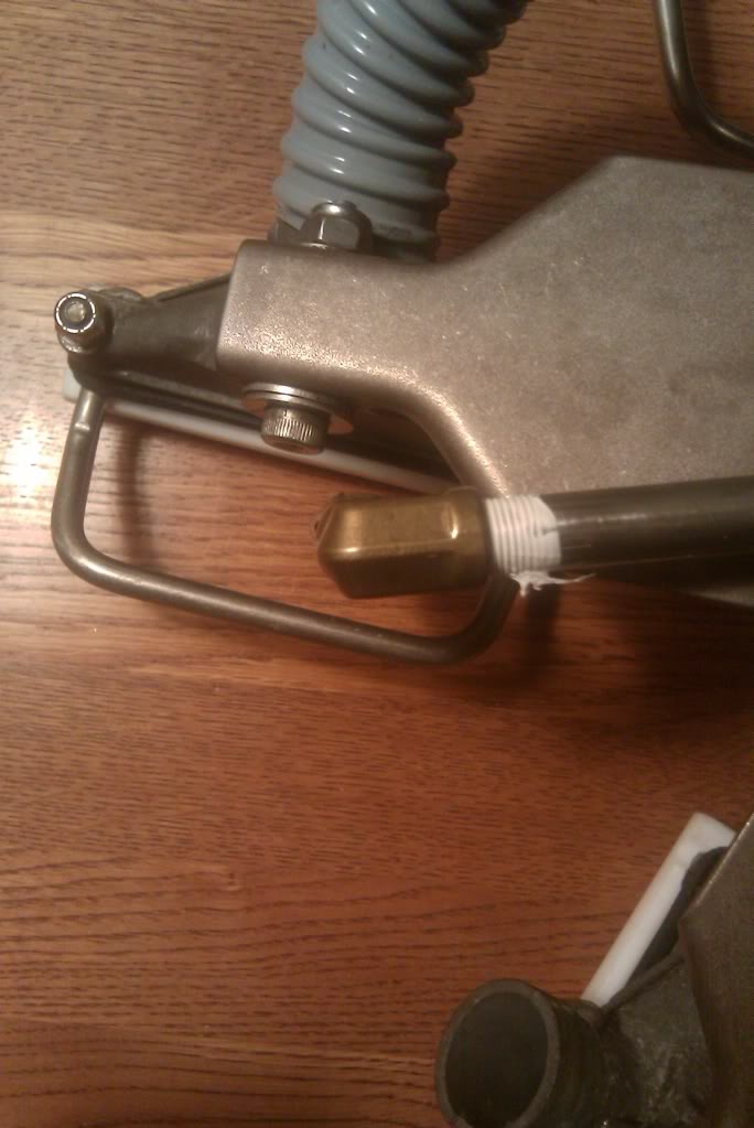

you can lower the jets with the extension check valves....
pending how low you want to go..and your jets..there are 2 different lengths.....
these are the long ones......

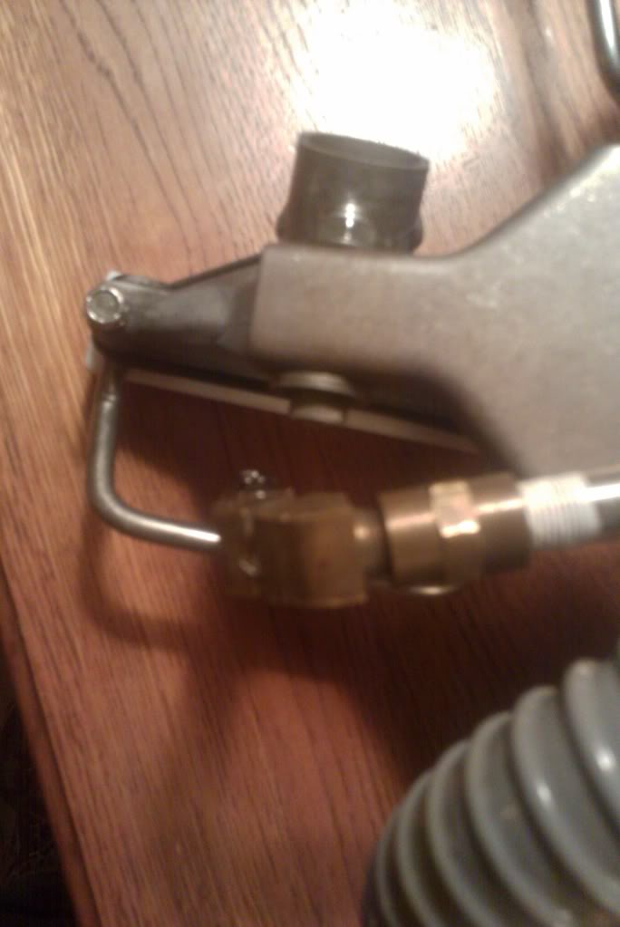

I ran 80015 with the shorter extensions before it finally blew up on me...ran that configuration for about 2 years...seemed to be the best set up for me....
Sep 7, 2008
3,797

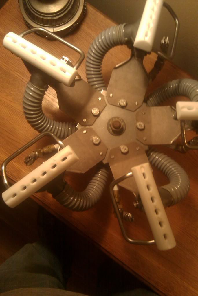

I used different elbow so a few of the jets would hit more towards the inner part of the vacuum and the others would hit towards the outer portion of the vacuum. I could not get them line up dead center. Also I like the glides because they pop on and off really easy so you can run with or without depending on the job. I run 80015 jets.
