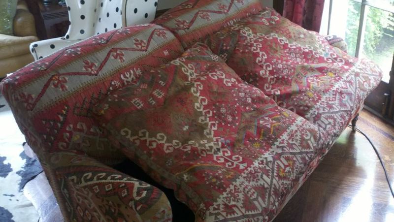

Earlier this week I did my biggest residential job for my company.. all the carpet, upholstery & area rugs. Included was these two gems that I have never ran across in the 10,000 plus homes I have been in over that last 14 years. It was a wool couch that hasn't been cleaned in approx 15 years, it was in their formal LR. The previous cleaning was of the dry method she said and had a sticky residue on it.
I prevac'd it, pretreated with some Trashed Green, then did the extraction on it.. I was able to bring to color back and remove the residue with zero shrinkage.
You guys clean these often?

We clean these all the time they're just not that bumpy.

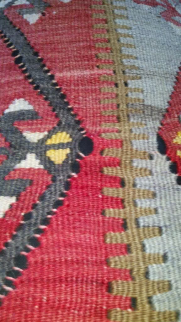

Slit-weave Kilim/Ghilim(gilleem)
15,218
Ne
I cleaned some furniture like that years ago.
Didn't know what it was but I cleaned it.
Did the color transfer, wool etc, no problem.

As easy as cleaning a dhurri. Alot of the kilims I see are darker colors. Not much of a bleeding risk. Neither are popular around me any more. I think i have one customer who still has a dhurri.
