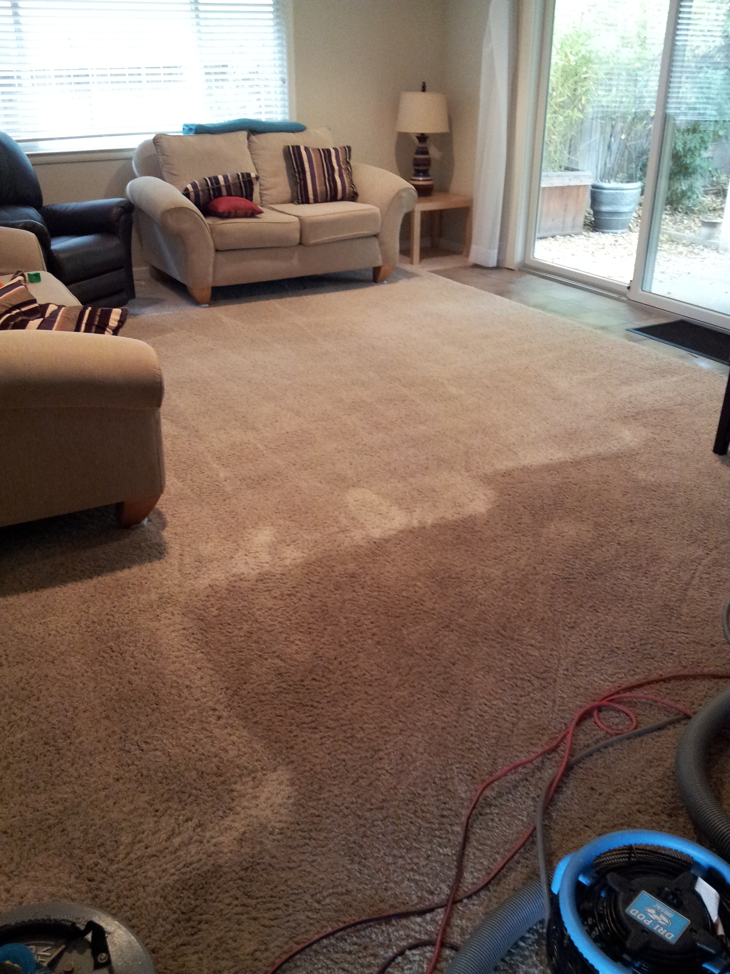

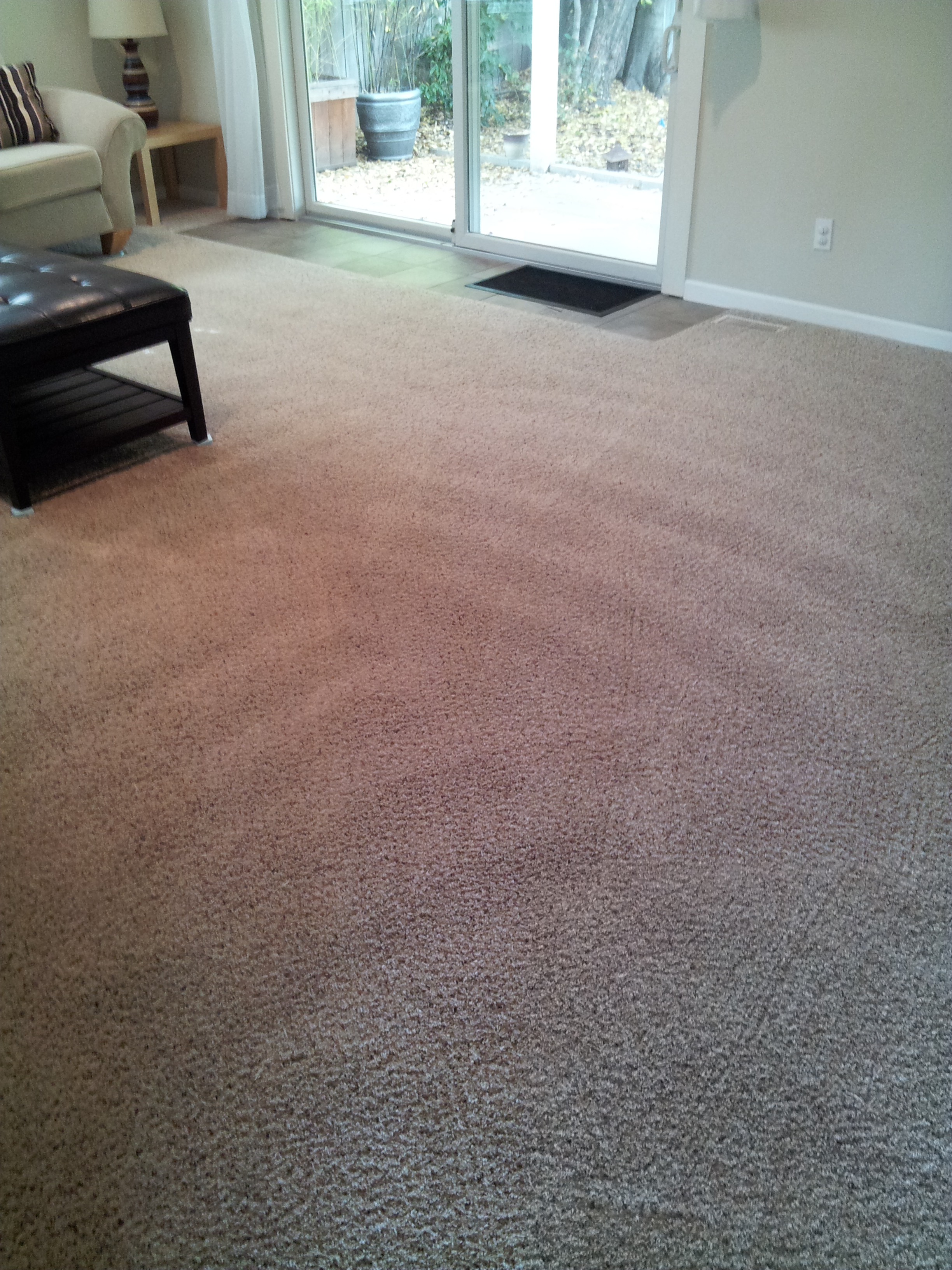

Here's a picture of a job I did recently with the Hoss. The customer had a big dog and the Hoss did a good job of cutting through the grime in the carpet. It lifted up the pile pretty well too.
I don't like the lines the Hoss is leaving in the carpet. The lines don't rake out. It doesn't happen on every job. What is causing this?
Now THAT looks like streaking. You should probably go over it with a 360i to remove the streaking.

you may wand to check you vac ports..
I've never seen the Hoss streak.
Draper has once or twice.
How many clean passes is that?
Jan 17, 2007
38
I did two wet passes and three to four drying passes. I'm overlapping by a third or half on the wet passes.
Is it streaking? Streaking to me would mean that only part of the cleaning path is getting clean. That shouldn't be the case since I'm overlapping my wet strokes and doing lots of drying passes.

I think any RE will need some time to play around with it. I'm much faster and better with my 360i after committing to it and spending a lot of time cleaning with it.
Could be as simple as moving too fast. It really helps me to slow down a bit and keep the heads (vac shoes?) planted evenly on the carpet.

Maybe my screen is different but I don't see the streaking will look at it again on my pc but on my iPad i don't see streaking, just the hoss pattern.
How hot were you running?

Its not streaking....If you pre sprayed that area and recleaned it with a wand you would still see the same thing ......every rotary will do that if it is not setting flat and you bring it over with the nose pitched to high....it will push the pile and give it that appearance....
not all carpets will do this..you see it more in CGD..you can minimize it by keeping the head as flat as possible........this also helps not to rip seams....I have gone over a ton of loose or buckled seams and have never rip one yet....don't dig the machine in...set it flat and let it float.................

I agree with it not being streaking, but how long does it take to have the heel marks go away? I like the wand marks myself. Not so fond of hoss pattern.
