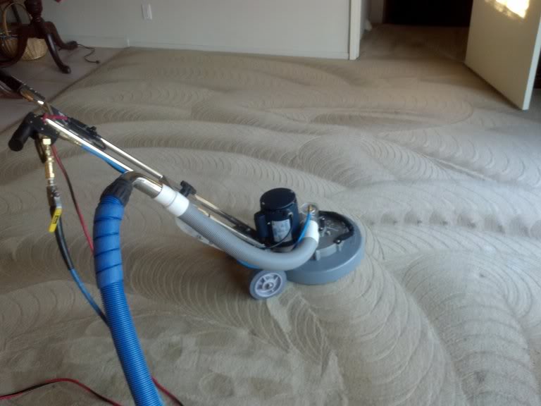

ol' Cartright tore right through this ultra thick nylon pile
It was loaded with Stanley residue
Two passes and just like new
I'm seeing quicker recovery compared to the 360i but I cant really say which one is putting out more water
My short tech cant see the sight tube at all, I'm gonna have to put one in the middle of the vac hose for him
The 15 inch head is noticeable more productive as is the power of the 1/2 horse motor

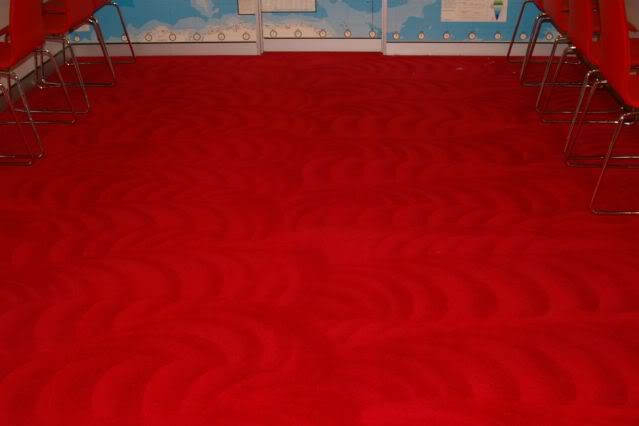

Some clients love the swirls..........................
Especially corporate clients AND their customers.

Please explain the more productive part.

Something don't look right.
If one of my RX-20's left scratchy swirl marks like that i'd send it in for repairs.
I like my swirl marks to have a nice smooth finish...

Maybe I've been smokin again... :oops:
Let's ask Martin...
Hey Jim,
does that swirl pattern look right to you? If it were an RX i'd say one of your jets is plugged or you got a bent skid.

Rx is not that bad. I have some customers that would die on the spot if that saw that mess before I could groom the carpet.

Put it in a pan, pull the trigger with no vac attached at 450 psi for 2 minutes and then measure the water. divide by two and that is our gpm. I say two because you will have immediate drop off after you pull the trigger I think.

its not bad..but it does look like who ever is running it does not have a comfortable grip on it and is tipping it a bit to hard with they lift and lower for it to go different directions and the housing may be dragging a little...
or something is dragging some where...I do not think the jets have anything to do with it...never the less it still should just brush out real nice.......

And yes that is the ugliest mess I have ever seen. Looks like shit and I would be embarrassed to call that my work even if it does groom out.
