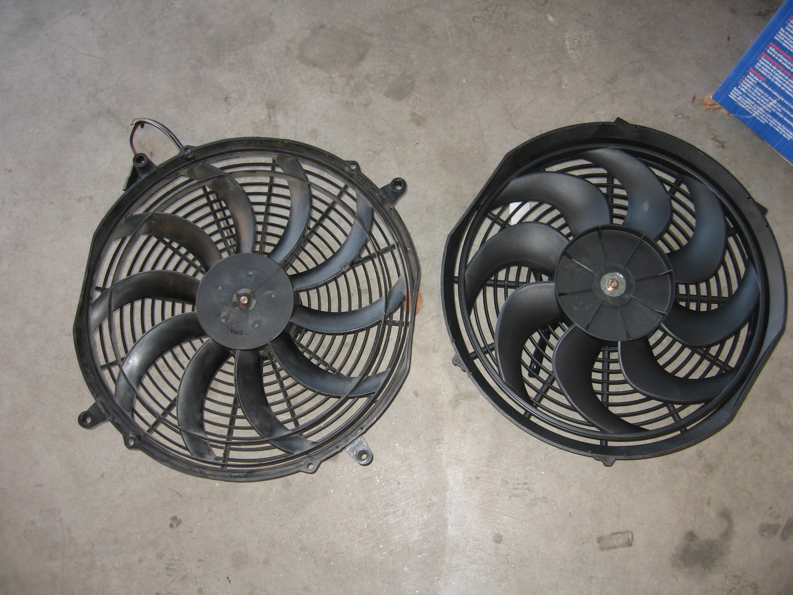

Well wasn't sure how well that radiator performs. Ik the thermalwave fan would need to be upgraded to do so.
the very first summer my machine ran I had to upgrade the fan to pull more air through it to keep it cool...the stock fan would not pull enough through and it would over heat...once I put the new one in...it has never over heated since.....so I would be careful how my I obstruct the radiator.....
Those fans do need to be replaced sometimes.
I also removed the grill to expose the full radiator to help with cooling.
Jim Martin
10,877
Jim Martin
this is the one I like....TorqFlo from Auto Zone...part number 733690 ( on right )
fins are bigger and tilted inward more and pull a lot more air into the radiator...
