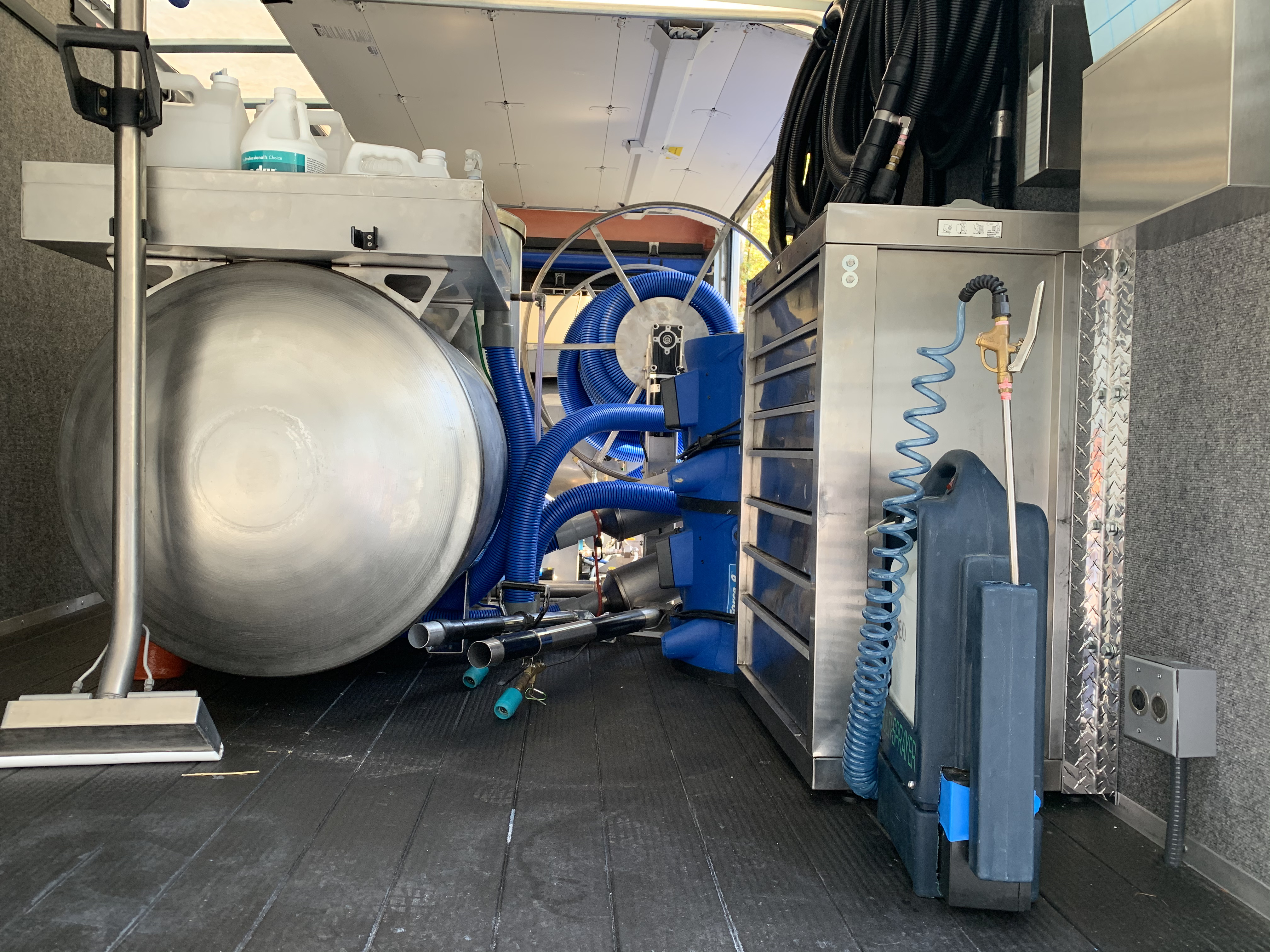

Then Ashley had the right idea for this..instead of using using portable, he retrofitted portable to be connected to to TM. It came equipped with auto pump out so nothing went into tm tank.

I like the Aerotech for the inline filters and the round bottom tank. It drains completely.
