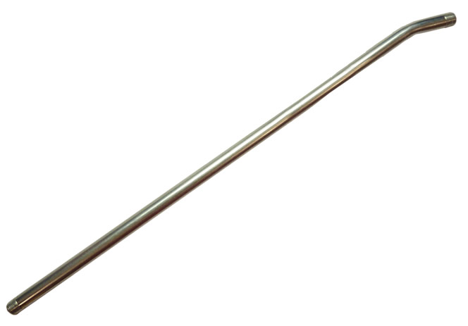

Difficult to maintain. The shaft in the old ones was hard to reach in order to grease. (For those of us that were not blessed with maintenance crew, like some in the north west.)
I posted this before. If you're frugal you make your own from a piece of tubing. No more difficulty.
