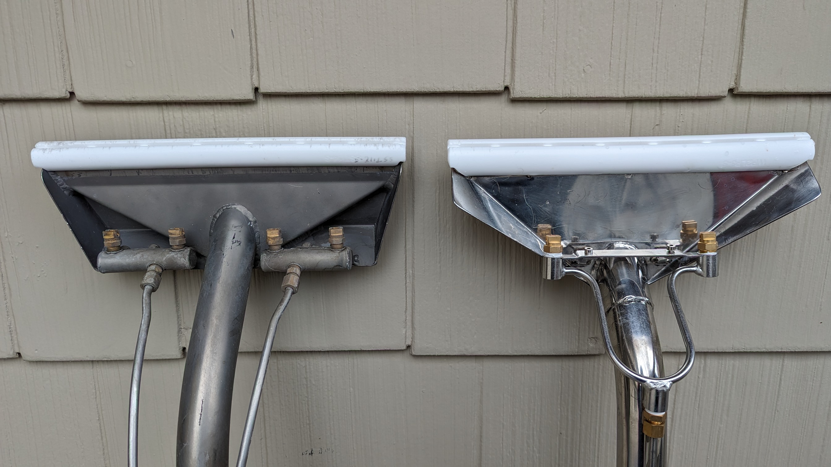

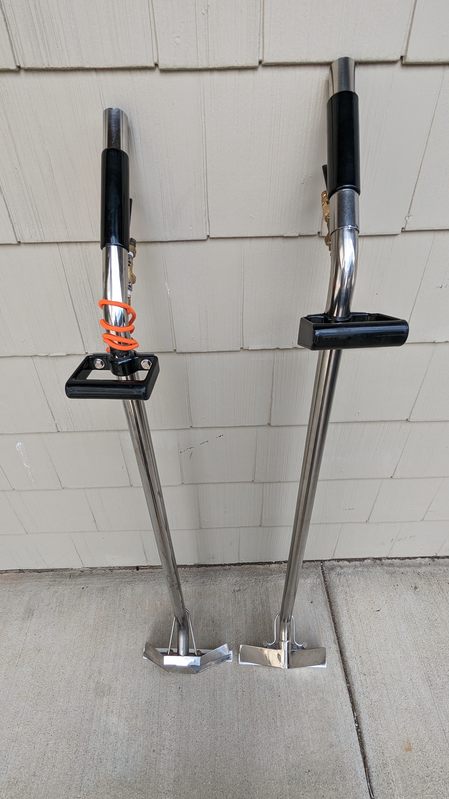

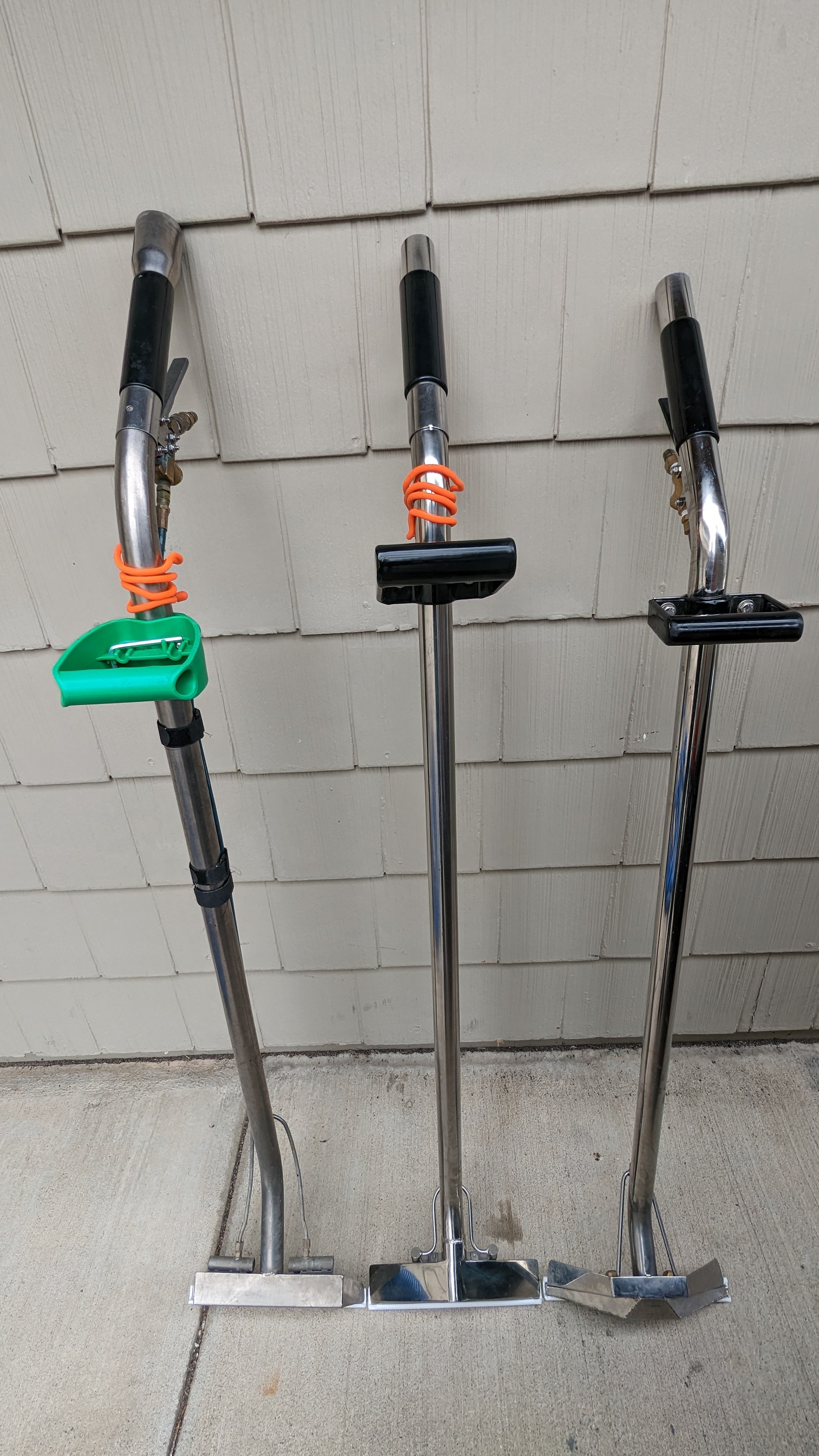

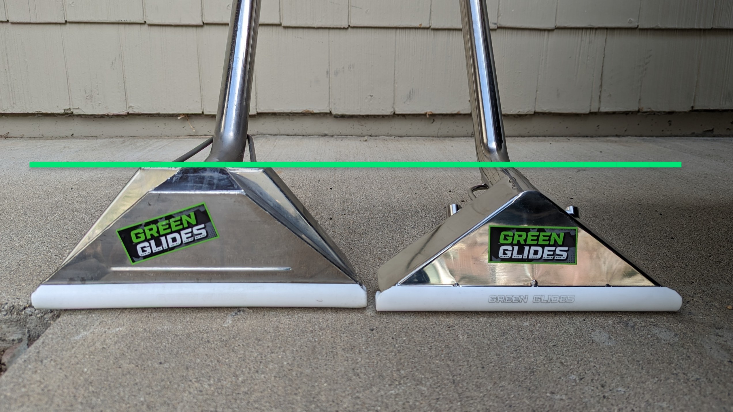

It performed flawlessly on a clean military carpet today.. I really want to drop it down to four flow and unfortunately has quarter inch Veejets.
No overspray but just that typical drip drip off the wings that every wand has.
Hopefully the empty residential I have tomorrow is dirtier and a Berber
116,972
I like the shape but the jet spacing looks a little off. Very wide gap in the center. Looks like it could use a third jet.
I didn't see an issue today in fact there's a bit of overlap right there and as you know the spray is always the strongest on the ends with v-jets but if this was a problem they would have addressed it at least 15 years ago when this thing first came out
I'll take a look at my Westpak versions of the AW29 tomorrow and see how it compares. Keep it in mind for tomorrow's job and see if you notice anything. Hopefully, it's a good dirty job.

Keep in mind, the jets are 1/4" higher than the GG/AW

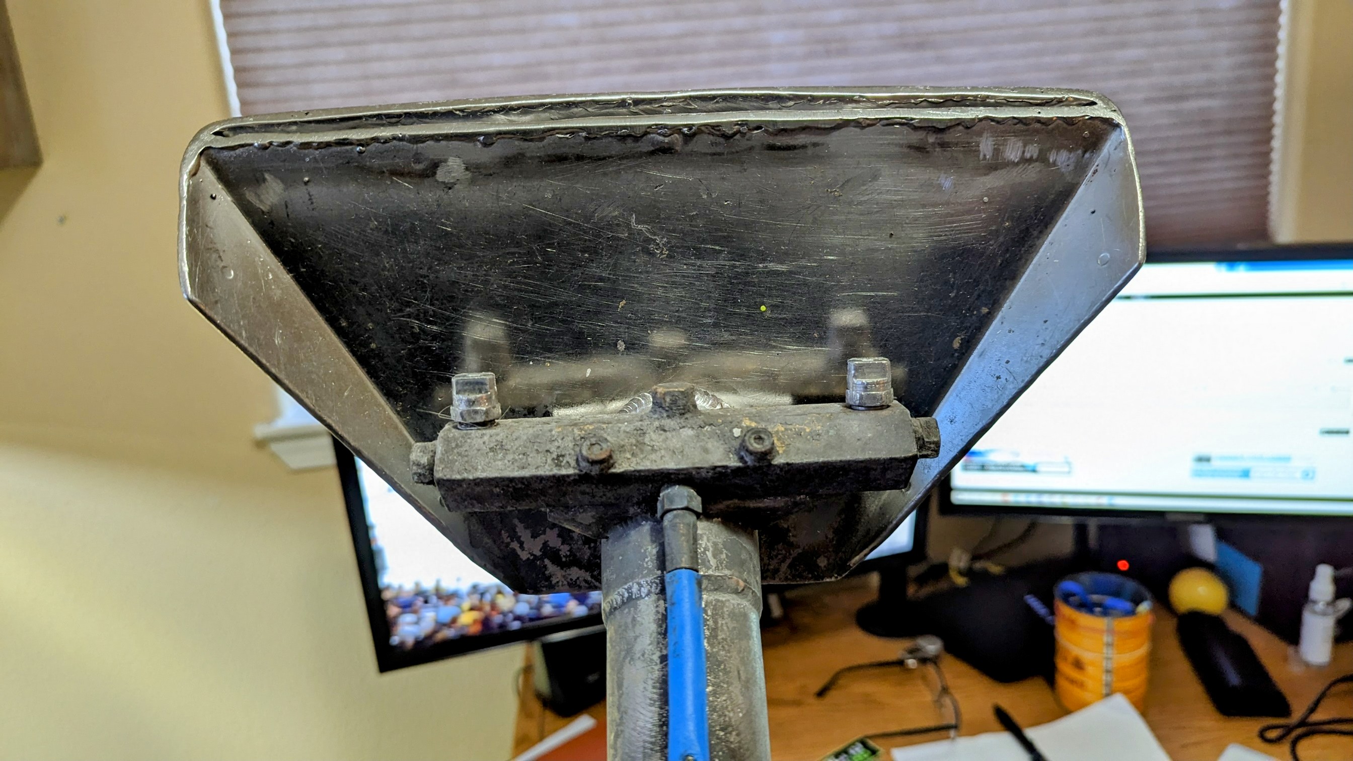

so, its kinda like my trusty Prochem Trijet but just with two jets?
Funny you should bring that up ..
My Tri Jet had the center jet removed back in 1942.
12.2 pounds compared to the 530's 7.9 pounds.
oddly enough, the jets are 95's...
