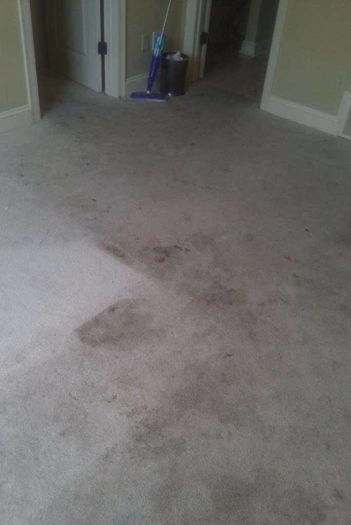

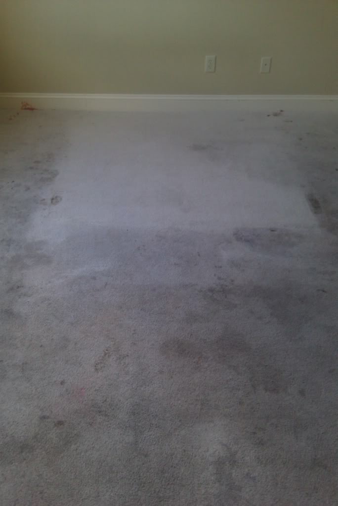

I have never seen anything like this before
Sep 7, 2008
3,797
This house rents for 4k per month and the people live like this. WTF?
The guy told me it was bad on the phone and I said no problem we can deep clean it.
I get there and had to double the price. I quoted him 200 to clean three and a hall empty for the extra deep clean.
I told him 400 or we would have to walk. He left and I had my doubts about doing the job. First the guy was driving a pos car, second he was adamant that I get every stain out which I said would not be possible, and third I honestly felt the job was worth 500-600 as it was and next time I will know not to do it for the 400.

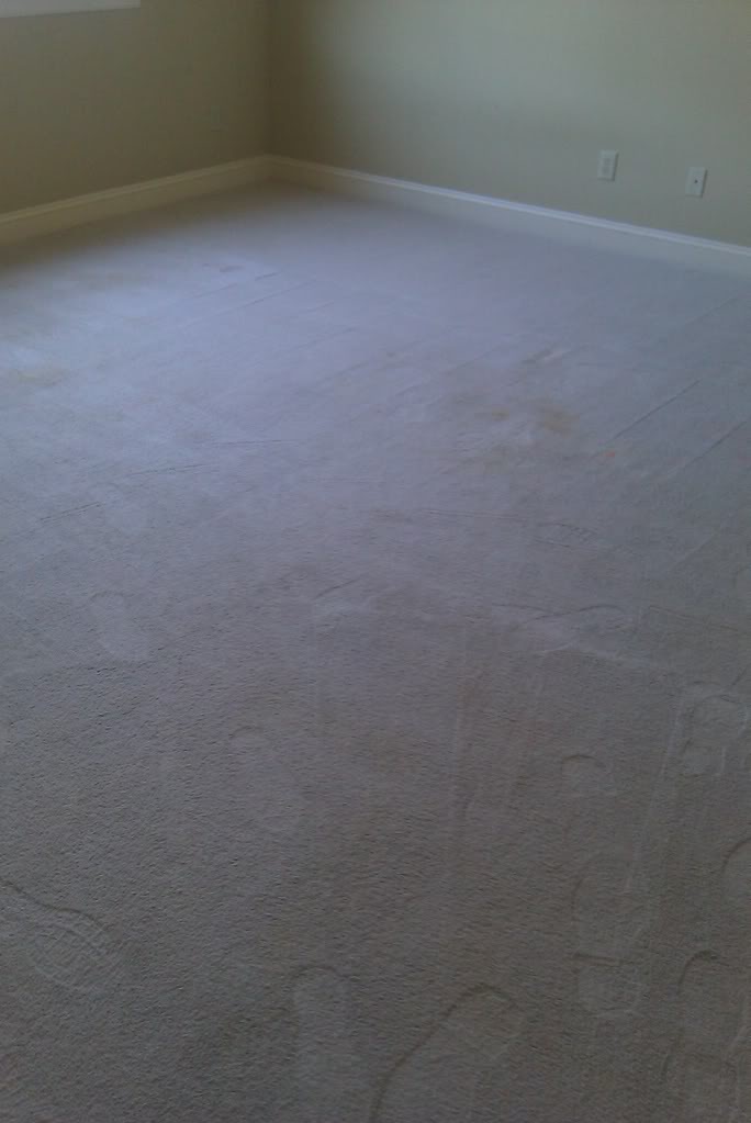

So before actually doing the job I changed my mind and just knew I should walk. Well we did it and it looked good but not perfect. The guy was happy and I got paid, but definitely a lot of work for 400.

Well these people weren't cleaning anything and probably never ran a vacuum once in two years.
Those are the jobs the separate the carpet cleaners ....from just cleaners.....

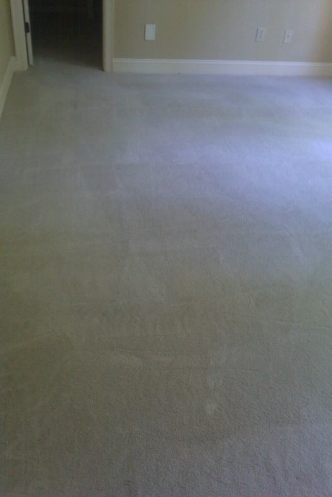

Not perfect but decent.

Wow, that's bad!!!

damn zoom your video shots out....and point up a little more...gives me a headache with it bouncing like that....
And damn that was nasty...not to bad considering....

Nice work on the pig hole. I had to deal with the same thing this afternoon at 2nd stop. Gotta love repeats that live like that.
