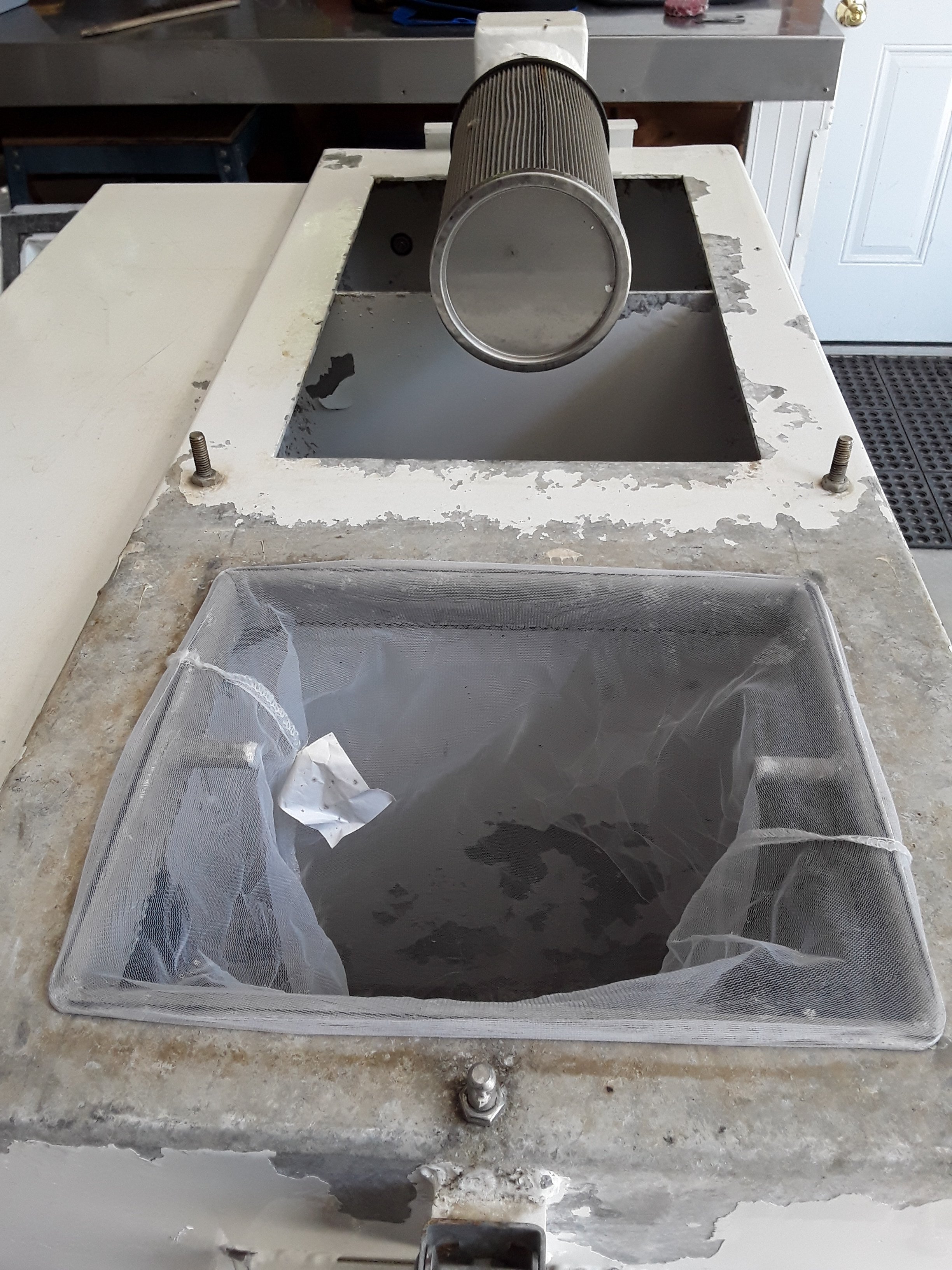

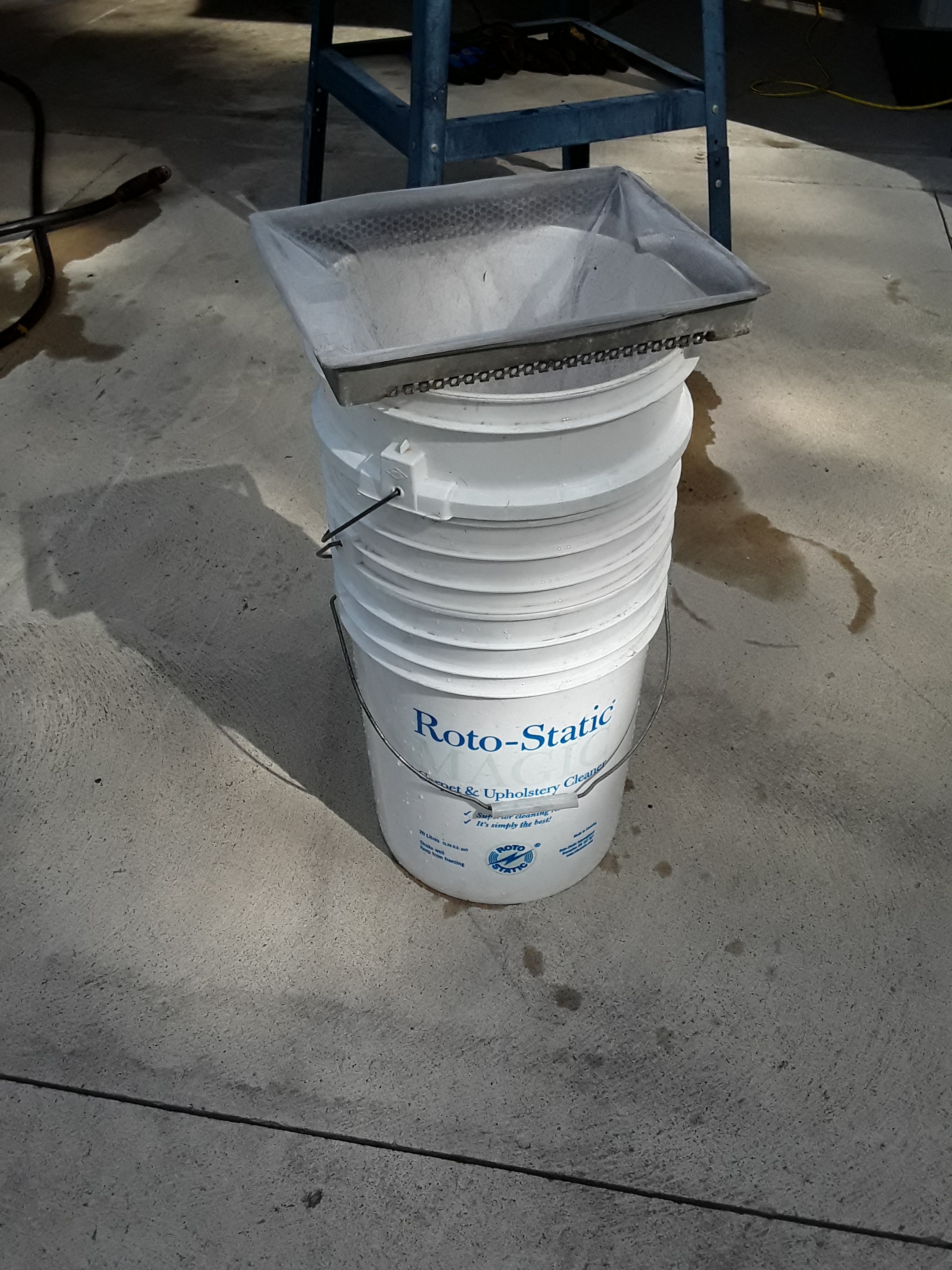

Here is my capture system for one of my AquaTech units.
20180901_105009.jpg 20180706_094900.jpg 20180707_100224.jpg 20180608_160434.jpg 20180608_160434.jpg 20180608_160300.jpg

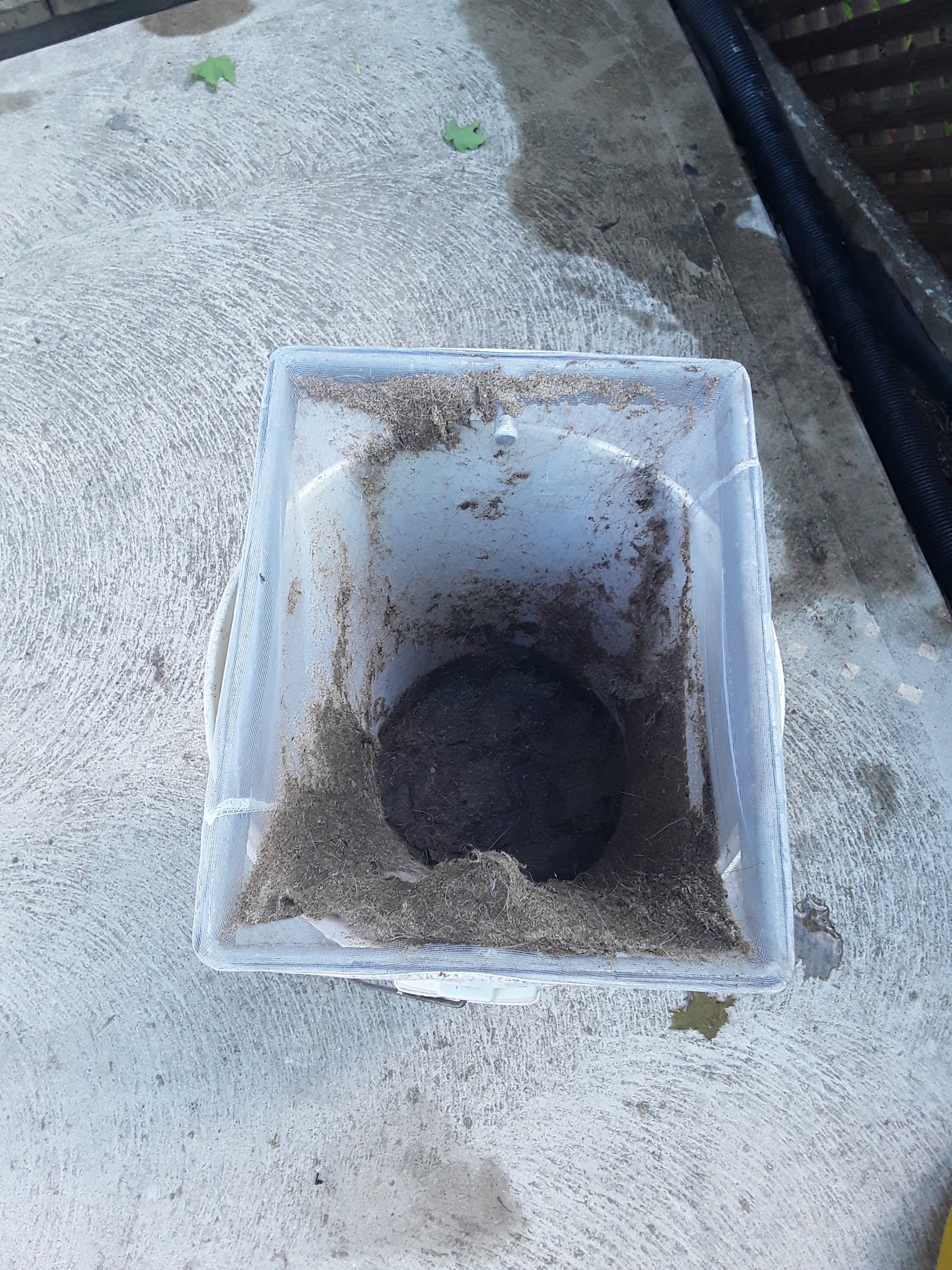

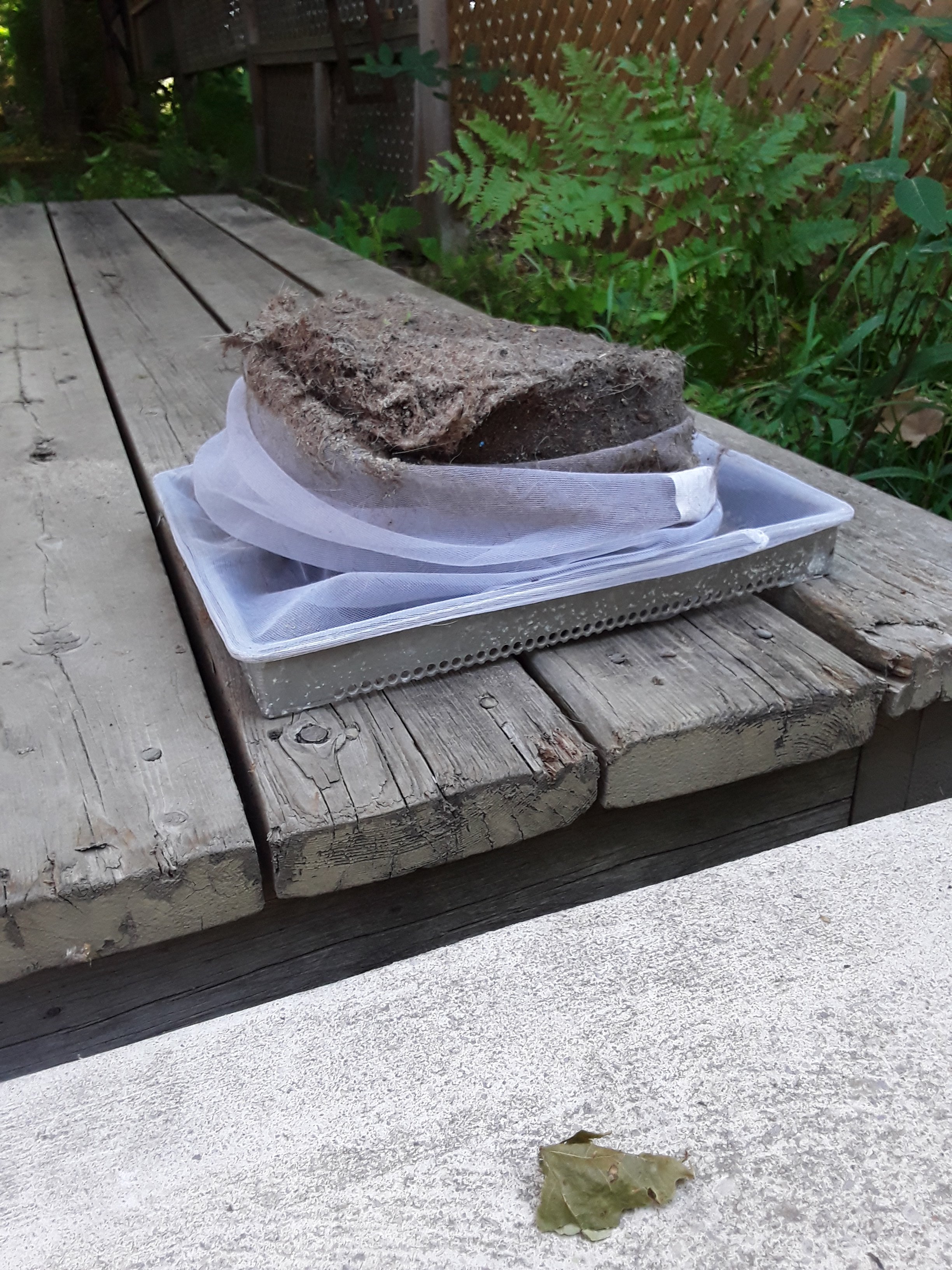

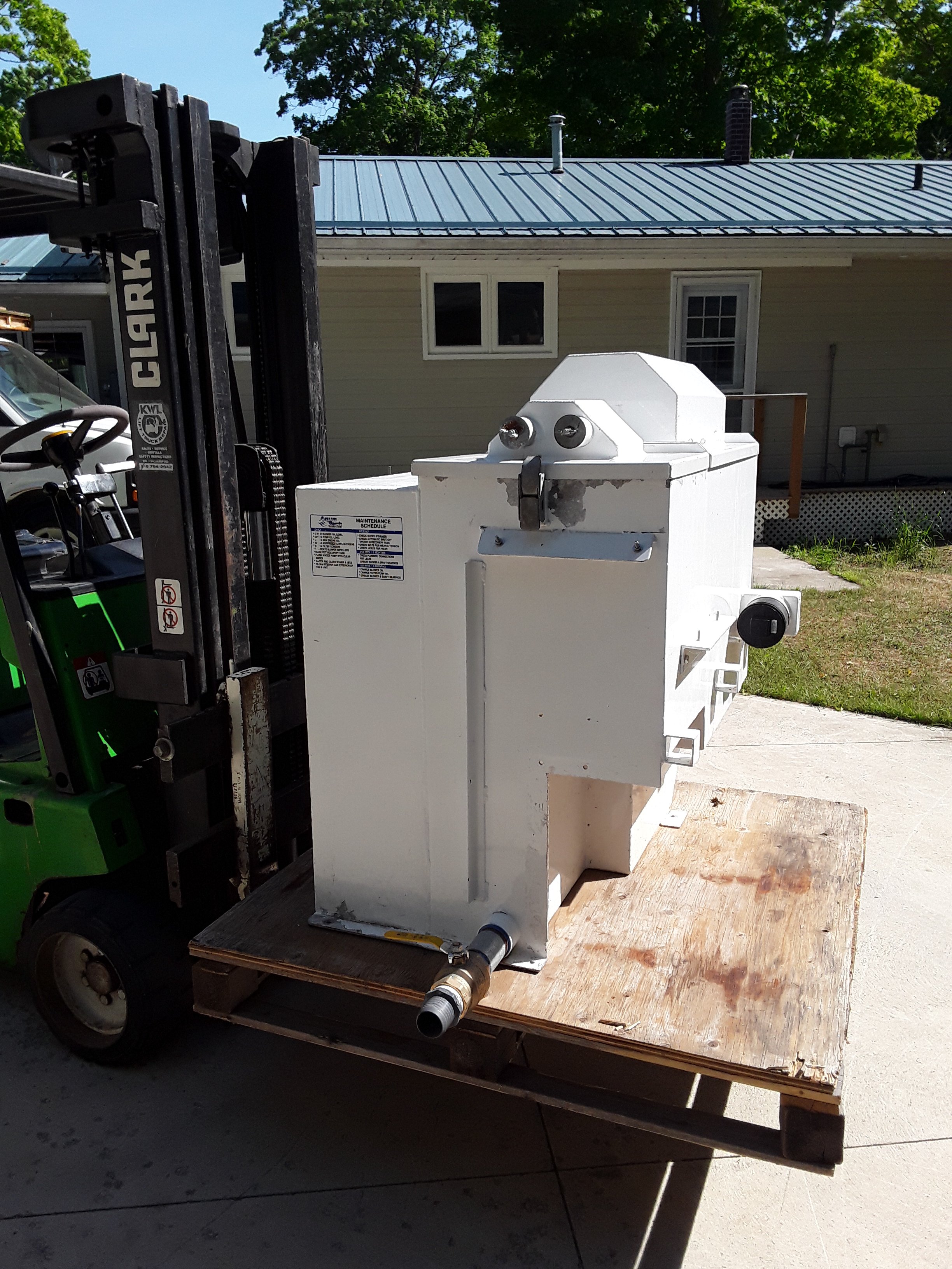

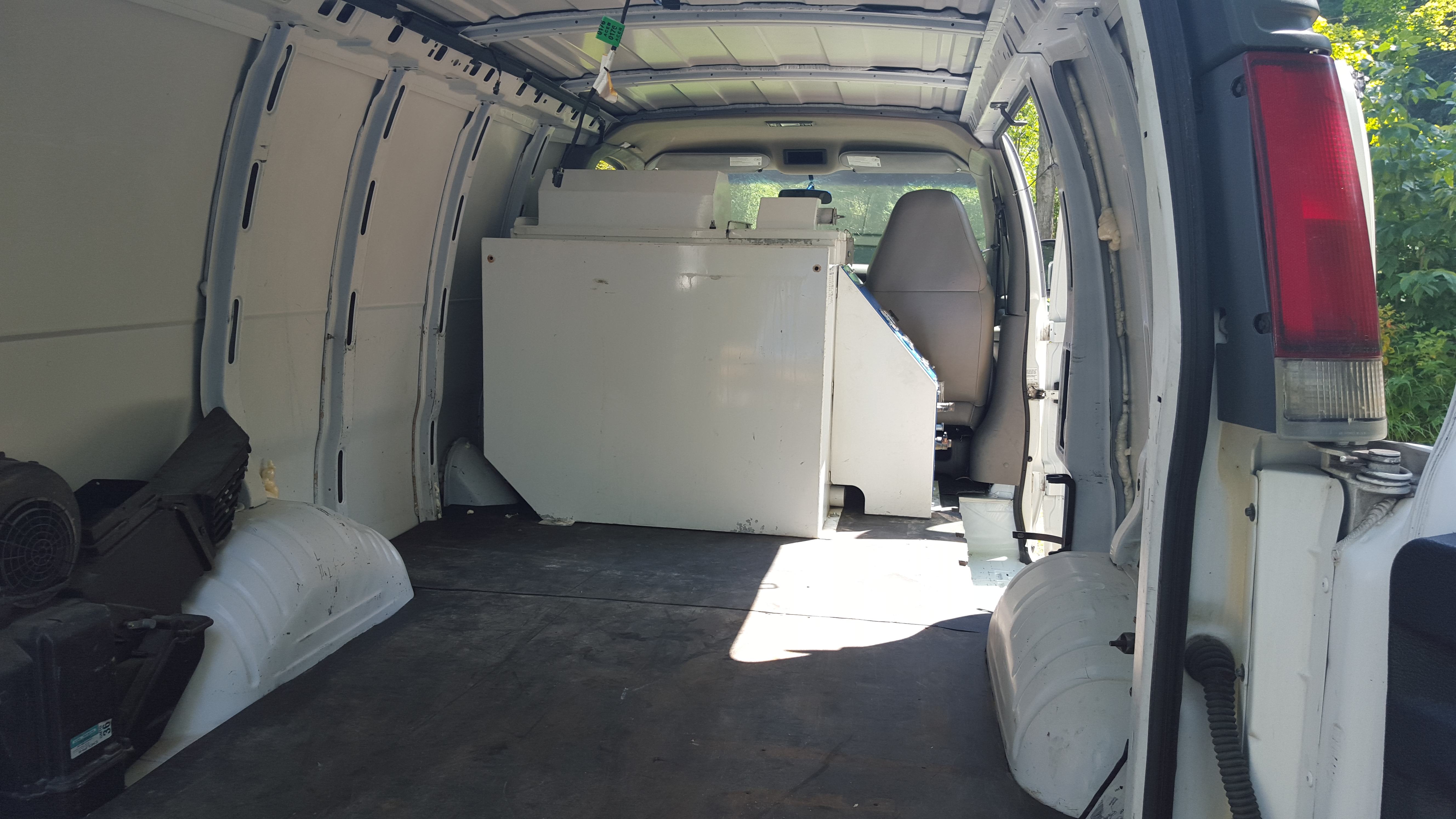

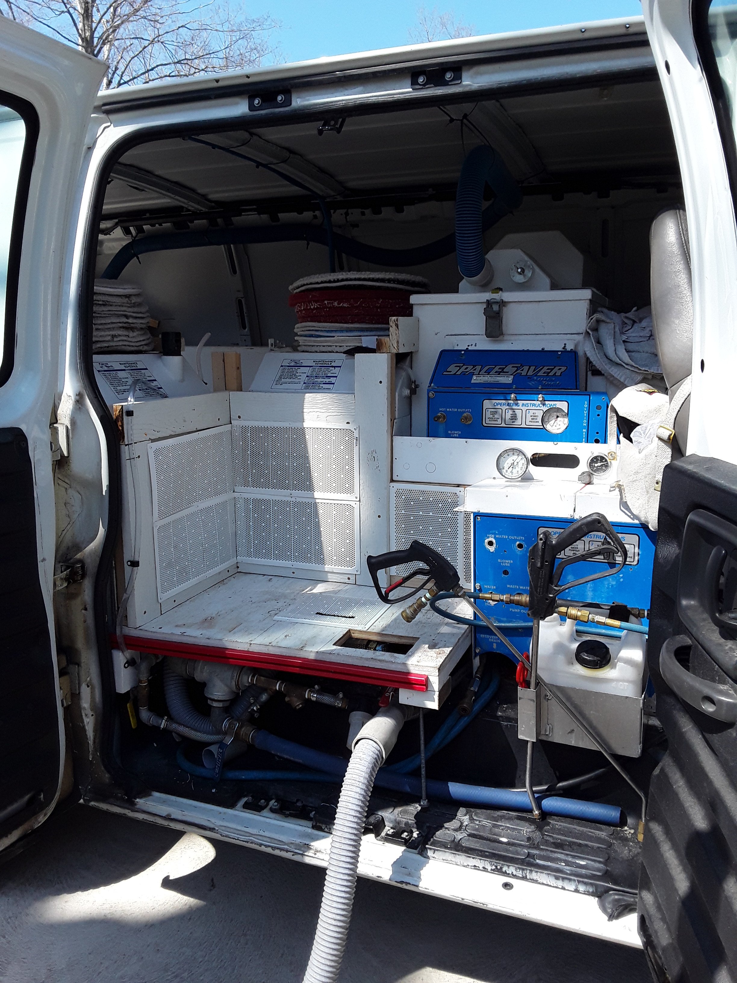

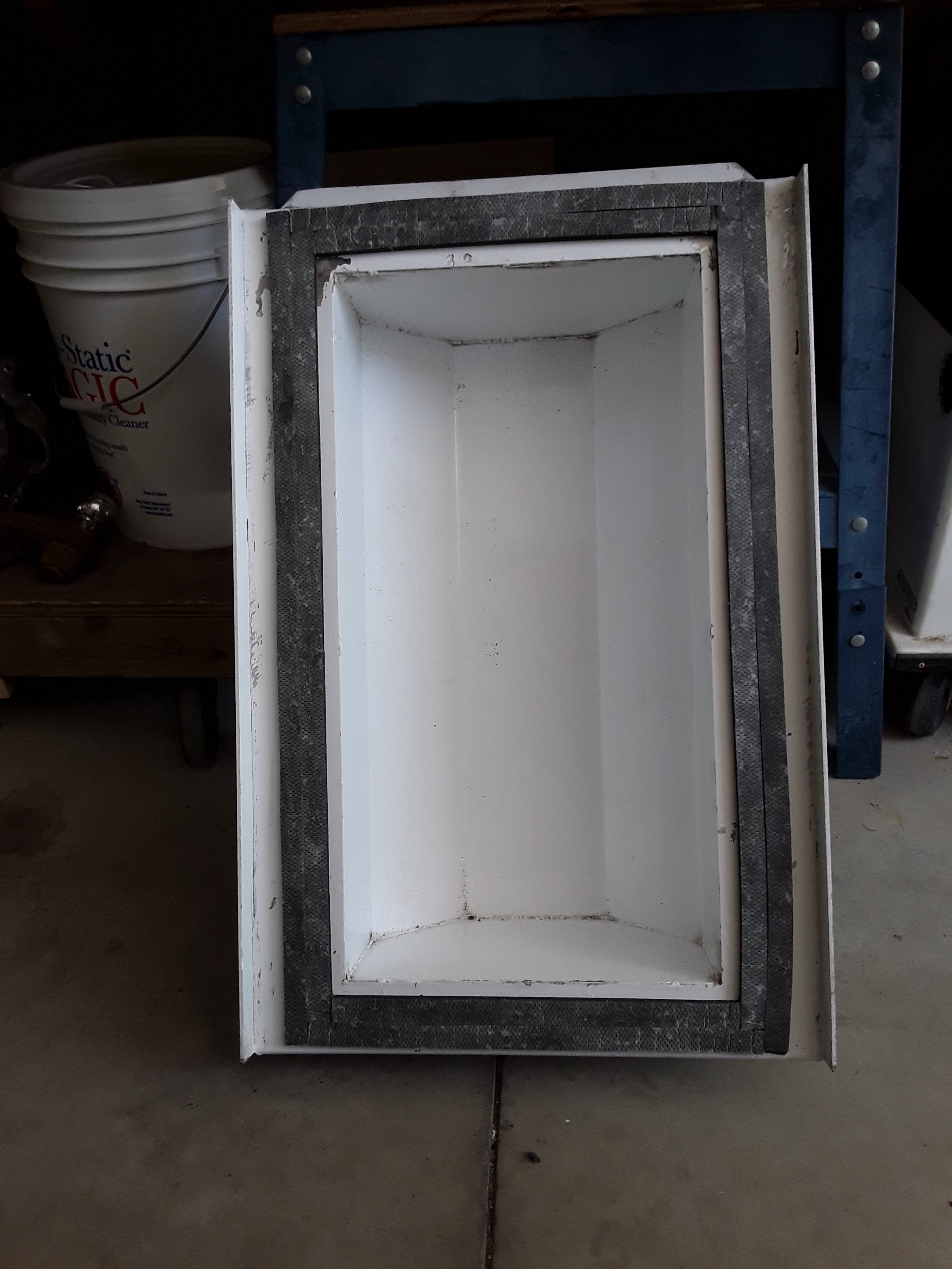

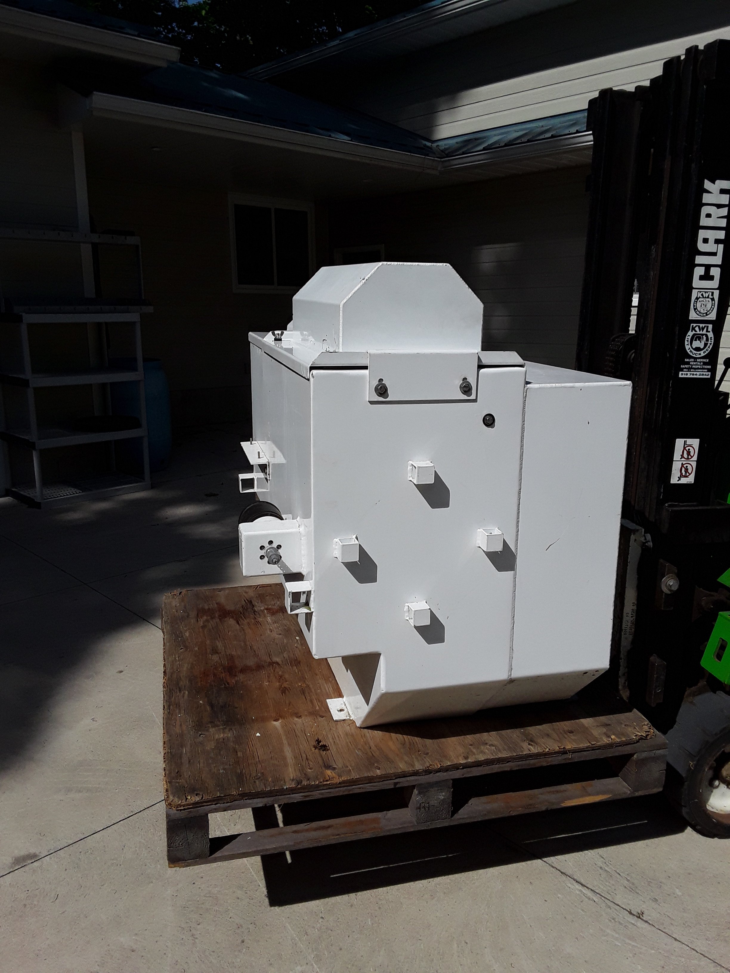

Haha! This is a 210 all day vac tank that came with a unit I purchased. It is being installed into my daily driver to replace the 100 gallon tank presently in my AquaTech.
The modified filter basket with 5 gallon paint strainer bag really turns these tanks into deep breathers! I laid in all new gaskets on lids using premium gasket material used on truck toppers.
I dissected the stock waste basket to accept the paint filters by cutting off the bottom 2/3rds of the aluminium material and taking 1/4" of the top lip off all the way around. Paint filters fit perfectly and are a cinch to change out.
The same mods could probably be done to the Cleanco vac tanks, although I haven'the checked them out closely.
20180508_111019.jpg 20150816_145751.jpg 20150816_145934_001.jpg 20180723_104209(1).jpg

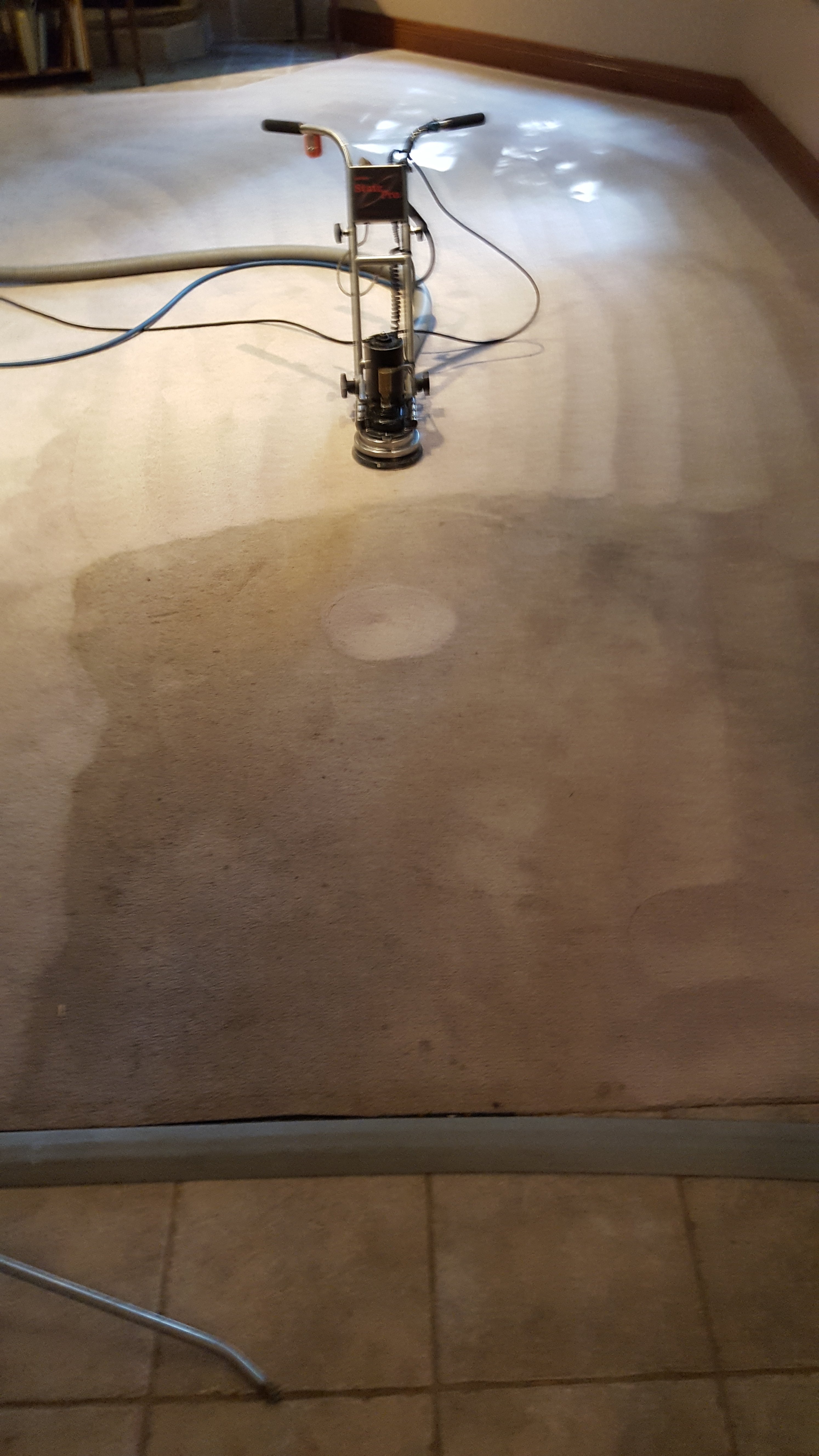

But... BUt....BUTT......why is yor machine and hose on the CLEAN side..
You are cleaning BACKWARDS......as well as more than a few do here......
WASS UP WIT DAT?
And unless yor Peter Pan or the tooth fairy
..yor walking on the cleaned carpet!

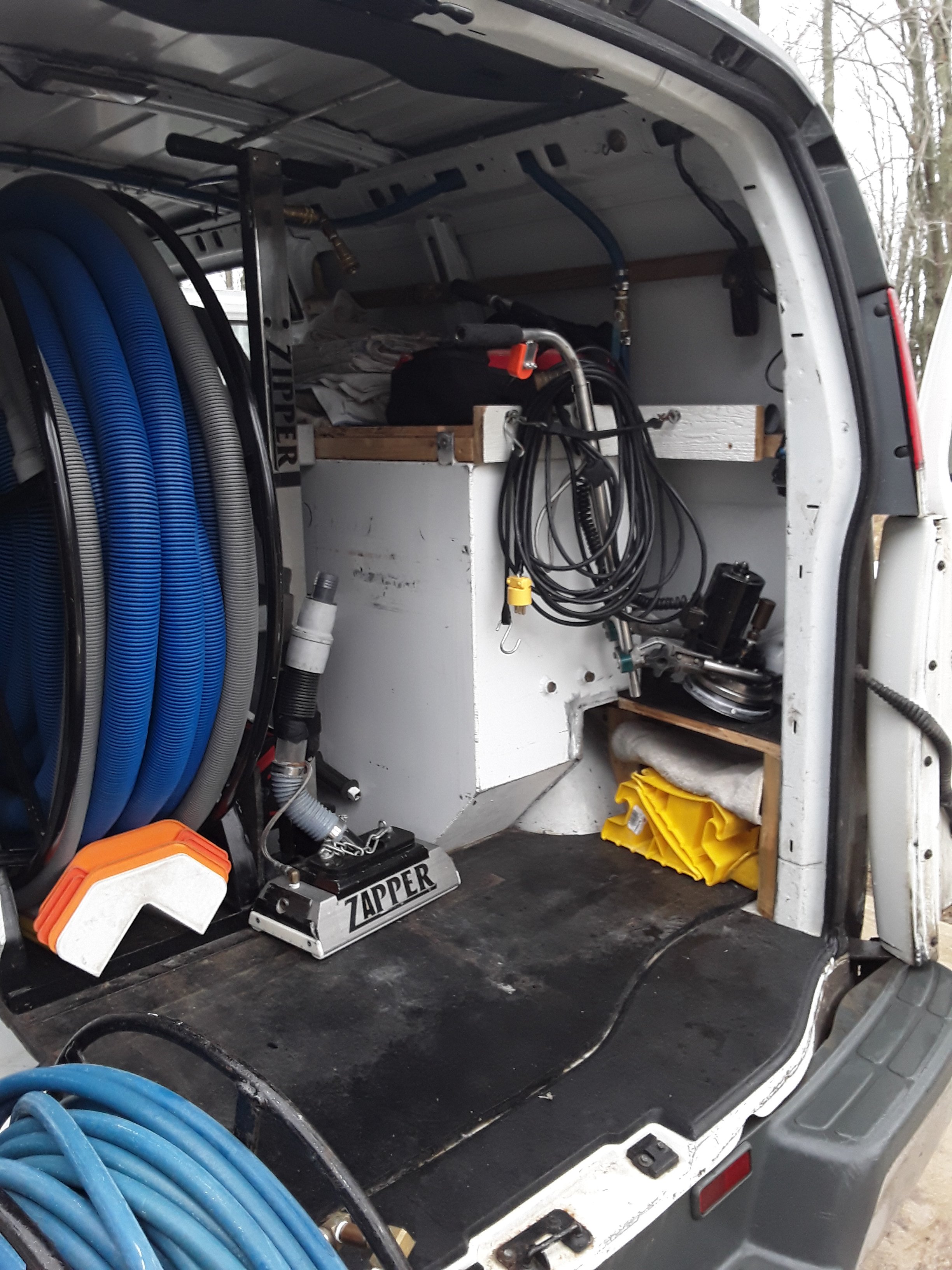

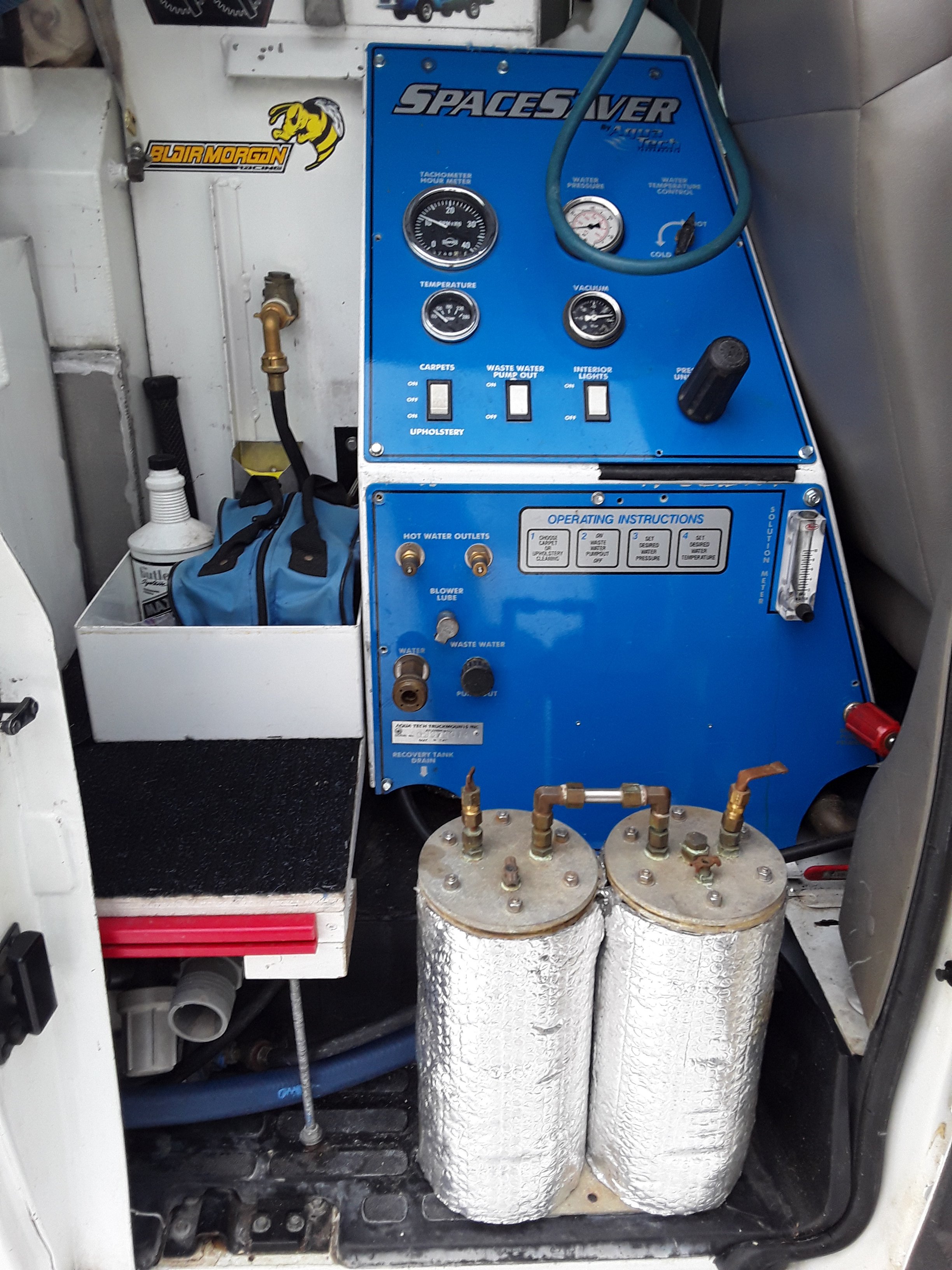

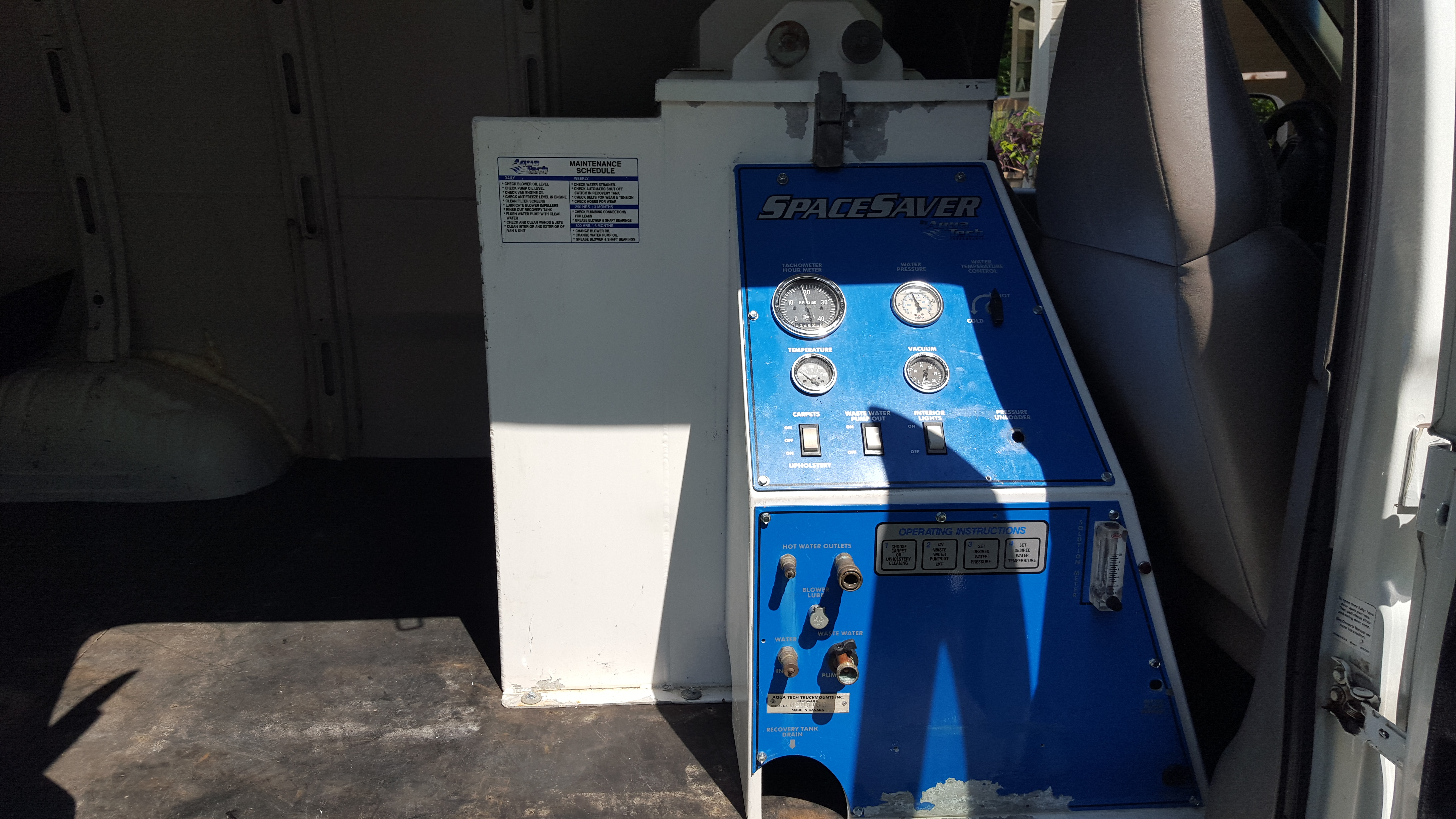

1st place in the almost vintage modified class of AquaTechs for 2018. 2019 version in the works. I am swapping out the 100 gallon waste tank for the 210 all day tank this winter.
Both HP and vac hoses run out of the back doors Bawb. Valves seen below are the waste clean-out and fresh water supply/drain.
The grey hose is for vac tank emptying.
20181228_110502.jpg 20181228_110704.jpg 20190104_112818.jpg 20181228_110615.jpg
