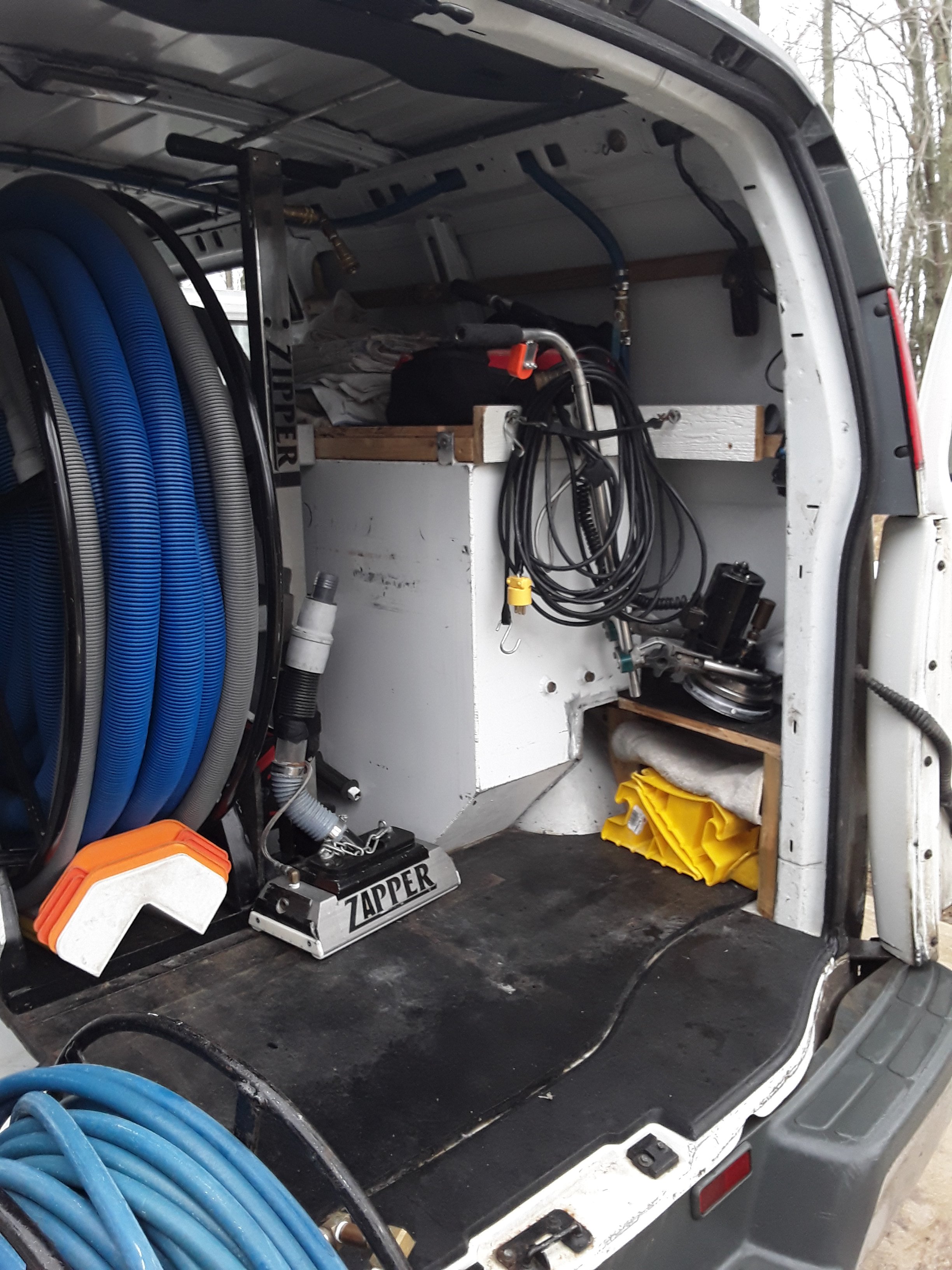

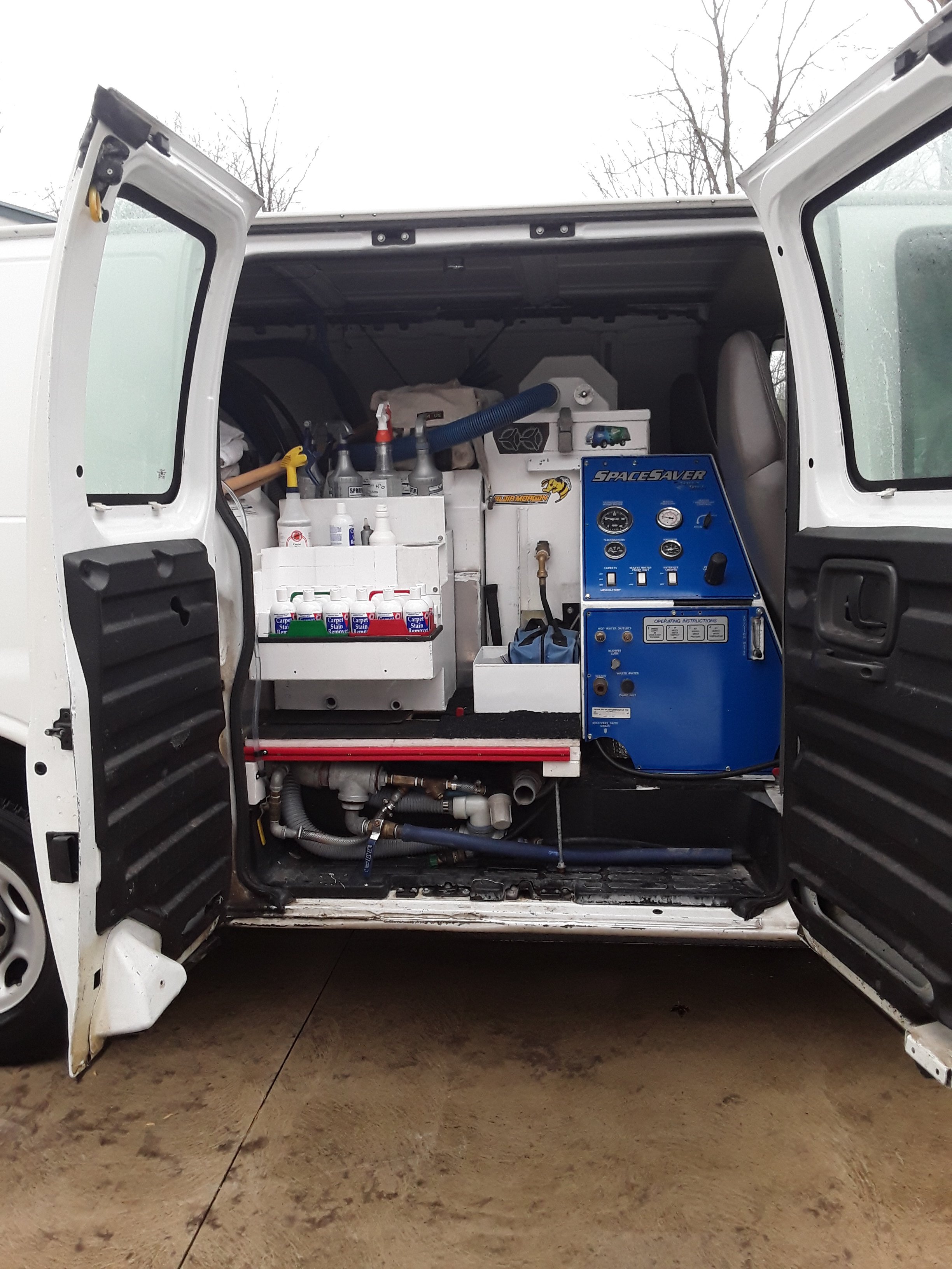

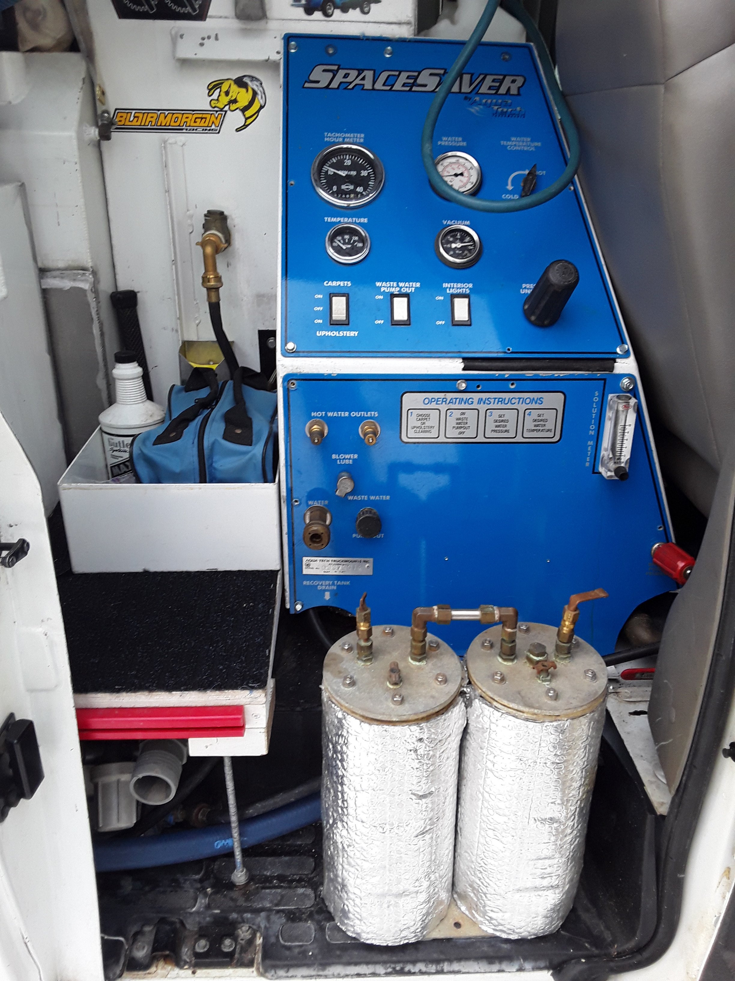

1st place in the almost vintage modified class of AquaTechs for 2018. 2019 version in the works. I am swapping out the 100 gallon waste tank for the 210 all day tank this winter.
Both HP and vac hoses run out of the back doors Bawb. Valves seen below are the waste clean-out and fresh water supply/drain.
The grey hose is for vac tank emptying.

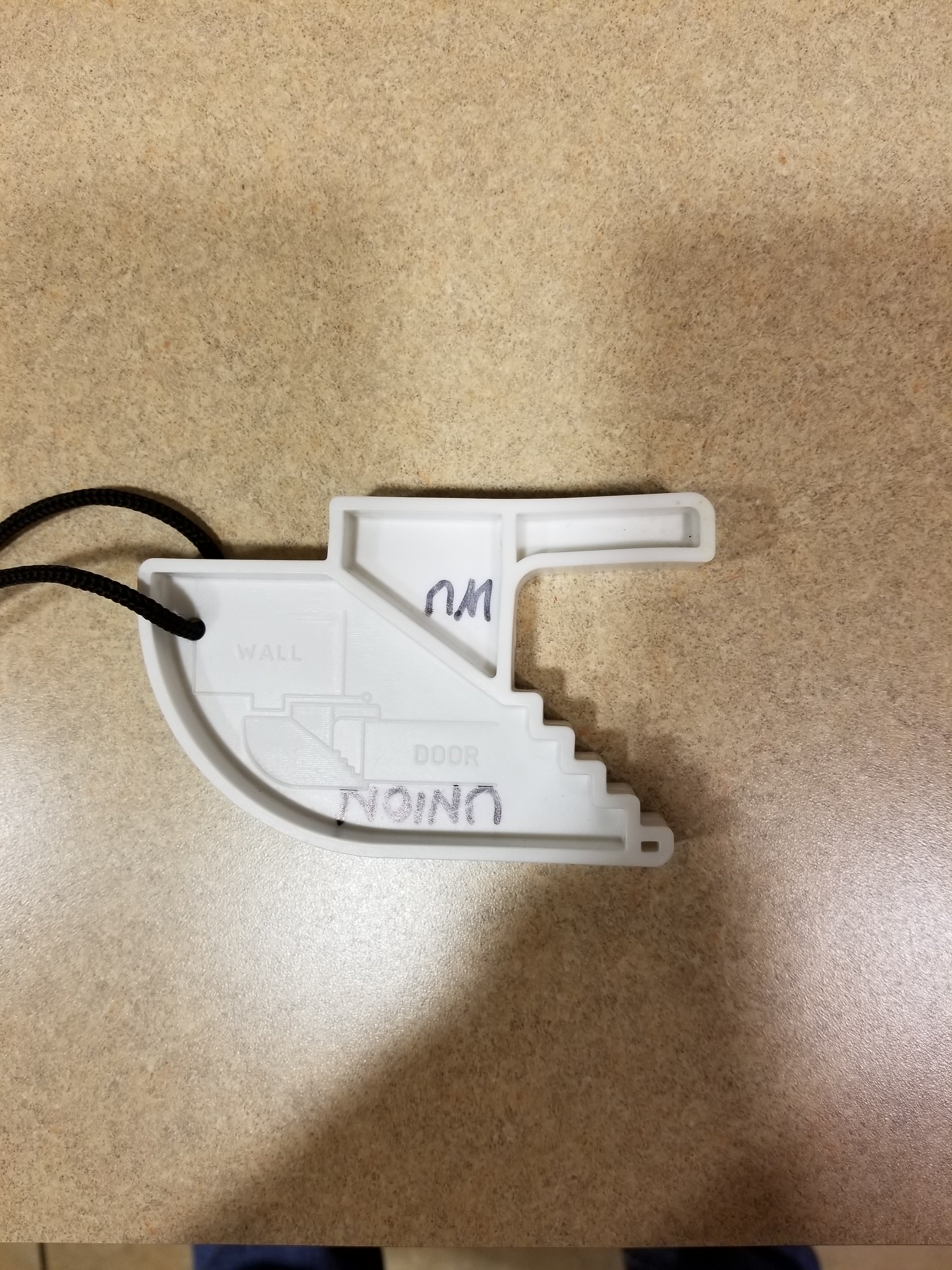

Are those yellow door stops ??? were did u get them please
These are the best ones I've ever used. Kaivac sells them.

til some knucklehead pushes on a wood 'n jamb door the wrong way and rips a hinge loose :eekk:
Haven't had it happen between the two buildings YET. Larry would it snap the plastic first or pull the hinge?
If I send you one can make a video of it damaging your door. For instructional purposes...of course. šŸ˜‰

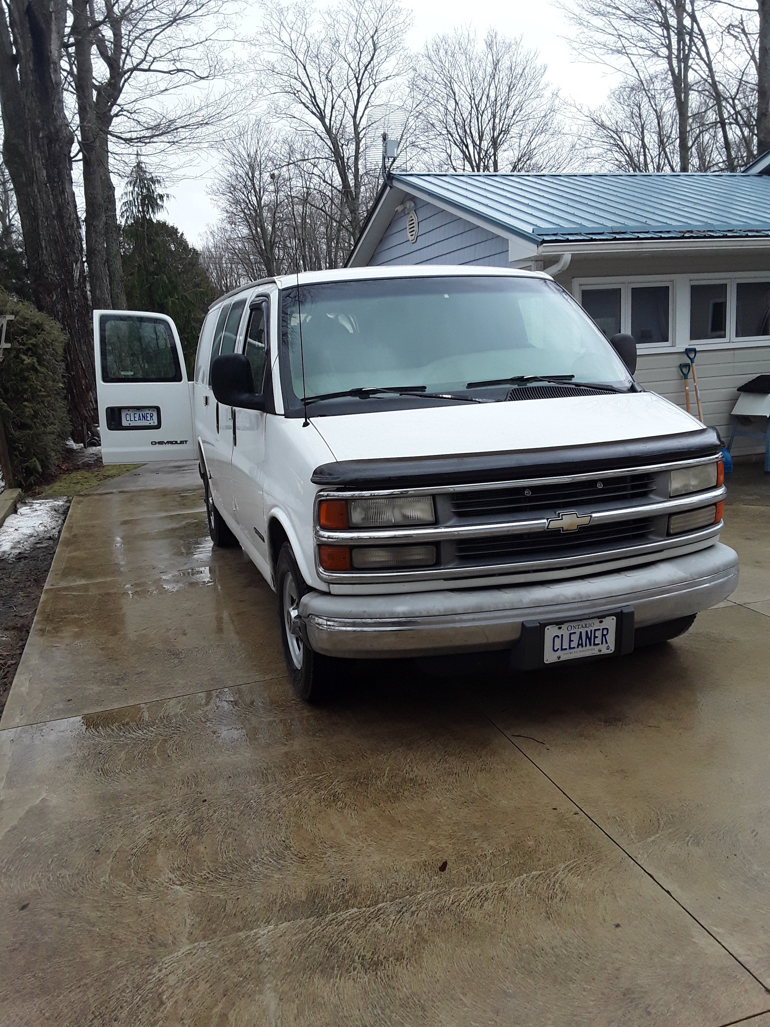

Hey, how do you like the steel roof(house)?
We need a new roof at some point. Steel might hide the waviness of this pos.

How long is the driveshaft.
And how many tubes in each HX

The metal roofing has worked out great.
Fred nailed it on the wheel chocks and door stoppers.
You can purchase the A in Zapper at he hardware store.
The heat x'RS are a Cleanco set.
The drives haft is a two piece design used on AquaTechs. The forward section attaches to the engine, the intermediate shaft has a u-joint and sliding feature that connects to the blower/water pump base unit.
